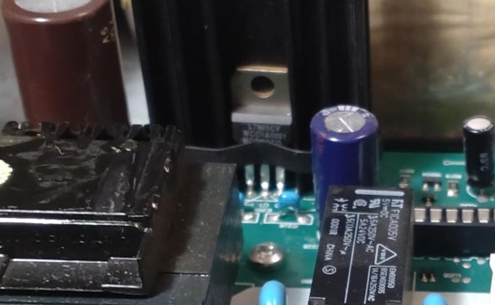

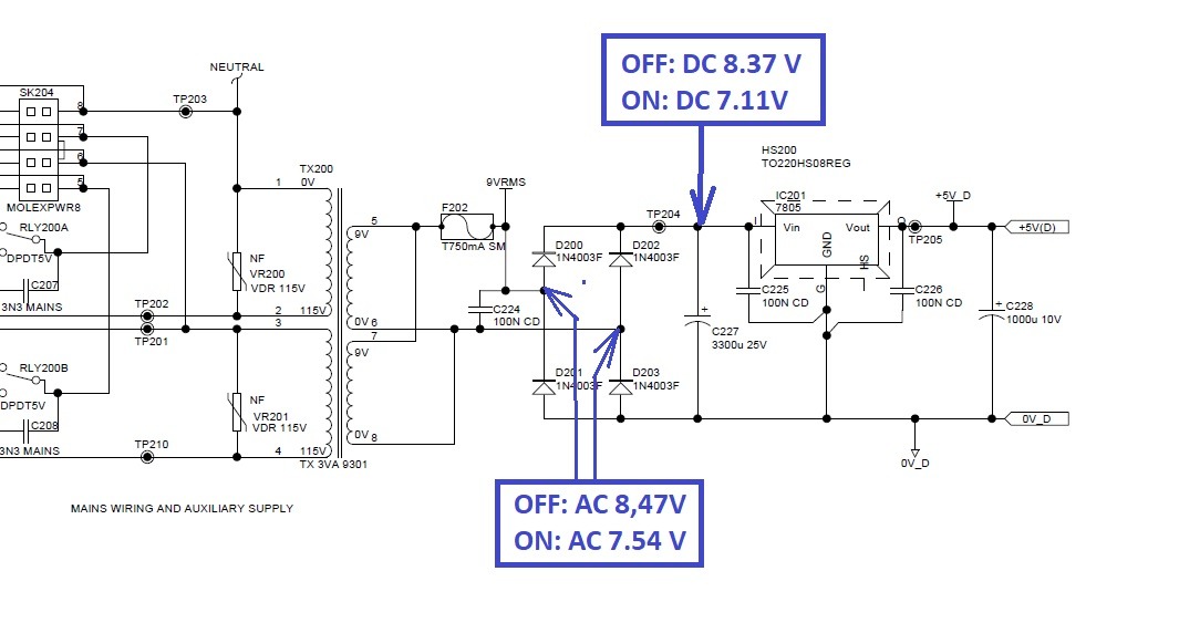

Where is that?On the graetz rectifier. + , - points
You should measure across C227.
And you are correct - the measurement results do not make sense.
Measure on the voltage regulator legs (IGO), these are also reachable.On the diodes legs,

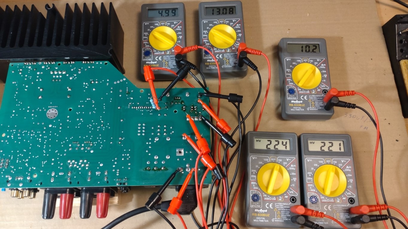

I meassured too, no change.
The 5v is present.
This is Your amp? What You meassure?
How many ohms is the secondary coil connected in parallel?
The 5v is present.
Good, stop worrying about the input voltage (unless the regulator or transformer is overheating) 🙂The 5v is present.
Actually belongs to a friend of mine and unfortunately has "left the table" some weeks ago. Gave also all paperwork with measurement results together with it.This is Your amp? What You meassure?
