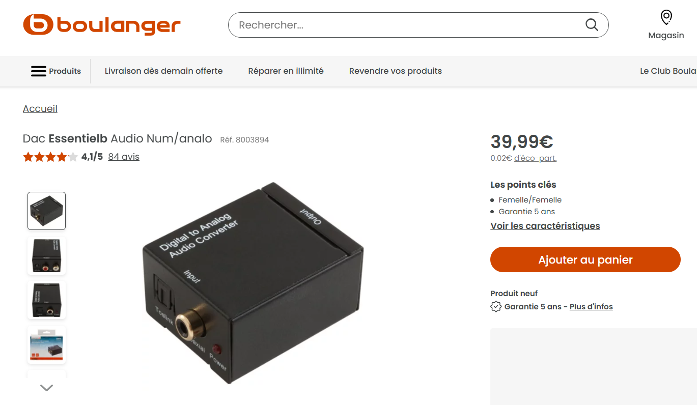

I have this one, and it is as basic as cheap as simply perfect for me :
I plan to integrate one in my next tube preamplifier console project...
