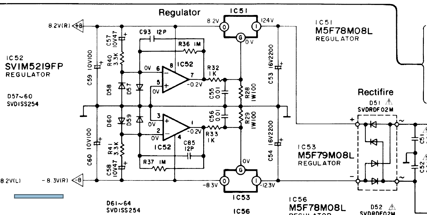

I am attaching one schematic just to explain what i have in mind ... more or less

I think you read too much of the "esoteric audio" press instead of good engineering books.

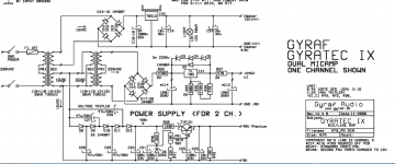

There's really high end audio equipment using op-amps in regulators of all sorts.You can't use them easily in high voltage regulators, but there are a lot of good engineers who don't give a damn on what Conrad Johnson said...By the way...in the late 70's and early 80's there weren't many op-amps on the market, if any...now we have high voltage op-amps too...IC regulators have some op-amps inside...you can use external op-amps too. I used TL783c with valve preamplifiers with no problem:

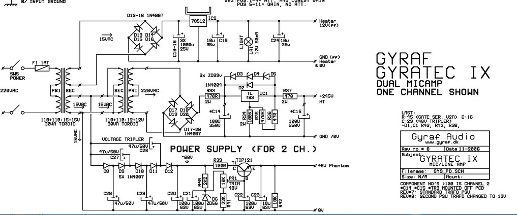

Gyraf Audio - G9 DIY

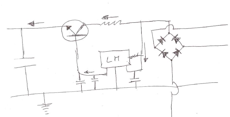

Instead i was thinking to something different but of course i do not know how to do it That is using a IC regulator as a voltage reference and leave the transistor to provide the ripple filtering. Can IC regulators be better voltage reference than zener ?Summary: low noise voltage regulator achieved using twelve electronic components, one of which is an integrated circuit

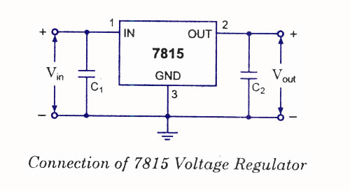

https://www.circuitstoday.com/wp-content/uploads/2009/10/7815-voltage-regulator.jpg
clearly more in more complex circuits they could be just fine

i would really like to stay away from tubes ... there are too many variables like tube qualityI used TL783c with valve preamplifiers with no problem:

i am attaching the schematic i have in mind to overcome the fact the zener diodes are not good voltage reference
The LM acts only as a voltage reference and drives the bjt base that actually provides voltage to the load
The LM is not providing voltage to the load at all

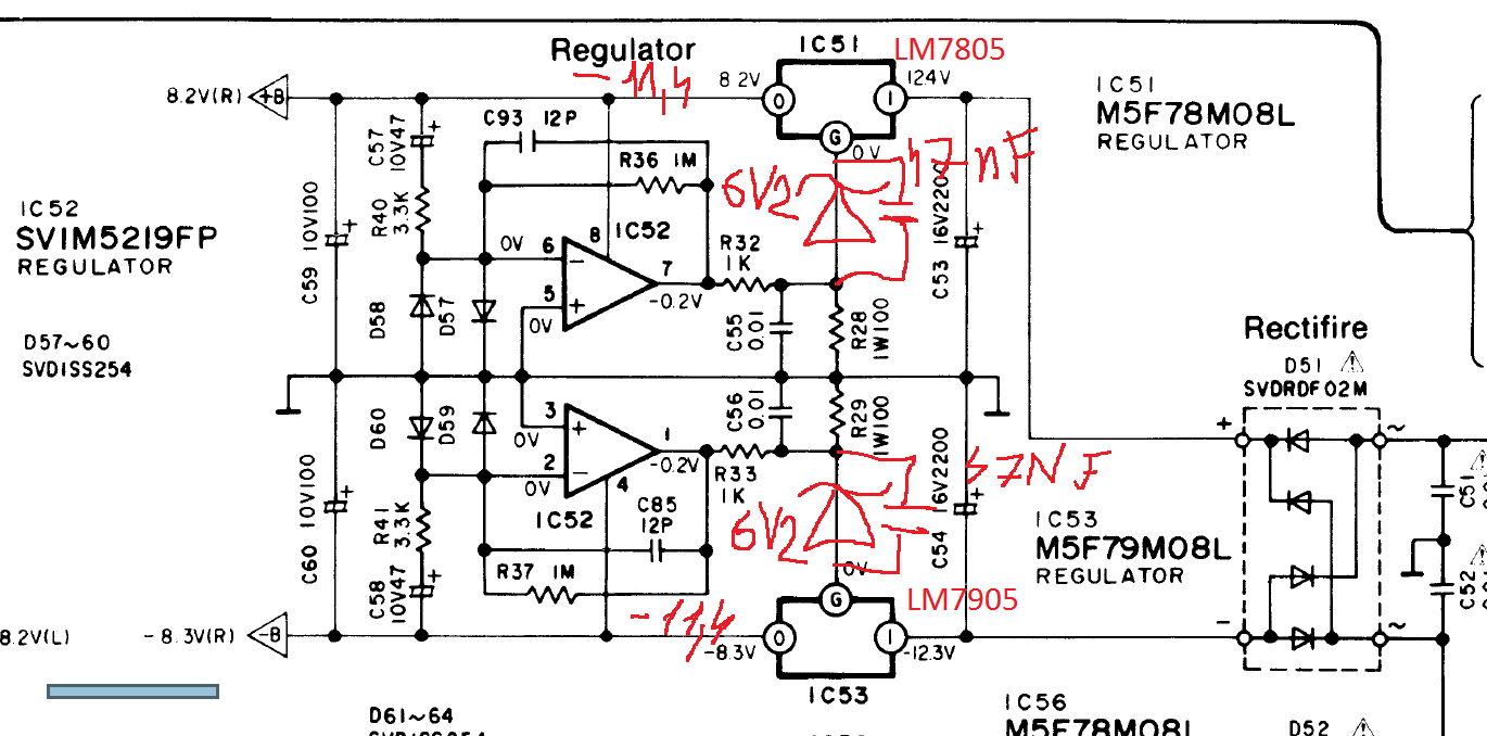

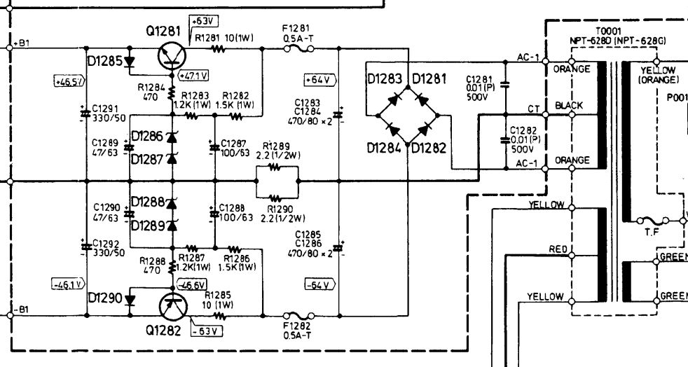

^ That's not a good way at all. You are throwing away the the regulation of the chip because the pass transistor is not within any feedback loop plus you are getting a slightly lower output voltage than the chip alone. You also need a higher overhead for the circuit to work properly.
Also some regulators need a minimum load current (particularly some negative ones).
With anything like this you need to define your own requirements first and then see if those requirements can be met with an off the shelf part or, whether you really do need to go further with a dedicated design to get the specification you want.

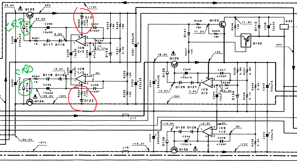

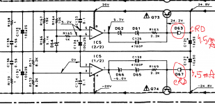

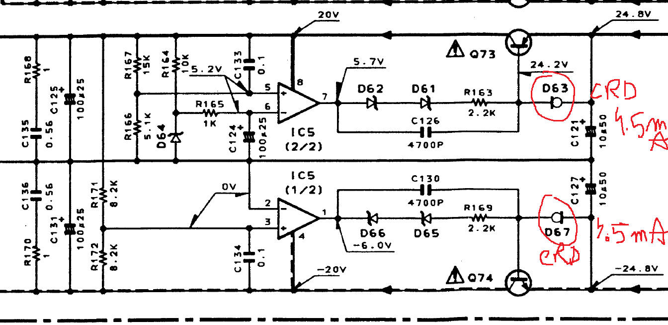

it is stated in the art of electronics that the 6.0v zener has zero tempco but if you look in some manufacturer's datasheet you see that the 5.1v is the ov tempco...As far as I always knew, since I was a sixth form student back in 1985, Zener diodes are the foundation of voltage references. If you want more precision, supply a reference Zener diode through a constant current source and use a buffer amplifier to avoid loading it. One of the best, with regards to temperature stability, I remember, is a 6.8V Zener diode which has zero temperature coefficient.
anything between 5.1 and 6.2 will do the job.
they used CRD in the past for zener regulation:
https://www.datasheets360.com/pdf/5903155689177736882
