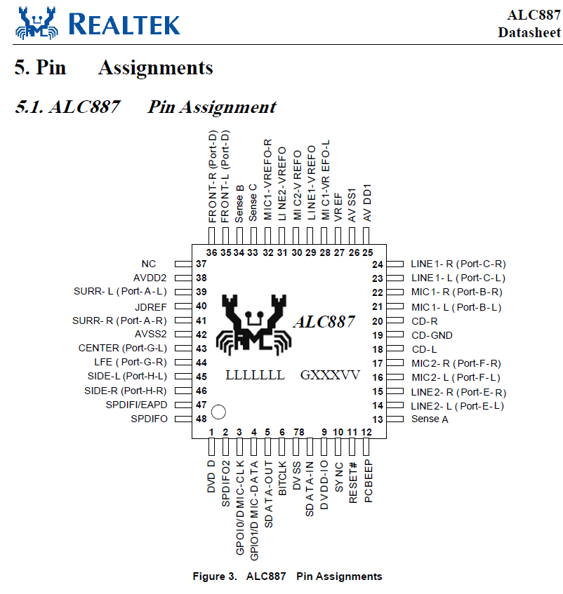

The motherboard has realtek ALC 887 codec chip, supporting spdif.
Haven't read the full specs yet, but I might try to get spdif ot of leg 42 (going through resistor divider and decoupling cap).

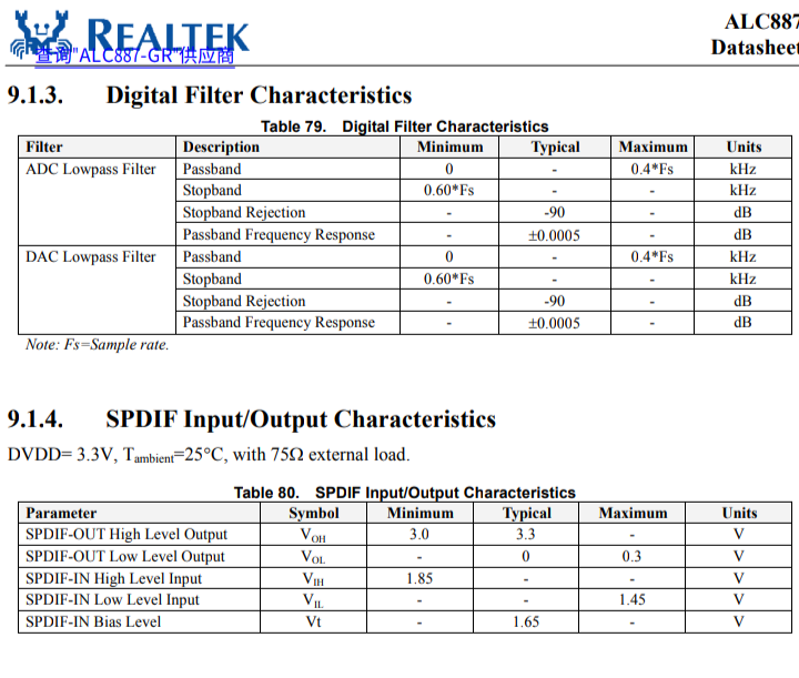

The output level for spdif coax is 0.5v, +-0.1v.

Code:
SPDIFO, pin 48, First SPDIF Output
Output has 12mA@75Ω driving capability
VOH=DVDD, VOL=DVSS

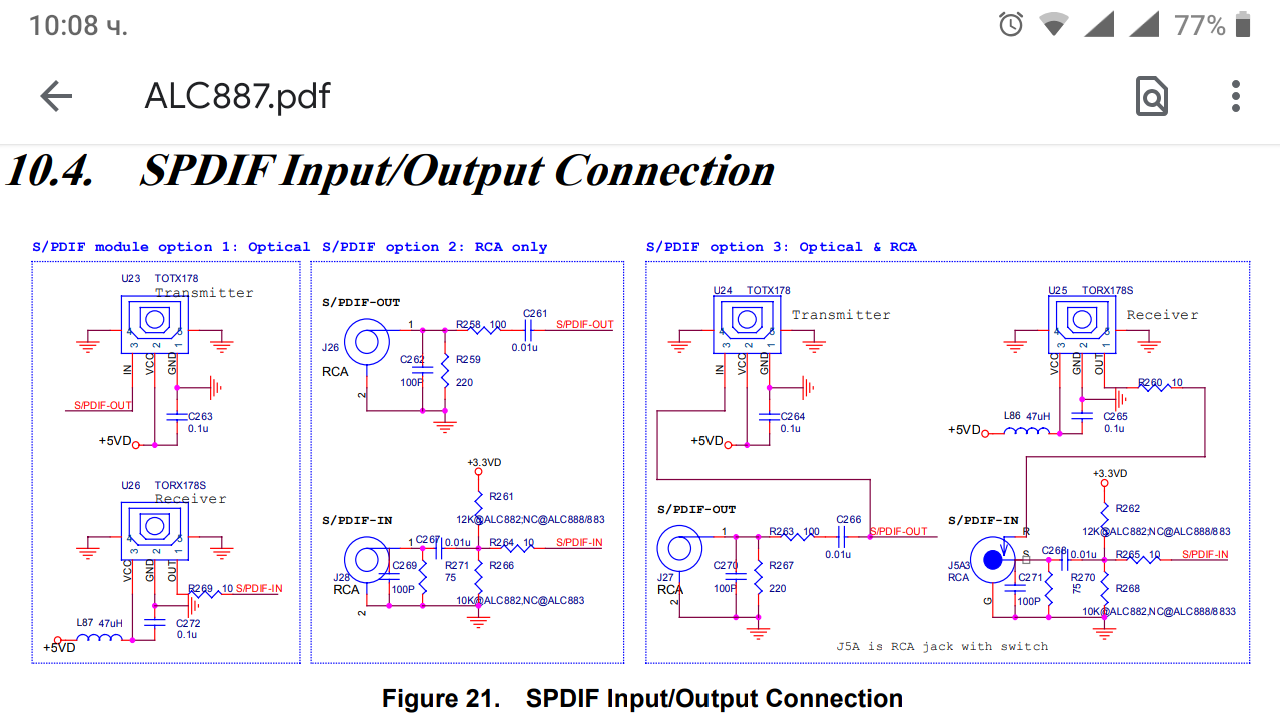

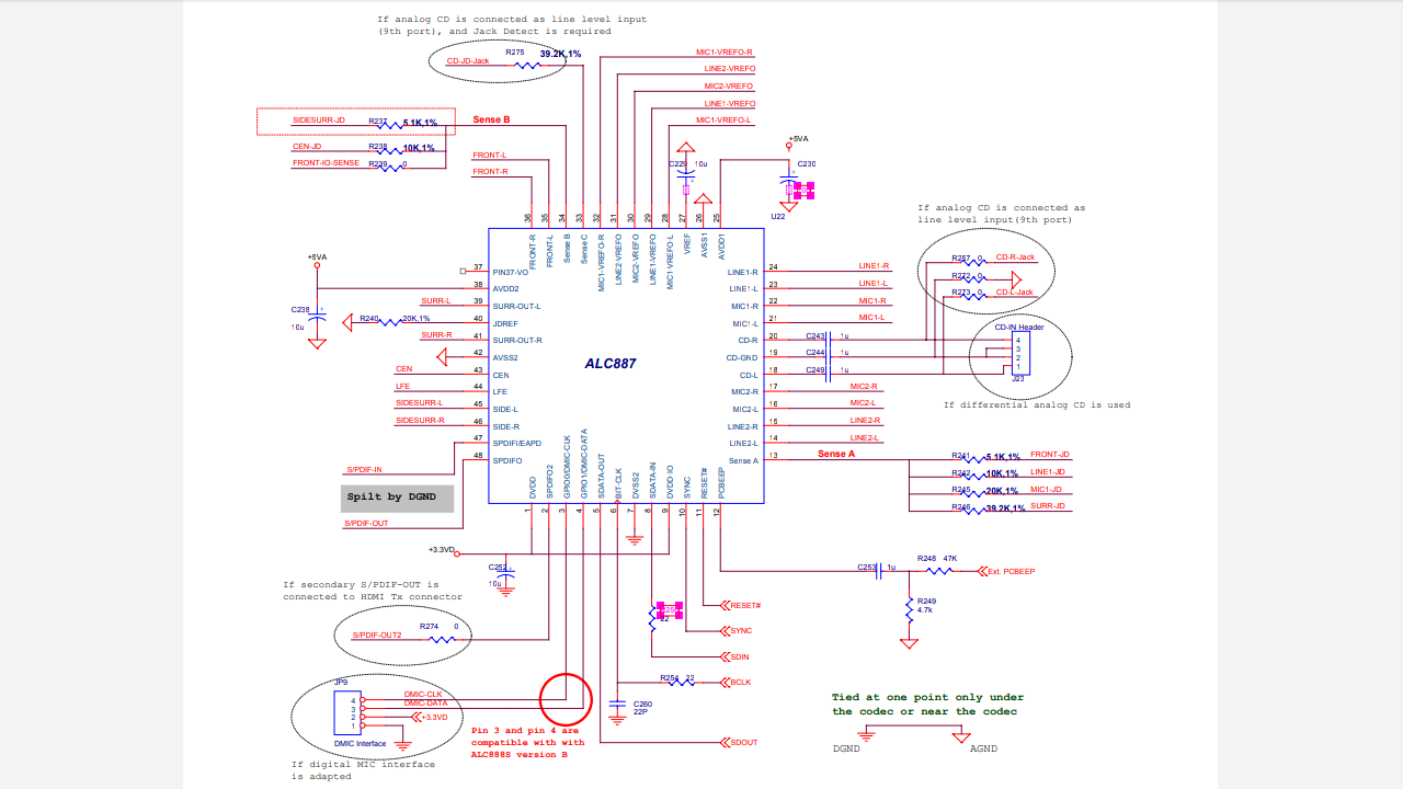

The output circuitry from the specs, attached.
There is a note about chip gnd/ dgnd layout. I gues it applies for the spdif out gnd as well....

I will fit a bnc connector, insulated from chassis.

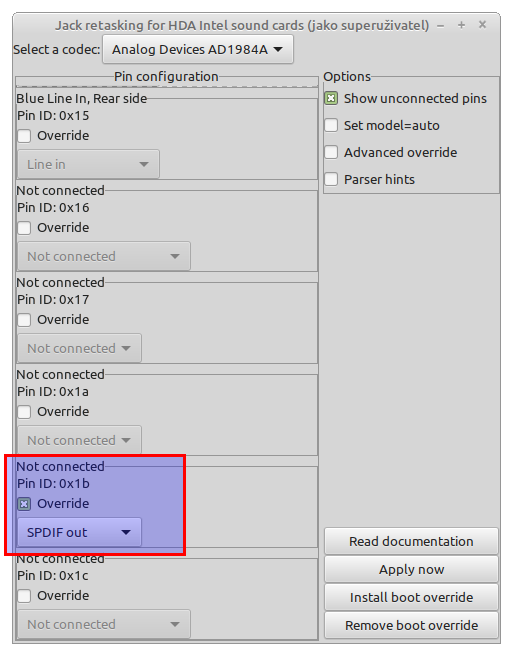

Intel HDA is a complex specification. Regular codecs do not have firmware inside, the driver configures them at initialization. Typically the initial configuration is burnt in bios where the generic Intel HDA driver reads it from.
I use linux because it gives me full access to my hardware. My board BIOS reported:
which the linux Intel HDA driver converted to:
Now I can reconfigure parameters/routes of the codec with utility hdajackretask [How To] Turn Headphone Jack to a Microphone Jack in Ubuntu - OMG! Ubuntu!
I have to enable "show unconnected pins" because my board does not output SPDIF by default. My Intel HDA codec is https://www.analog.com/media/en/technical-documentation/obsolete-data-sheets/AD1984.pdf . The SPDIF-OUT pin 48 is controlled by node ID 1b (page 16). So I retask the codec to enable this pin.
The log detects the change:
SPDIF output device hw:Intel,1 appears:
And corresponding SPDIF control elements for adjusting SPDIF stream preamble become available:
I see the SPDIF playback switch is off, I would enable it (e.g. in graphical alsamixer). Now the pin 48 of my codec would very likely output SPDIF signal if I played something to the linux alsa device hw:Intel,1. I will not solder a wire to that pin on my motherboard to hook an oscilloscope though 🙂
Windows may have a similar utility to hdajackretask but I very much doubt it.

Wow..
So probably the spdif pin does not output by the current motherboard defaults
After doing all that retask/ remap, u still have all factory settings hardcoded in bios?
And hda jack retask overrides settings at
/after the OS starts?
In general I dont want to switch OS. If the factory settings are hardcoded in bios and overriden via the linux os in runtime, have to look for windows hacks.

If your MB has no physical SPDIF output, your windows driver (also reading the defaults configured by the MB vendor into its bios tables) should not offer it. It would be confusing for users if it did. BTW bios HDA configs contain LOTS of bugs (that's why the linux driver (and thus likely the windows driver too) contains LOTS of hard-coded quirks for individual MB models) but that is a different story...
Yes, hdajackretask stores the changes into its linux filesystem and the snd-hda-intel driver loads these overriding values at linux boot. I doubt it is possible to overwrite the hardcoded values in bios so that your windows driver could load the changed config.
Well, good luck finding one 🙂 The generic Intel HDA driver written by MS would have to support re-configuration from a third-party software.I think there are similar tools that might do.
