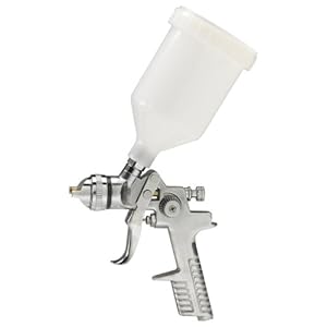

There are 2 basic kinds of spray paint guns.
Most common used by car paint shops are suction feed, you see the unencumbered gun it the painter's hand, one tube feeds it compressed air and a thinner one sucks paint from a paint tank, which may be in the floor or over a table.
Main air flux creates vacuum which sucks paint fron the tank.
Since you need relativcely high "mai" pressure, droplets re very thing, so it's better for smooth surface paint jobs, whichn are easier to polish, it's also quite economic, that's why it's the most popular one.
There are others which are gravity fed, so they need a (necessarily smaller) tank on top,
so paint can drop on its own weight (vacuum helps, but is not indispensable) , in general produce a somewhat coarser grain, use lower pressure, and it's easier to make a mess: if pressure drops (somebody trying to "help" steps on the air hose or it bends sharply) paint will continue to flow on its own, low pressure will not break it down into tiny droplets but will spatter in large drops all over the work surface, etc.
Get the picture? 😉
You first paint the background, let it dry/cure somewhat and then lower dramatically air pressure ... the gun will spit large drops all over the place.
Just practice first on something expendable, old wood leftovers.
Practice makes perfect.
Car underchassis protector guns,
or the ones to apply coarse finish to walls are *designed* to do that , but even a regular (thick nozzle) paint gun can do if you find the sweet spot ... just practice a little.
Why do I insist on having the background quite dry?
Because if it's still wet, it will partly dissolve and absorb decorative drops, remember paints in general consider "self leveling" to be a virtue.
Another option is to get a shop which builds/repairs fiberglass boats or pickup truck covers or rolling homes to spray it with "naval" polyester resin of various thicknesses, they are used to it.
They even specialize on a rough surface splattered 3 colour scheme: white background, then large grey drops, then small black ones, popular for boat insides.
Ask them, they'll know what you are talking about, of course ask for black background instead.
Get the picture? 😉
