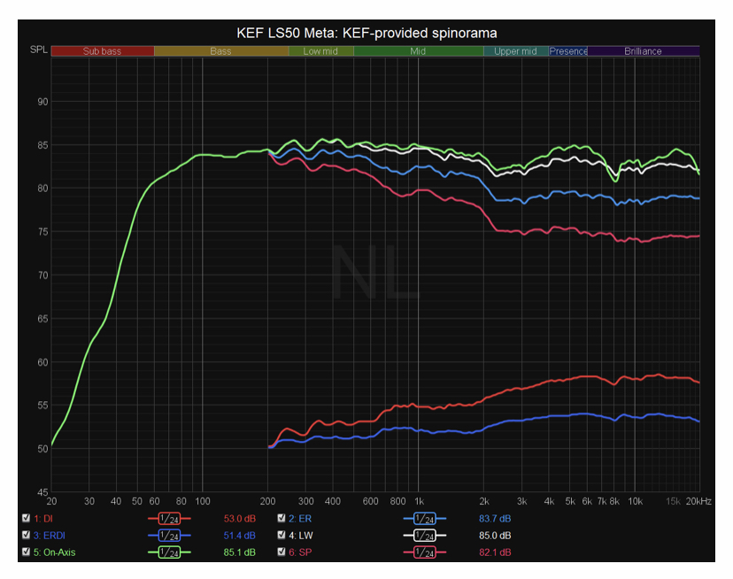

KEF’s own spinorama does indeed look very good for directivity:
