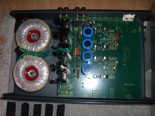

I own an Atoll AM100 amplifier (built around 2004), with which I am very satisfied. Yesterday I must have come to the speaker output while handling the ground cable of the phono amplifier. After that there was a loud noise from the loudspeaker and then there was silence.
The LED is still on and the relay is energized, but no sound comes out. The transistor in front of the relay gets very hot. The rest stays cold. What could have been broken?
Can the power stage transistors IRFP150 or IRFP9140N be broken? How can I measure this?

yes, no sound at all. No music playing when it shortend. I touched the positive output of the left channel.
.....have a look at the fuses, are these ok?
can you measure the offset voltage at the outputs of the amp?
It seems very strange to me that only 4mA quiescent current is mentioned in the instructions - go to the attachment. 100-150mA are usual with these MOSFETs. Maybe a very special front end was developed. But according the attached file with only the component side of universal PCB the schematic is similar to those from page 10 underGood afternoon,

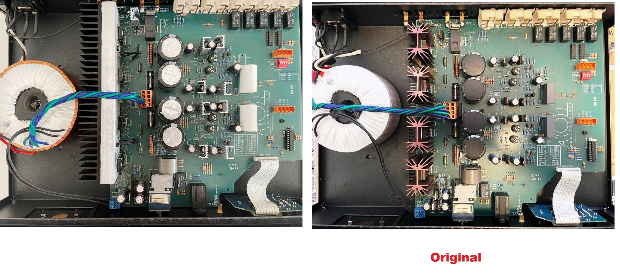

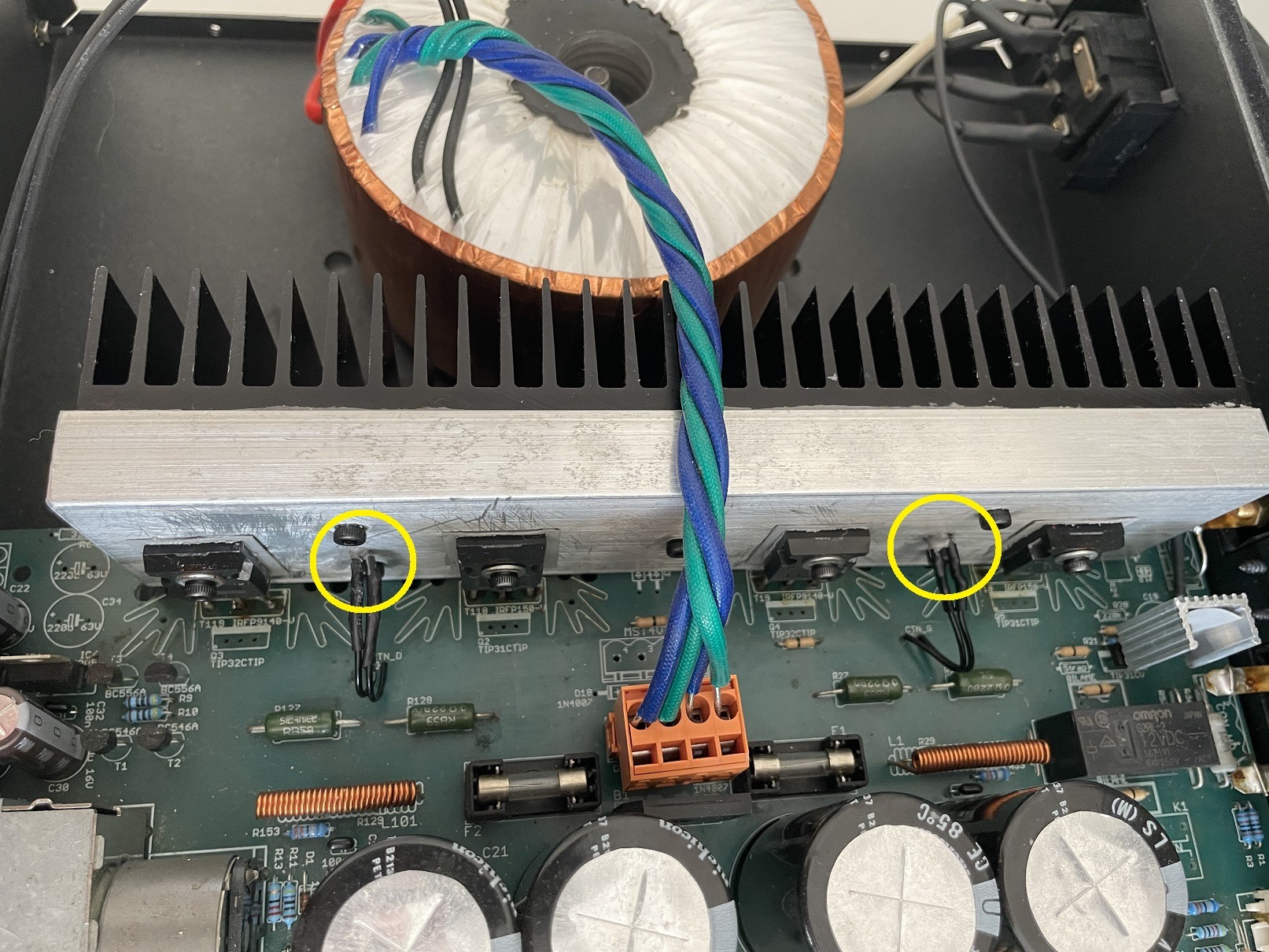

here is what you did ...This is what I did in my Atoll IN80SE, Bias adjusted to 12mV instead of 5mV.
1)better heat sink will relief mosfets from excesive heat if and when amplifier is pushed a bit harder .
2) I cannot be sure about the heat transfer characteristics of your construction so i dont know how fast and correct heat can be transfered from mosfet to massive aluminum to original heat sink ....Indeed what you have done is a bit better than the original heat sinks
3) attaching the thermistor to the aluminum ( i will not call it heat sink ) is wrong by all means because the curve of the thermistor is not switable for such an application IE the thermistor doesnt work like the tranisistors you have seen in other amplifiers
IMHO such a simple thing it could be also done at the factory
