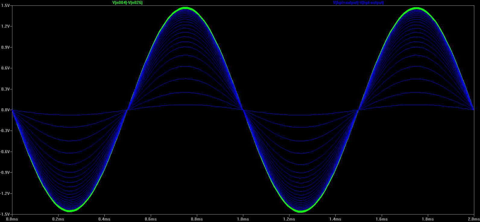

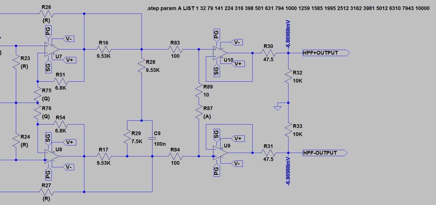

Thanks guys! First, so does the 0 degree / 0 decibel on the datasheet in post #1 mean the spot when the knob is fully counter-clockwise and there is 0dB attenuation, or does that mean the resulting signal is 0dB? I'd suspect the values to be negative if it's the former, but I'm a bit confused. This changes how I situate the pot below, so perhaps this is something I need to figure out.
Regardless, I need a little more guidance. I calculated the values and I'm not positive how to situate the attenuator. I'm trynig a shunted pot configuration, so the wiper and one leg are tied together. The goal is as the attenuator is turned clockwise to increase the volume. I also want max volume to result in as little attenuation as possible.

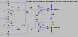

Here's the portion of my circuit we're concerned with. The input signal in the second image is taken to the left of the series resistor R83 and R84.

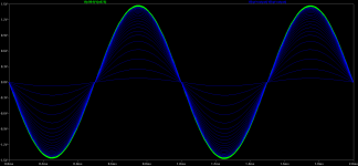

The values in the A variable are supposed to represent turning the knob to the right. On the graph, the first value in A is the lowest blue curve. As you can see, the green curve is somewhat affected by the loading of the attenuator. Now, if I tie the wiper to the other leg, then I get (10K - A) as the resultant resistance. I'm not sure if this is what I want.
Also, R83 and R84 seem to be important, if you set these too big then your minimum attenuation doesn't equal to the input signal (as desired).
Ideally, the attenuation would be equally spread out over the input curve.
