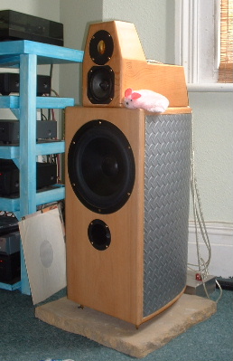

My speakers started off as straight versions of the Hi-Fi World KLS11 kit, using the HD3P Tweeter ( still the best tweeter I have ever heard, but not mentioned on this forum much as it doesn't seem to be exported outside Europe ), the HM100Z0 for mids, and the PR240Z0 for bass.
However since I first built them 5 years ago they have changed beyond all recognition- mid and high are in a separate enclosure, with mids loaded with an aperiodic TL (heavily stuffed open back tube) constructed with real hardwood on an MDF core, with bass in a reflex cabinet, made with a curved rear to the enclosure, again with MDF and a wood finish, but the rear curve is made from layers of thin ply, fibre loaded concrete and thick vinyl flooring material, heavily internally braced.
The crossover has also had more mods than I can remember, and is mounted externally to the cabinet.
The next step is to transform the whole system again, by using active crossovers, and then when my research has finished, put all the drivers in Terminated TLs.
As regarding other mid drivers, the Audax is definately the best at the price I have heard, but is outclassed by the best mid in the world -the ATC soft dome SM75.150S, but that driver is 6 times the price !
But bear in mind- many drivers that are easily available in the States are not available in Europe, and vice-versa, so there are many drivers I have not listened to...
Cheers
Picture- just in case it wasn't clear
