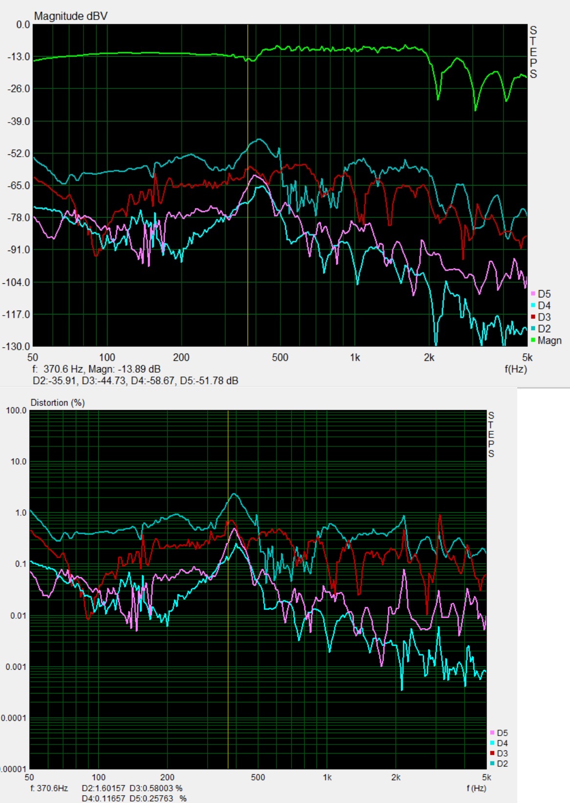

Performs well. Had 4 of them, 2 per side per channel, bass reflex, with a long planar along their edges. Went to 50Hz with room aid. Give it a try.
If it performs anything like the Aerogel series then you can do better when it comes to non linear distortion.
The Aerogels suffer from 'cone resonance amplification' in their HD plots, both the third and fifth harmonics show this. Just like you can see the frequency response mirrored in the distortion plots of hard cone drivers at 1/3 and 1/5 of the fundamental frequency.

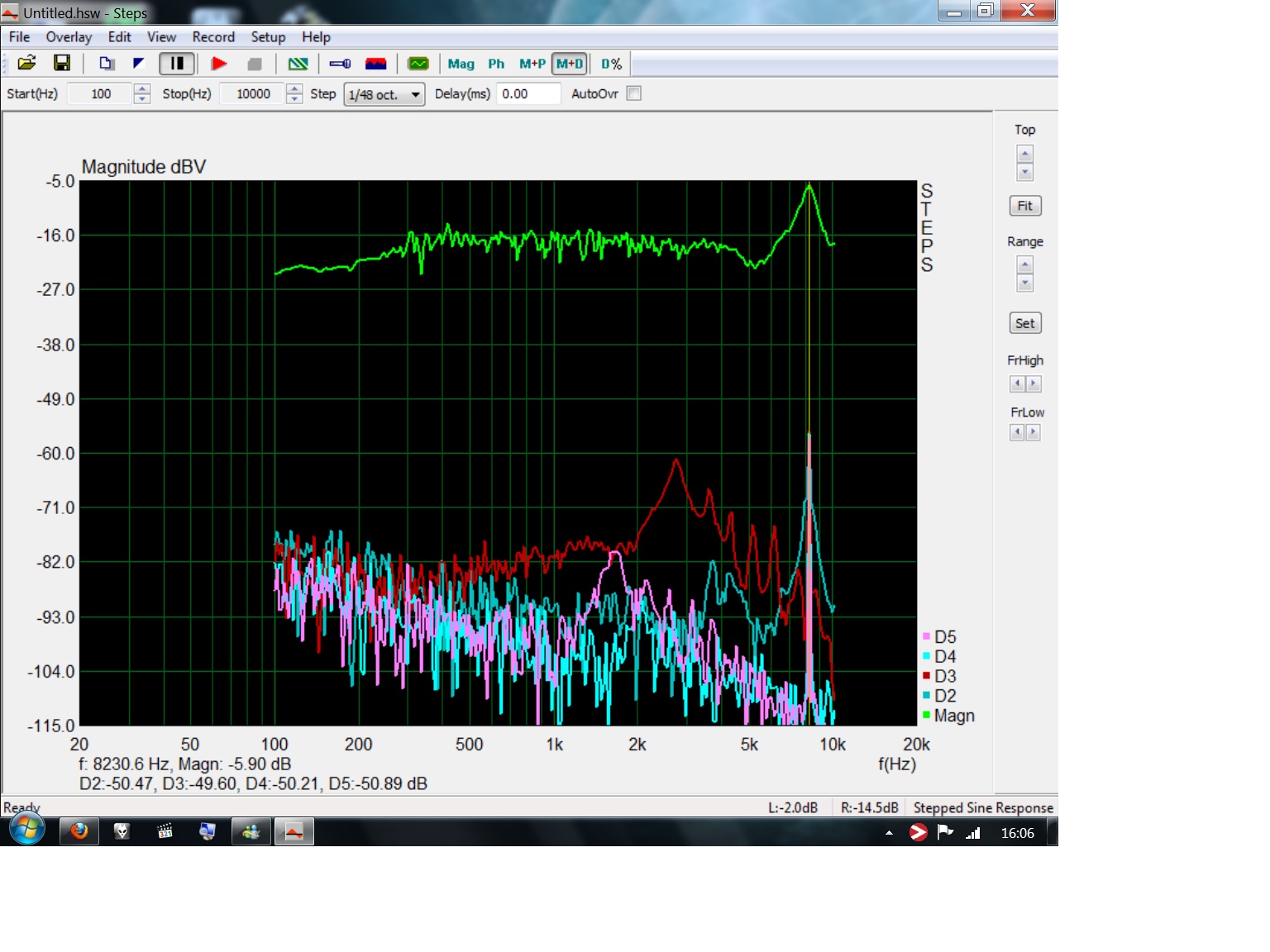

Attached are two pictures, the first is of the Seas Excel W15CY001. This is a distortion plot I made and as you can see the third and fifth harmonics mirror the frequency response.
The second picture is from Jon Marsh over at HTguide and is of an Accuton ceramic mid. As you can see in the third order plot (dashed line) it again mirrors the frequency response.
Fifth order harmonics are usually low enough down as to be off the audible radar so can be ignored.
In both the Seas and Accuton the effect happens high enough up so that you can cross over before it becomes a concern. My implementation of the W15 crosses it 4th order at 2.2khz, like this you see a slight peak in 3rd order above the rest of the HD plot, but its very low down and for all intents and purposes off the audible radar.
The Accuton is extremely well behaved and has a great motor as the HD plot shows, even with 'cone resonance amplification' happening the third harmonic remains better then 50dB down over the fundamental.
The Audax motor isn't anywhere near as well done and unfortunately the third order is at around 40-45dB down over the fundamental. The fifth order is off the audible radar however.
This in itself wouldn't be a problem if it occurred past a certain frequency, but sadly this isn't the case. Cone resonance amplification appears as low as 500hz in the 3rd harmonic iirc and keeps on going.
This is easily audible when listening to the sine sweeps when the driver is under test. The W15 sounding subjectively a lot cleaner - which is no surprise when you see how clean the distortion plot is.
The Audax HM130Z0 and HM210Z12 that I tested both showed the same problem. Although measuring 'badly' (the third order in both drivers was worse then almost all drivers Zaph has tested.) they do sound 'very lively' and 'fast' which is an extremely appealing sound - it's what attracted me to them in the first place.
However when compared to the W15CY001 and RS225 in the same application they are notably coloured in comparision. The W15 and RS225 being FAR cleaner and smoother sounding.
This isn't discussing the carbon fibre of the C0 version mind you. But C0 is very stiff and would most likely have similar results.

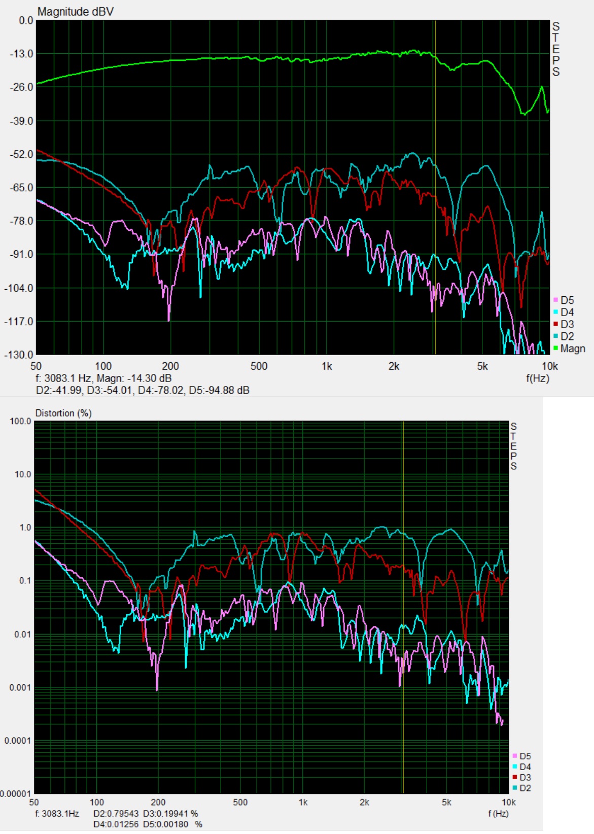

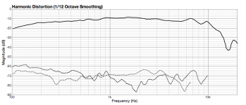

Attached are two images showing HD for the HM210Z12 and the HM130Z0. This was measured at just over 3 volts RMS, so a little over 1 watt into an 8 ohm load.
As you can see the second and third are quite high. Second I half dismissed as its fairly benign sounding. The third I was not impressed with at all.
The peak in HD at around 400hz directly corresponds to a wiggle in the impedance plot as shown in the impedance plot, so something's definitely going on there.
My problem with the Z12 is that I needed to push it quite hard within this range on the open baffle and this gave a parge peak in HD in the range where it was used.
It's the same with the Z0, something is going on, as there's a slight impedance wiggle as well. Note that I have applied some cone treatment to the Z0 and that did reduce the HD by a little bit and smoothed out the breakup considerably.
Whether or not the C0 will show similar traits is unknown, but if the motor is similar, which is likely, then I'd rather buy something else. Of course I'd be open to trying them out, if it wasn't my money!
Yes the Accuton and W15 are expensive, but the ZA14 is not expensive at all and has performance equal to that of the W15.
Maybe I'm being slightly too critical of the Audax drivers, but when there are better performers for the same or less money, they just don't make much sense.

Yes, this is what cone resonance amplification is
You've got a driver with a nasty resonance peak at 8000hz and as a result exhibits cone resonance amplification, like that of the SEAS metal and the Zaph Audio driver.
Lets feed this a 2khz signal.
Naturally there are distortion products produced.
The second order products land at 4khz, the third, 6khz and the fourth 8khz - bang on our cone resonance.
The result of this is that the cone, because it rings at this frequency, amplifies the distortion product and you see a peak in the distortion plot.
So if you feed the driver a 2.66khz frequency the third order products will be created and then amplified by the cones bell like quality at 8khz.
