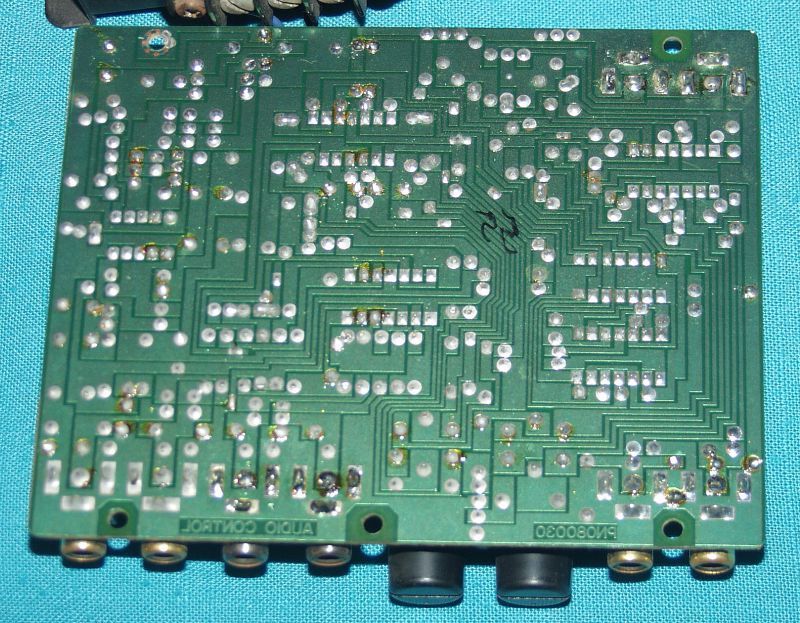

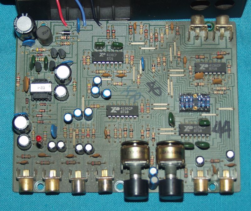

That's the problem. I'm not sure which type it is. And AudioControl won't release the schematics. I was hoping someone has looked that the PCB and determined if it is possible. I have tried tracing out a PCB a few times in the past with no luck.
I'll post pics of both sides of the PCB shorty.
Hee are the pics of the PCB (both sides). The trace side has been flipped so that it matches the component side for placement. Perhaps someone can trace out enough to determine what style of circuit it is and if changing resistor values will allow overlap or underlap of the crossover point.
State variable. I don't think that you can change the overlap. Someone will correct me if that's not correct.
