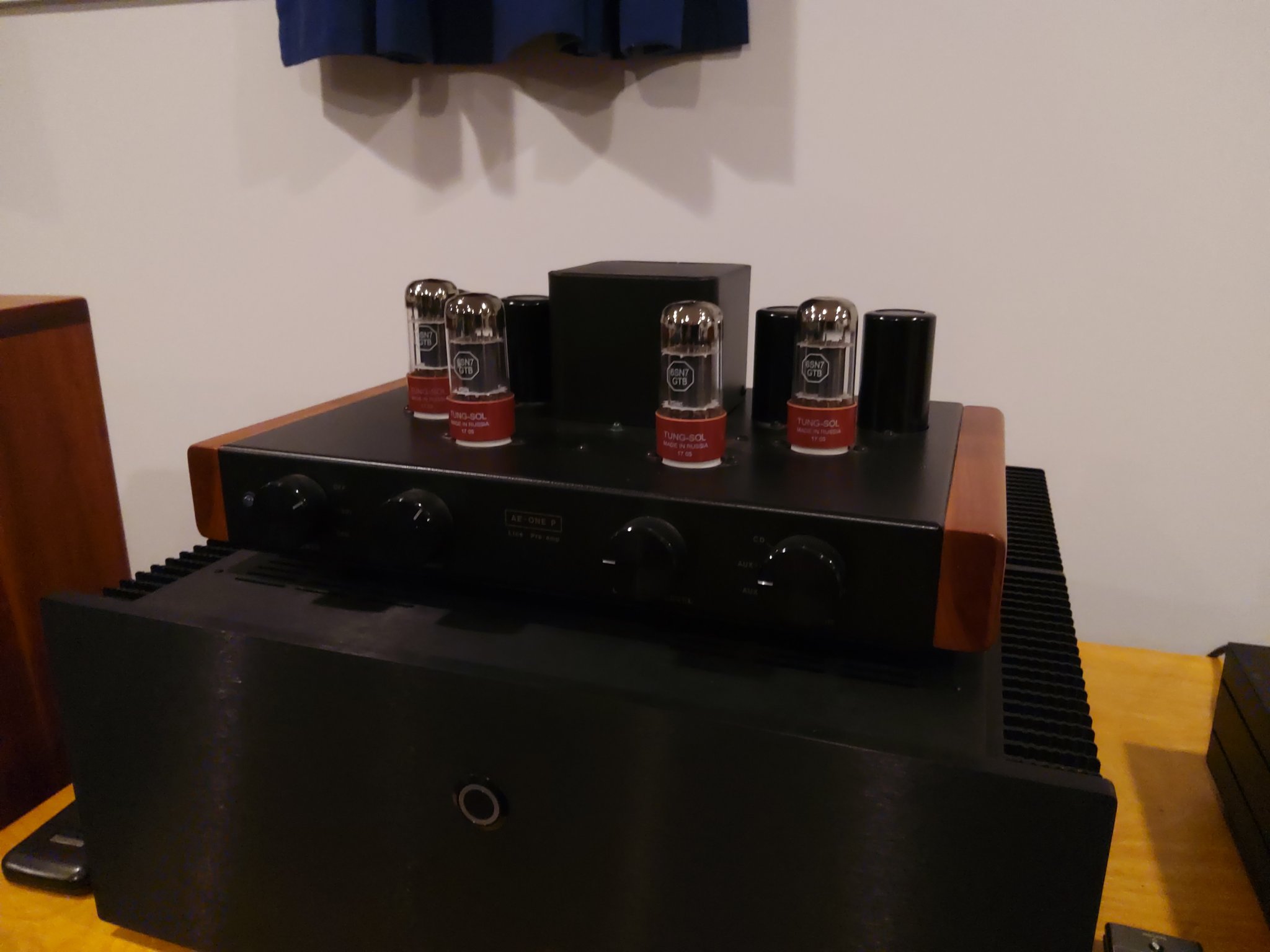

Hi Everyone, after a protracted hiatus from the forum and analogue audio, I decided to re-enter the fold! I got to dust off my Audio Electronic Supply SE-1 amp with 300B tubes and my AES AE-3 preamp, that I put together about 20 years ago.
Now that I have some free time on my hands, I realized that there must be loads of modifications that can be done on both units to enhance the sound. Does anyone have a list of mods or suggestions on how to re-energize these 2 great units?

The AE-3 is about the most minimalistic preamp circuit you can conceive of. It has a choke filtered power supply, a 6SN7 voltage amp input stage and a 6SN7 cathode follower output stage, with a three-terminal monolithic regulator powering the filaments. That's it.
There were several factory upgrades you could order when ordering the kit:
  1. Hexfred diodes in the power supply
  2. Upgraded AudioOne paper in oil coupling caps
  3. Upgraded 6SN7 tubes.
  4. There was also an option to use a tube rectifier instead of diodes
Back in the day when I purchased and built my kit, I ordered the "standard" kit (w/o the tube rectifier) but did include all of the other upgrades 1 through 3 above.
Mine had hum initially which I traced down to the volume pot housing not being well grounded. After scraping away some of the powder coating on the inside of the chassis around the volume pot mount hole, it fixed that hum, and mine has been dead quiet ever since.
There is not a lot written (that I could find) about upgrades to this preamp, other than the factory upgrades mentioned above. However, after living with mine for maybe 10 years I did change the following things:
  • DC couple the input stage to the output stage. It was originally AC coupled, and the factory upgraded coupling cap I mentioned above changed out this particular cap to the AudioOne cap. The thing is, Dennis biased the output stage exactly at the position that would would be needed if you DC coupled the stages. It's almost like he had it direct coupled initially and then at the last minute decided to AC couple. So I removed the coupling cap, the 1M grid leak resistor and the 2k self bias resistor in the cathode of the output stage, and connected the plate of the input stage directly to the grid of the output stage, as well as wired the 27k cathode resistor directly to the cathode of the output tube. I did these mods because while the amp sounded very good in "upgraded" stock form, it had just a bit of bloom. Removing that coupling cap and DC coupling the stages was more of the neutral sound I was looking for.
  • Upgrade the output stage coupling caps to Jupiter copper foil 0.22 uF 400V caps. These are a bit larger than the factory output stage caps, but they did fit--just barely.
With these upgrades, this preamp is very neutral and works great in my system. I use my AE-3 nearly every day and it works and sounds great.
Also it appears Dennis added a last minute Zener shunt regulator in the power supply. It's drawn differently in the schematic which leads me to believe it was added after the original design was complete. It's two 110V Zener's strung together in series and wired in between the choke output and ground. But on my unit, the Zeners never shunt anything because the power supply voltage at the point of the Zener shunt connection is 215V (with 122V wall socket voltage). So I just let it be, knowing the shunt isn't actually regulating anything, because the preamp sounded so good as is.
