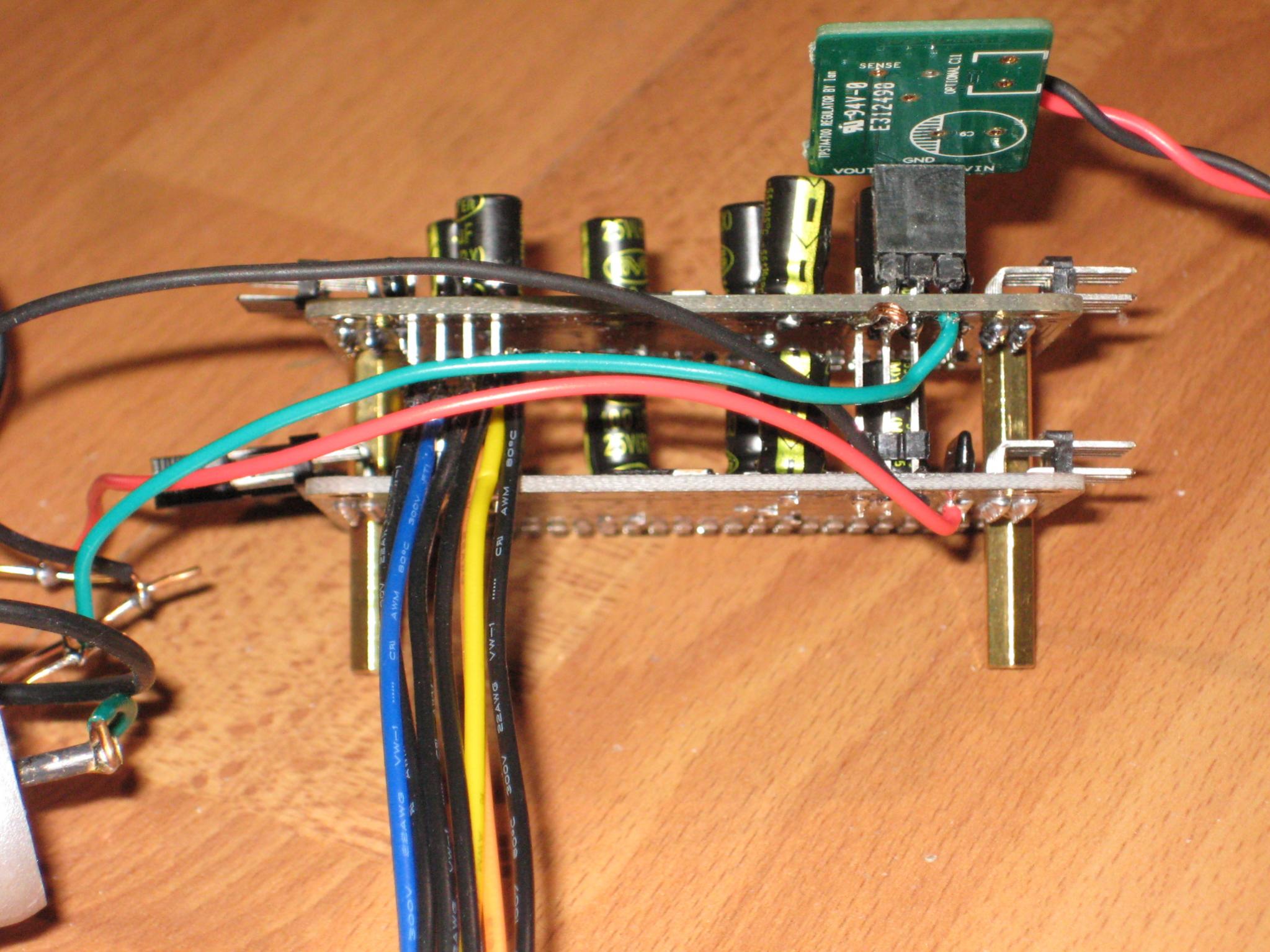

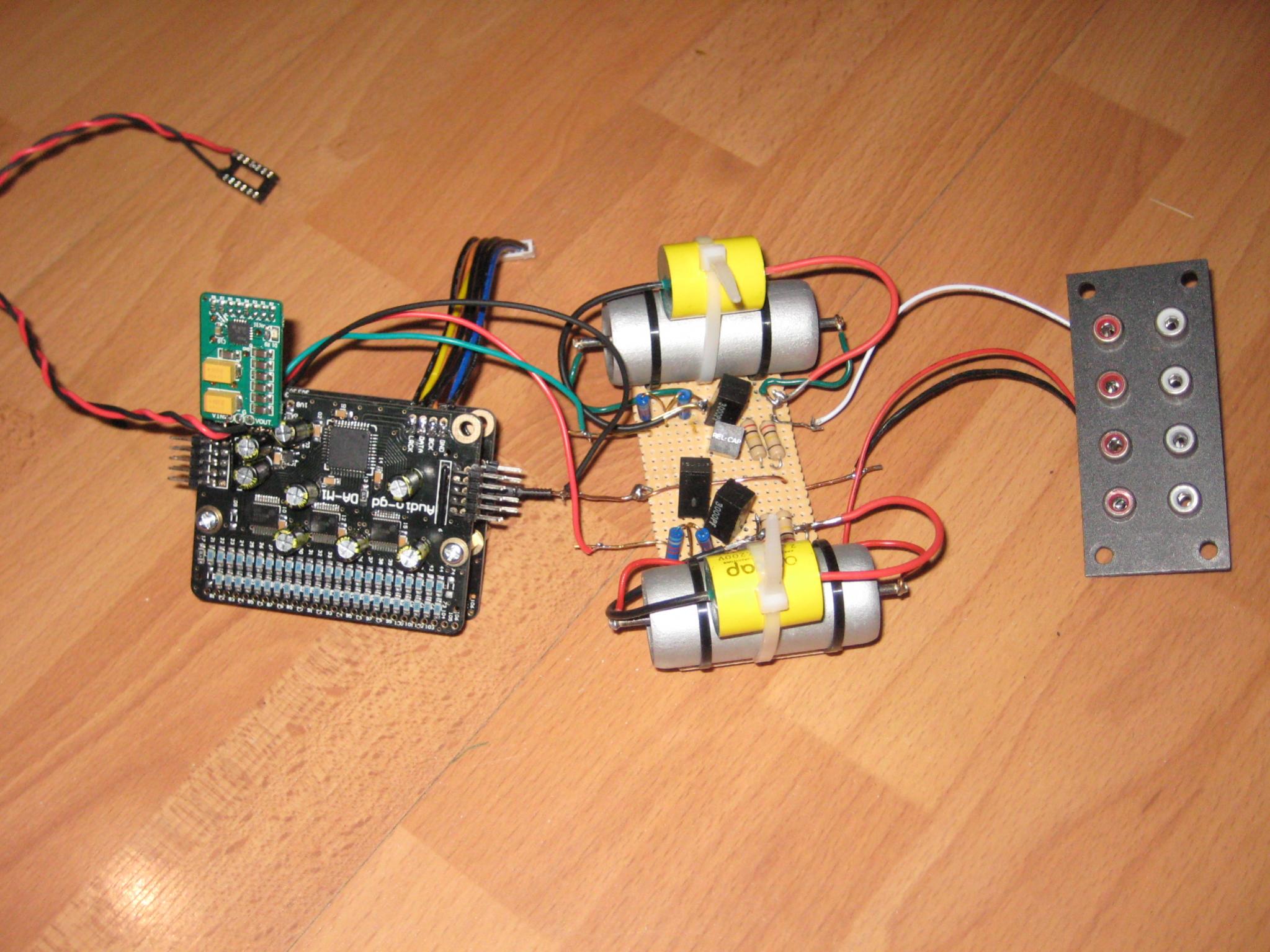

I had two boards set up following "The most simply USB NOS DAC circuit diagram" way as shown on the Audio-gd website. I deviated slightly by substituting 1.3k resistance in place of the 2.2k resistance in the low pass filter (I had higher quality resistors that added up to 1.3k). I also tried various capacitance in both the low pass and high pass filter positions.
I fed the setup with I2S from WaveIO to Iancanada FIFO, isolator, and Dual clock boards. Power was from a diy regulated 5v supply to an Iancanada TPS7A 3.3v regulator. Data was from a HP Chromebox running Debian and MPD with oversampling using SOX.
As can be seen from the photos, I tried to keep everything neat and the I2S lines were less than 100mm long.
My first listening impression was that it sounded good - maybe a bit more forward than my diy TDA1541A dac built on a copper foil covered veroboard that is fed by Iancanada's FIFO and I2S to PCM boards. But after a while I noticed something that started bothering me. On quieter passages I heard a low hiss-like sound that seemed to change with the music (distortion?). It was also really noticeable at the at the end of songs when the music faded in volume.
I then tried changing the low pass capacitor value but that did not seem to have much effect. In conjunction with the 1.3k resistor, I tried 1200pF, 2000pF, and 3000pF, which correspond to 102kHz, 61kHz, and 41kHz respectively.
I also tried different NOS vs oversampling. I tried 44.1/16, 96/24, SOX oversampled 4X and 8X. The low level noise was still there.

After an overnight burn-in, I listened some more today but in the end I couldn't stand listening to this setup because of the low level noise, so my TDA1541A is back in play. What a sonic relief.
I don't know what the issue was. It would seem to me to be something digital and not analogue. In other words I don't think it has to do with the simple output filters. Maybe it is something with the zero crossing glitch or who knows what.
Perhaps a dual board "push-pull" setup per channel would give a better outcome? I will wait for others to try and see whether they get different and better results than I did.
And another thing - the output level with the "simple" output circuit has enough voltage that another gain stage is not required in my system. I had initially connected it to the 5842 (mu of 43) tube stage that follows my TDA1541A IV resistor and the volume was way too high. So if a tube output is desired, a buffer would probably be more appropriate.
