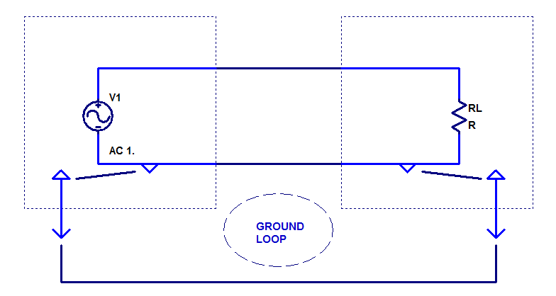

Here's a typical ground loop situation:

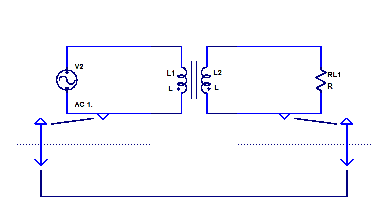

And here's how it looks with an isolation transformer inserted:
Now currents can no longer circulate, as the voltage between signal and ground is magnetically couped to the other side.
The problem is that with a galvanic connection, any current flowing over the signal ground connection causes a finite voltage drop that is indistinguishable from an actual signal component.
In a more complex setup, you could still have one or more other ground loops, but this one at least has been eliminated.

If your system is unbalanced like normal home audio it will have just 1 conductor and the ground wire. You have to break the ground wire between your source and the amp or preamp to eliminate the ground loop. The isolation transformer does that for you. At the source the signal wire and the ground wire are connected to the 2 primary wires of the transformer. At the amplifier end, you do the same thing. There is now no direct connection of the ground from the source to amplifier. You have cut the ground loop.

Thanks for your reply, so the the secondary wires shouldn't be connected to the ground? I am asking this because the ground loop problem is cause by the refrigerator, when the motor run I can hear huge noise from the headphone output, If the secondary end of the transformer is connected to the ground, the problem is still here.
The secondary has to be connected to signal ground, yes. Usually signal ground will be connected to power (safety) ground.
