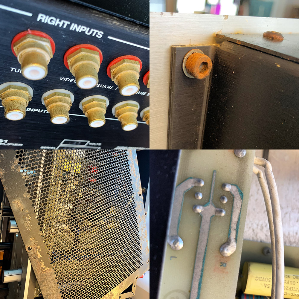

The black LS1 was in mint condition and the silver LS1 arrived in terrible condition, nothing like the seller described. But my plan was to modify one, compare to stock and decide if I could actally improve the preamp. So I kept it. What that added was a restoration as well as modification.

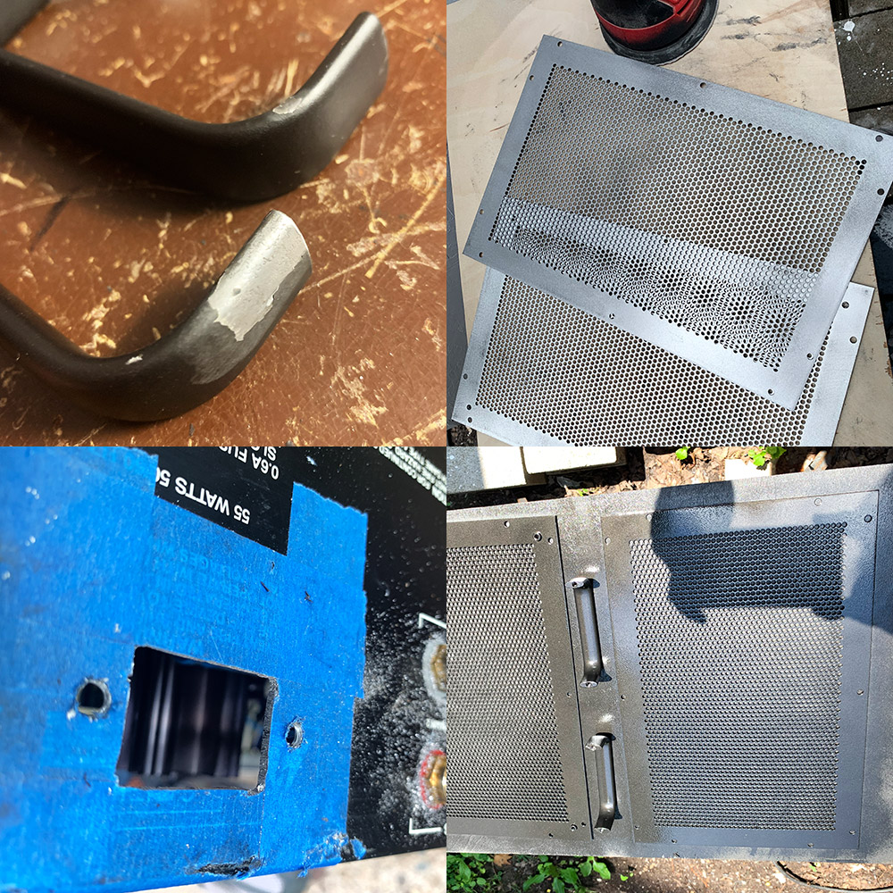

- Polish RCA Jacks with Simichrome metal polish and a rotary tool
- Carefully clean front panel and knobs with bleach spray to remove years of dirt and film
- Clean pots and switches with CRC 2-26 spray - an electrical contact cleaner I prefer to Deoxit and it's way cheaper and available at Home Depot
- Cut off hardwired power cable
- Cut and drill aluminum for can capacitor and IEC radio filtered power jack
- Sand top and bottom to bare metal to get rid of corrosion and bad paint
- Soak hardware in white vinegar to neutralize and remove corrossion
- Sand handles of corrosion spots and bad paint

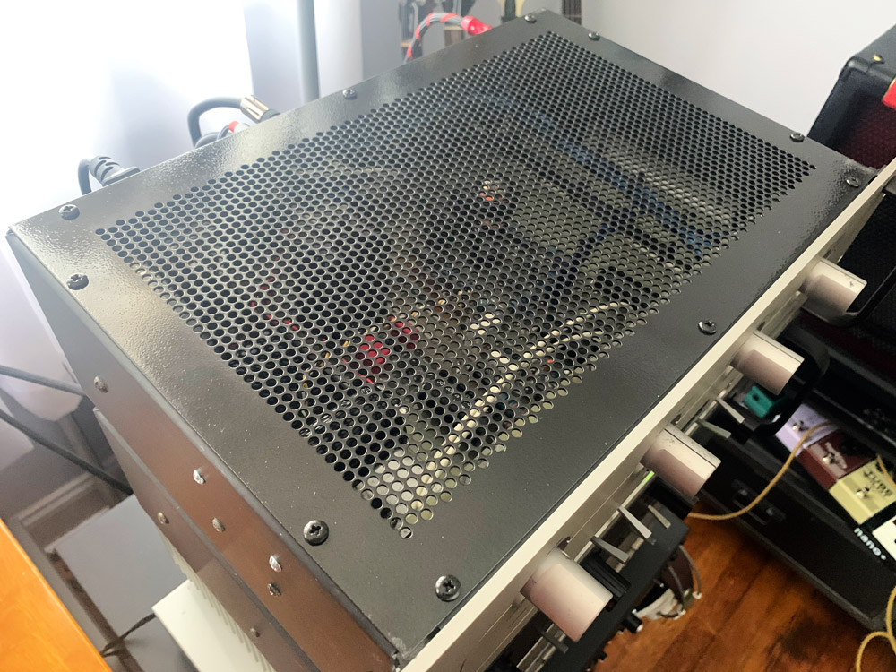

- Respray the top, bottom, handles and hardware with black rust inhibiting paint

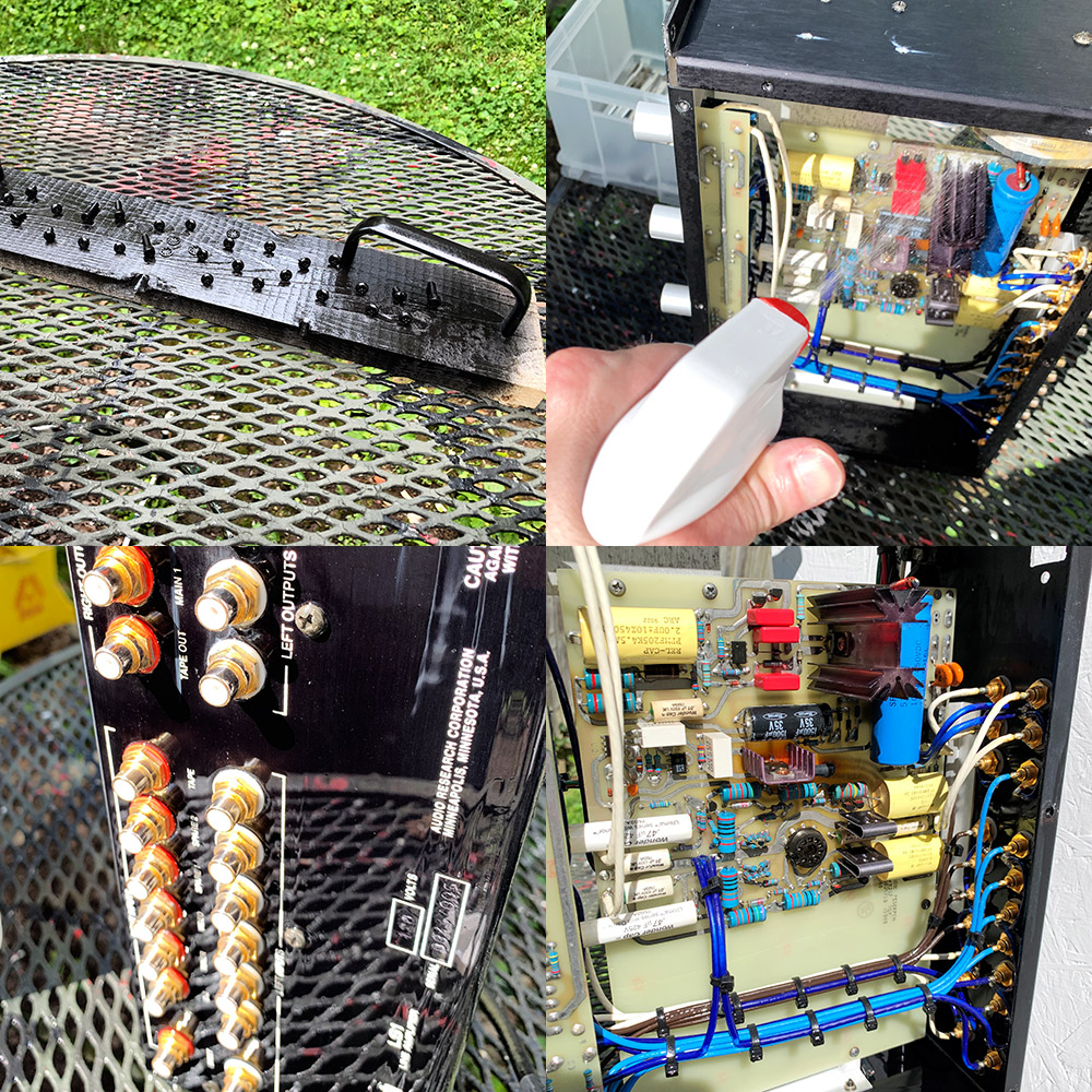

- Blow out as much aluminum bits and dirt as possible with canned air
- Sprayed 32 oz white vinegar through out pre and scrubbed with acid brush to neutralize corrosion
- Sprayed with 32oz 91% isopropyl alcohol to work on dirt and oil
- Sprayed with multiple cans of CRC Lectra Clean and Contact Cleaner to work on dirt and oil

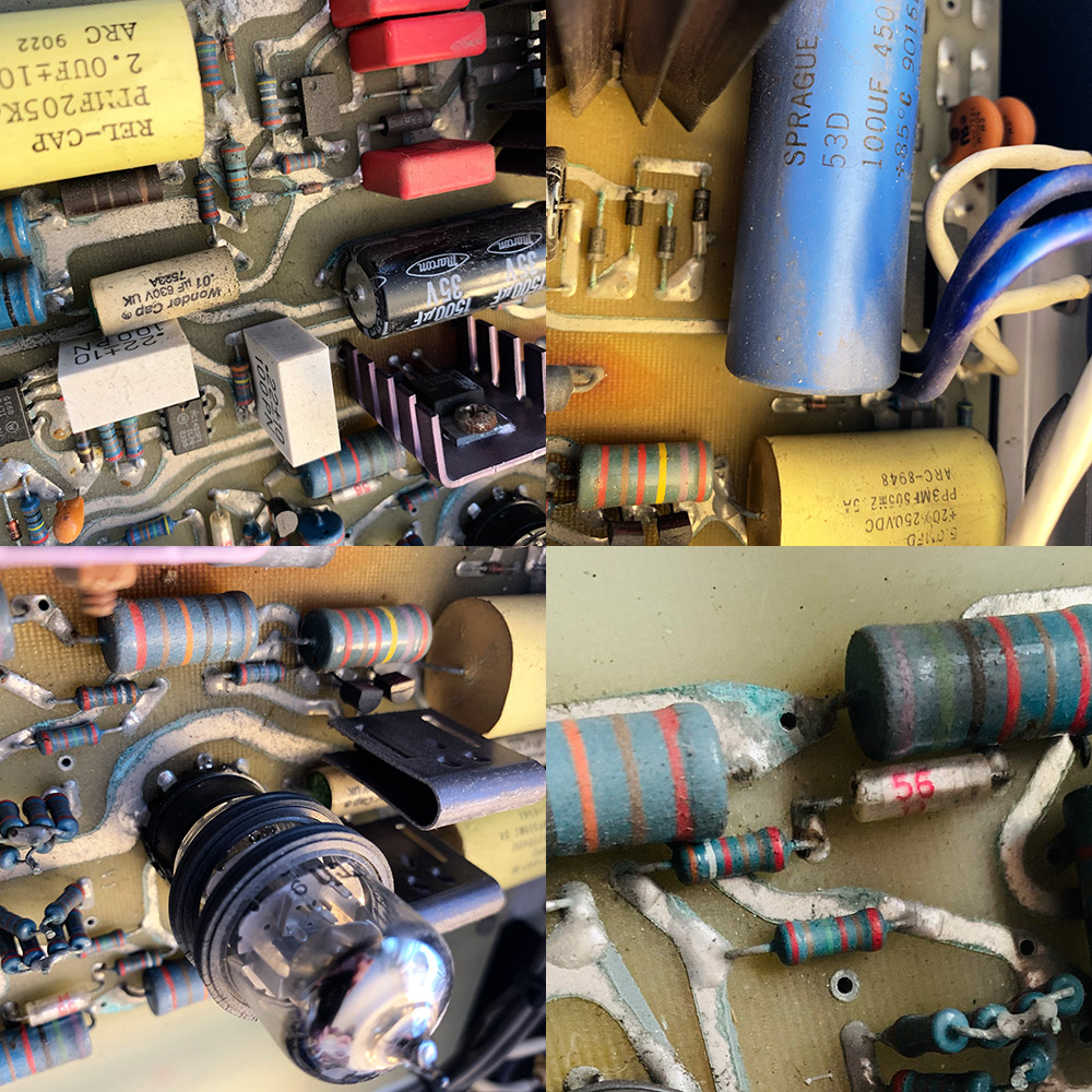

- Replace all Rel Cap and Wonder Cap with 630V Solen Fast Caps (metalized polypropylene) in power section and Dayton (film and foil) 250V/400V capacitors in audio path - the film in regulated suppy was bumped from 2.0uf to 4.7uf and the last output cap went from 5.0uf to 6.2uf. All others are same value
- Replaced Sprague 100uf/450V with Illinois Cap 100uf/450V and added a JJ 100 + 100uf/500V can capacitor
- Move the 7815 regulator to the chassis as it gets very hot and it is visible where it darkened the board from heat. It stays very cool in this position.
- Replace the EH6922 with a NOS GE 5670W and added silicone tube dampening rings

Well it looks great and is very clean. The corrosion is removed and halted and hard to even see where it was. The sound is a definite improvement over the stock LS1... there is a slightly darker background, there is definitely more top end and air. The LS1 has exceptional low end by default, but it still tightened up nicely, but then again all of the signal did. It's less harsh with the GE tube as well. Most of the LS1 issues that were critiqued in the press are sins of omission (it's an entry level ARC pre) and these changes remedy them IMO. There was such an improvement in the sound, even my significant other went, it does sound better. And she has 0 interest in audiophilia or electronics.

Thanks everyone for the feedback. To answer the which cap Q, I used Illinois 100uf/450V + 100+100/500V JJ for the high line and Illinois 5000uf/50V to replace the 1500/35V on the low voltage rail. The chassis is black anodized aluminum and looks as good as day it was made. Nothing needed there.
Part of the build was an experiment to see if the pre and those caps were as good as people say. The Rel Cap and Wonder all measured correctly upon removal. But if you go the other way in time, the #1 improvement from 1960 (or even the 70s) to when this preamp was made was in capacitor materials and construction. And we've had leaps and bounds since then. Part of the test was would modern, affordable high quality parts be better because of those improvements?
I used the exact same tube (EH6922 and GE5670) in the stock unit (which is mint condition) and this totally trashed restored one. There is no comparison on which sounds better. It's not currently the black stock one.
The Solen caps are only in the power supply. I wouldn't choose those for audio signal.
The Dayton caps are all true film and foil, not metallized poly like the Solens. (note they make both, be careful which you buy) They are the best sounding cheap capacitor you can buy in the USA. (that is my opinion)
