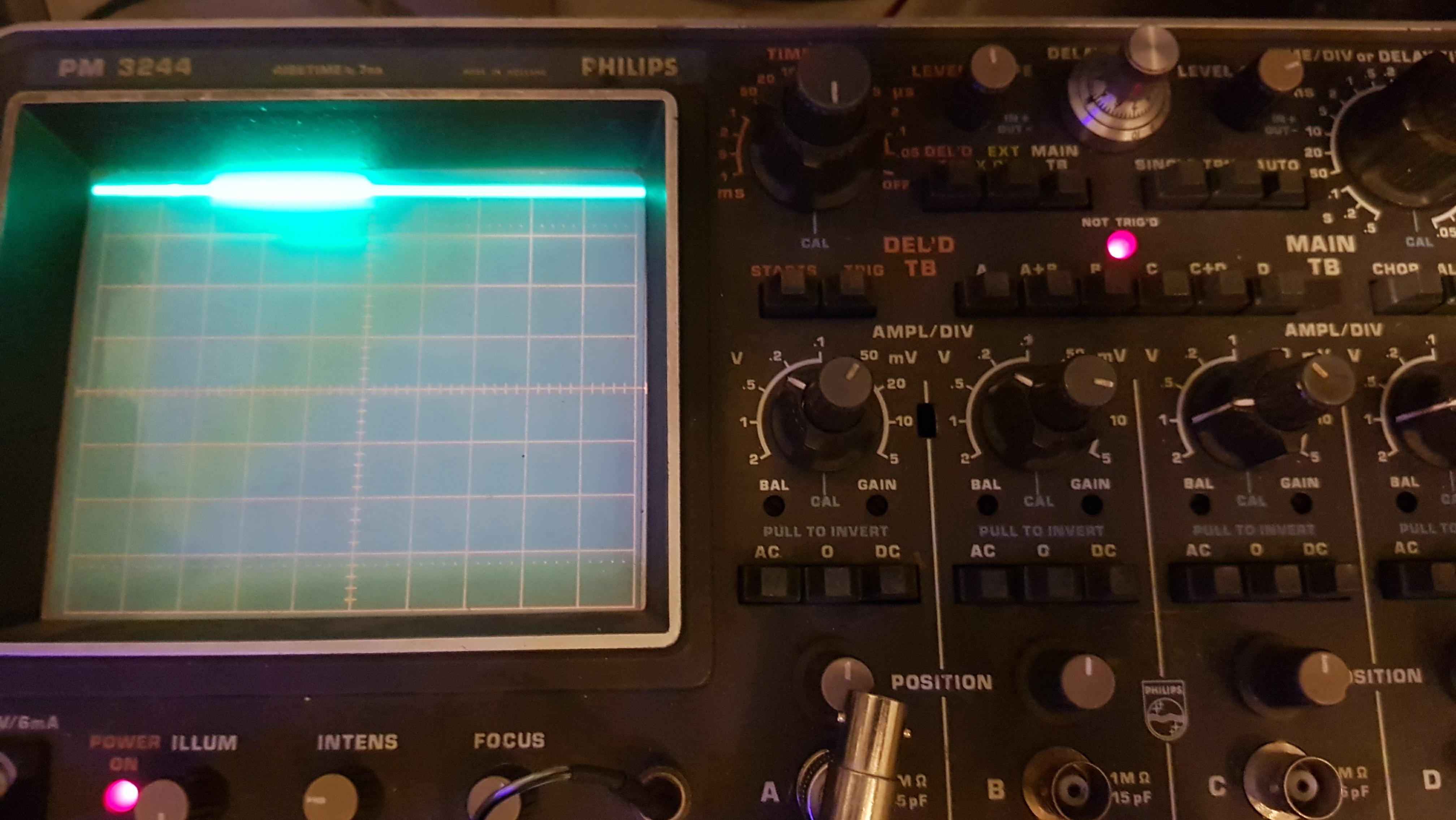

Photo 1: This is the overview of the amplifier itself. 4 banks of output fets (2 banks per channel)

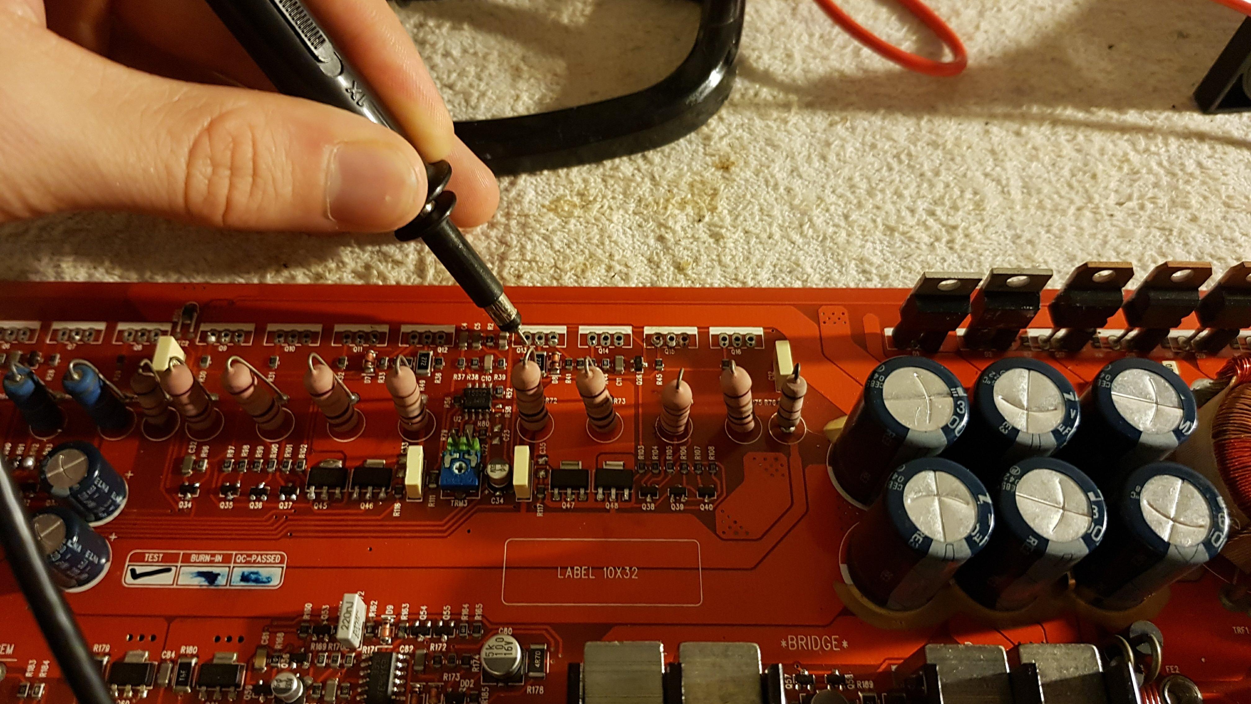

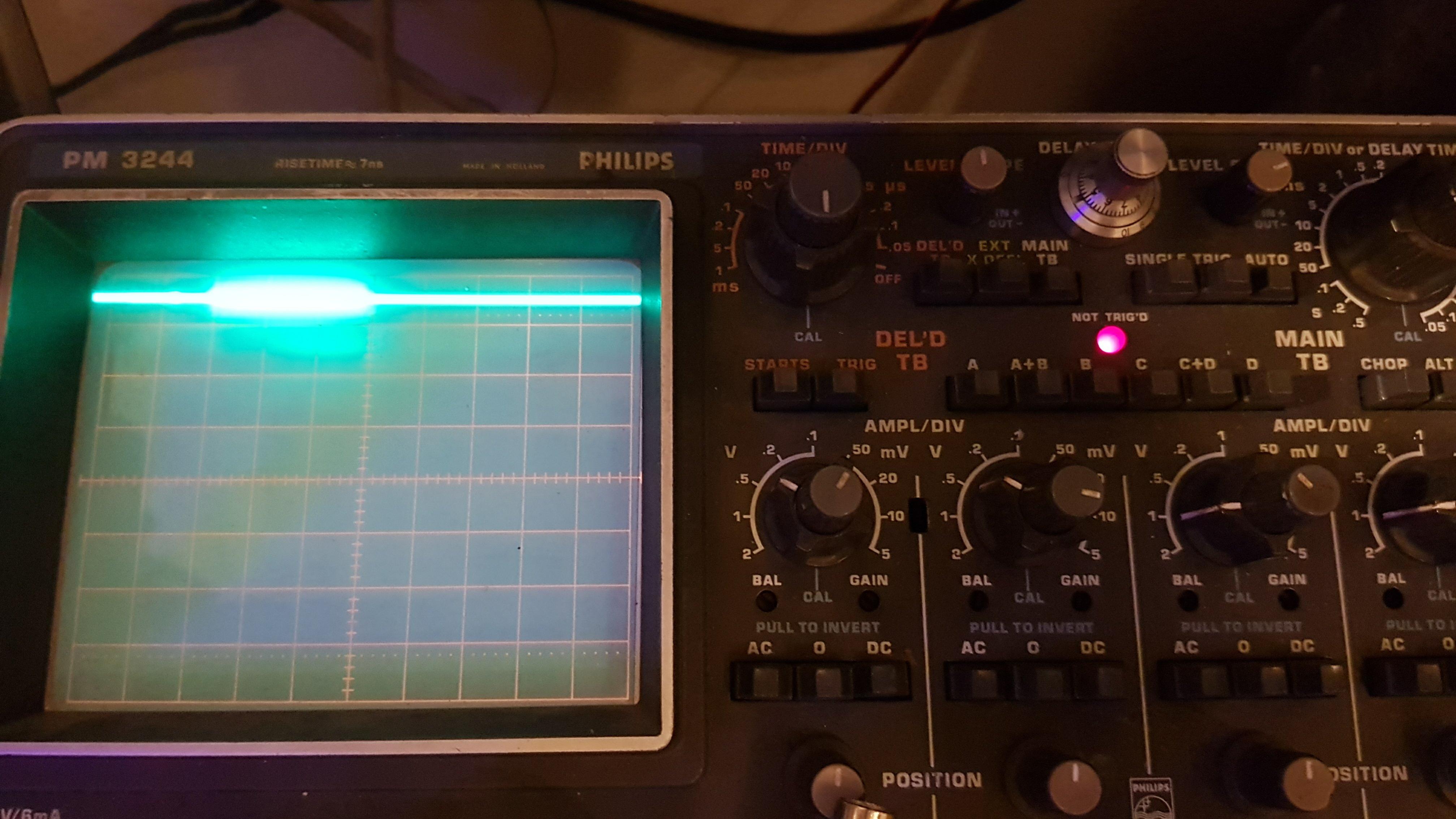

Photo 2, 3: Photo 2 is the Source of the fets which has the rail voltage you see on photo 3

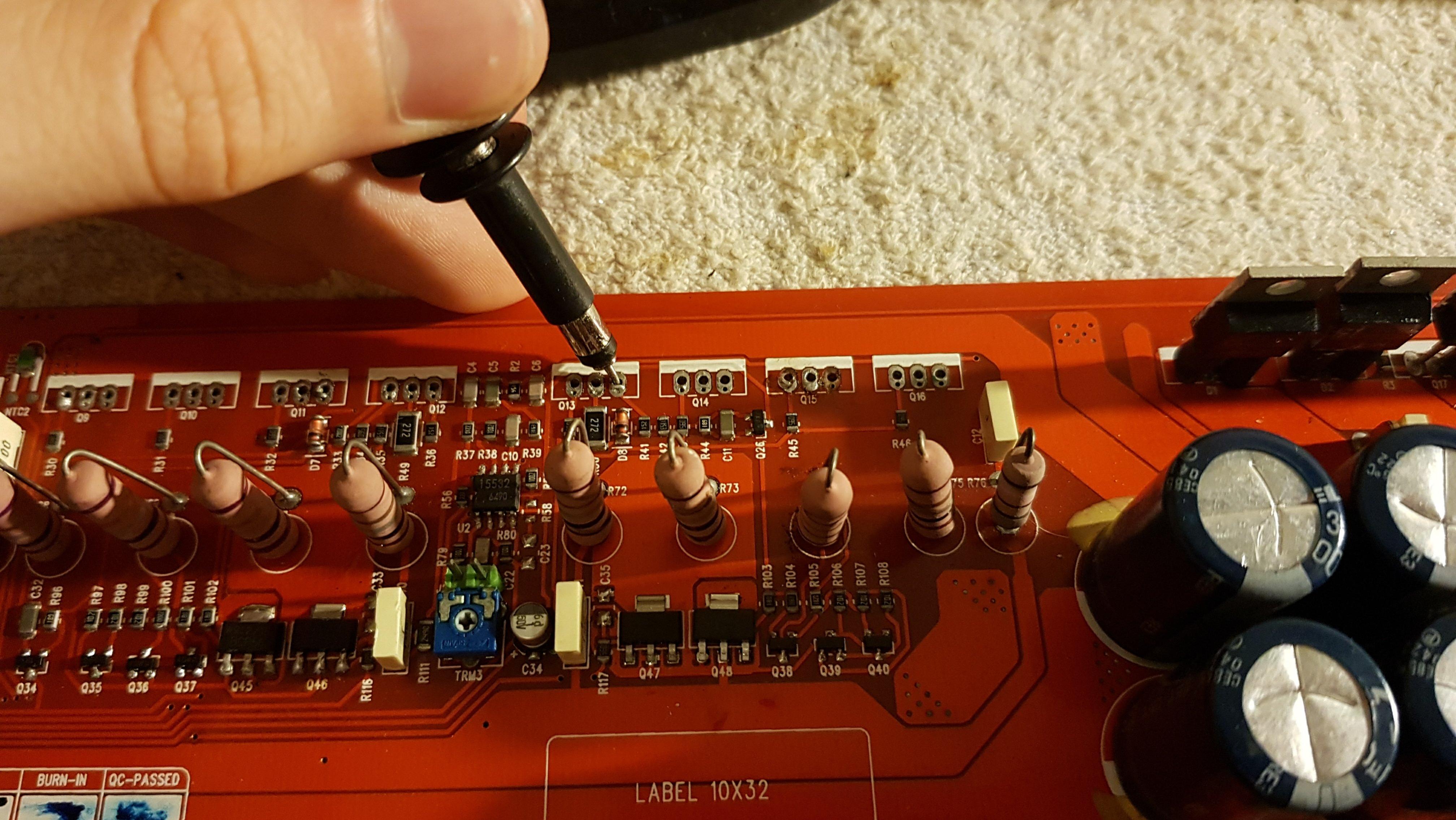

Photo 4: This is the gate of the fets which should have the same voltage as the Source on photo 3

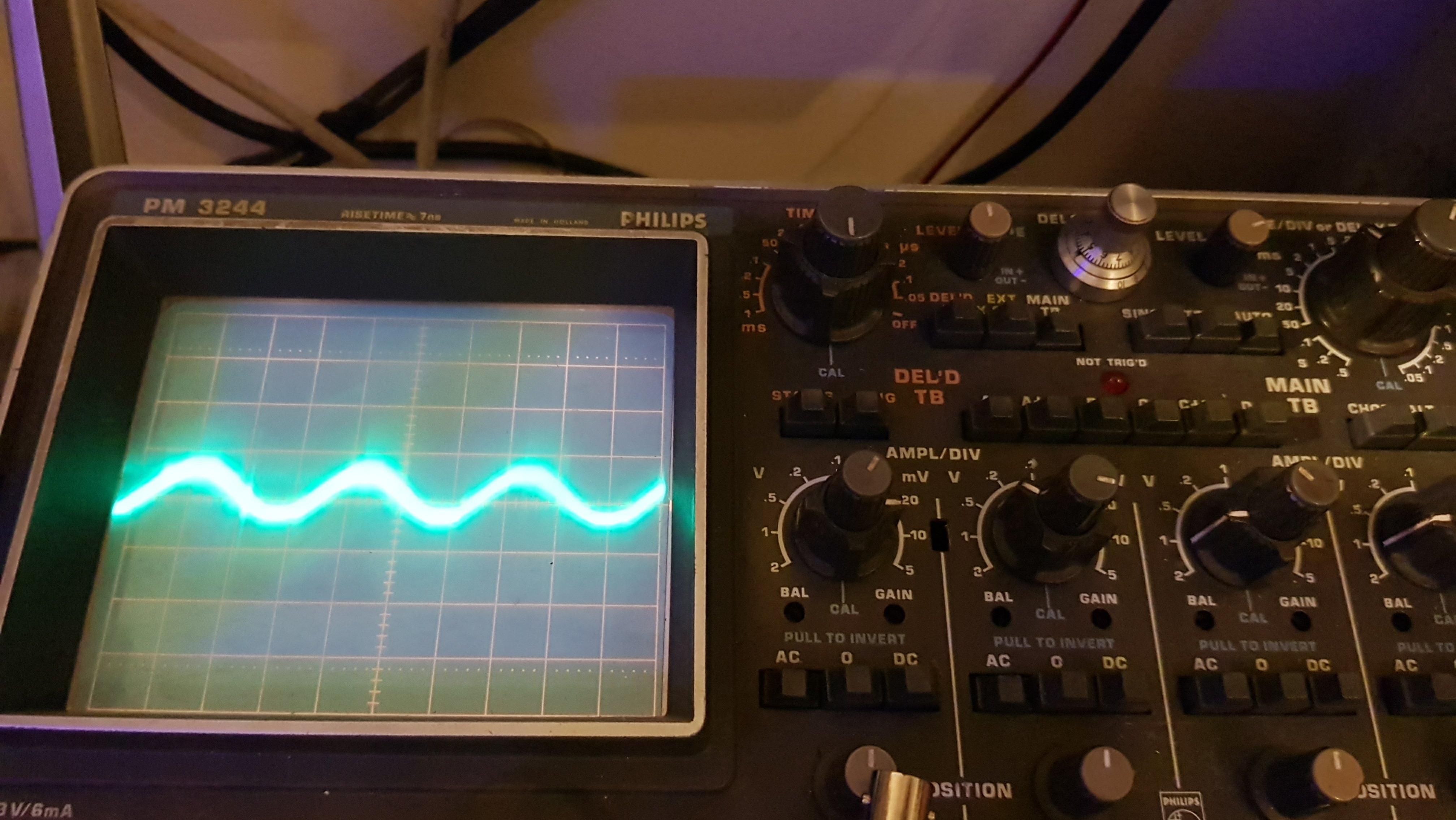

Photo 5, 6: Here you see the gate of bank 3 with a 100Hz sine wave (3x smaller than the RCA signal)

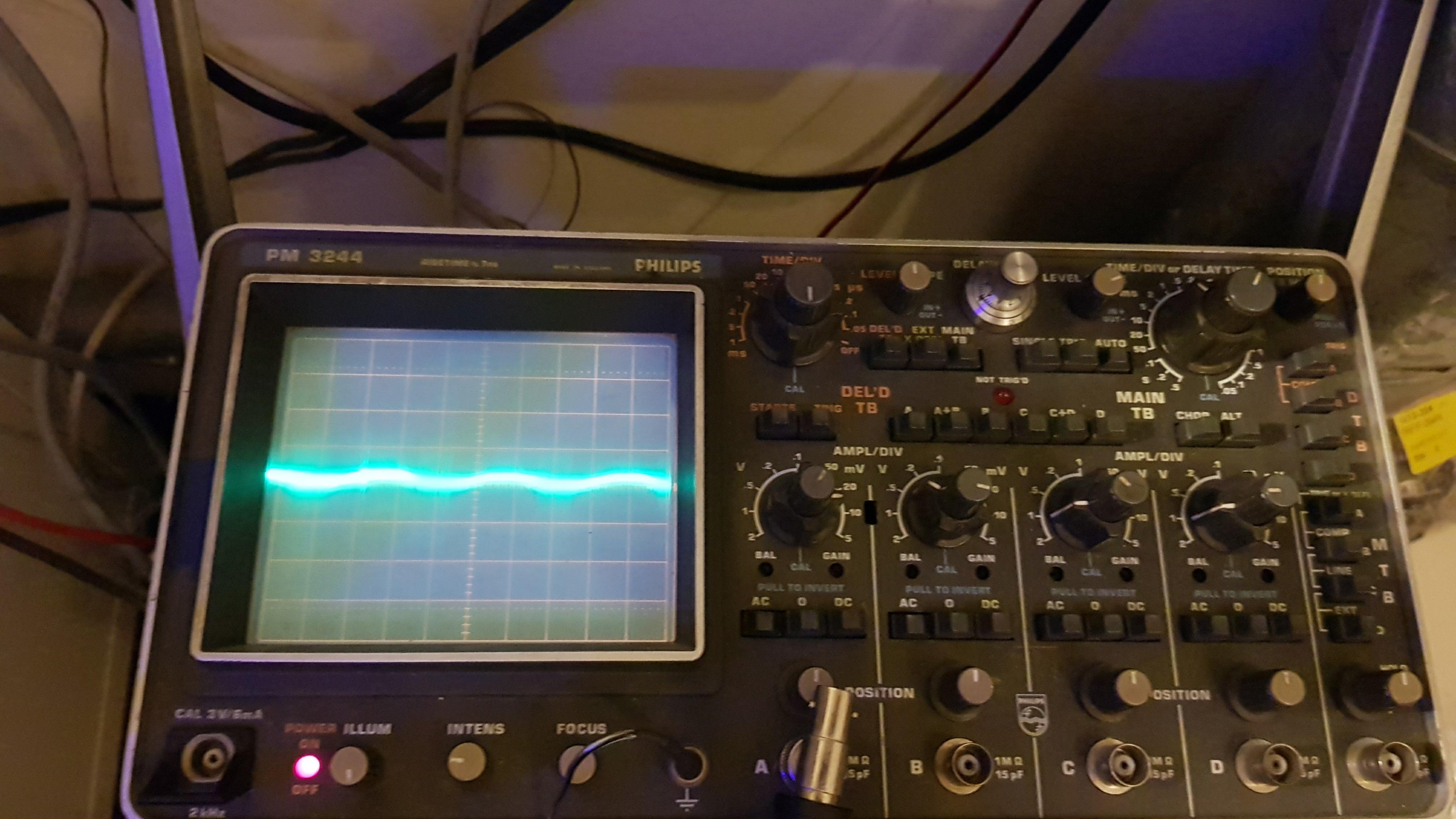

Photo 7, 8: Here you see the gate of bank 4 with a 100Hz sine wave (approximatelly 10x smaller than the RCA signal)
