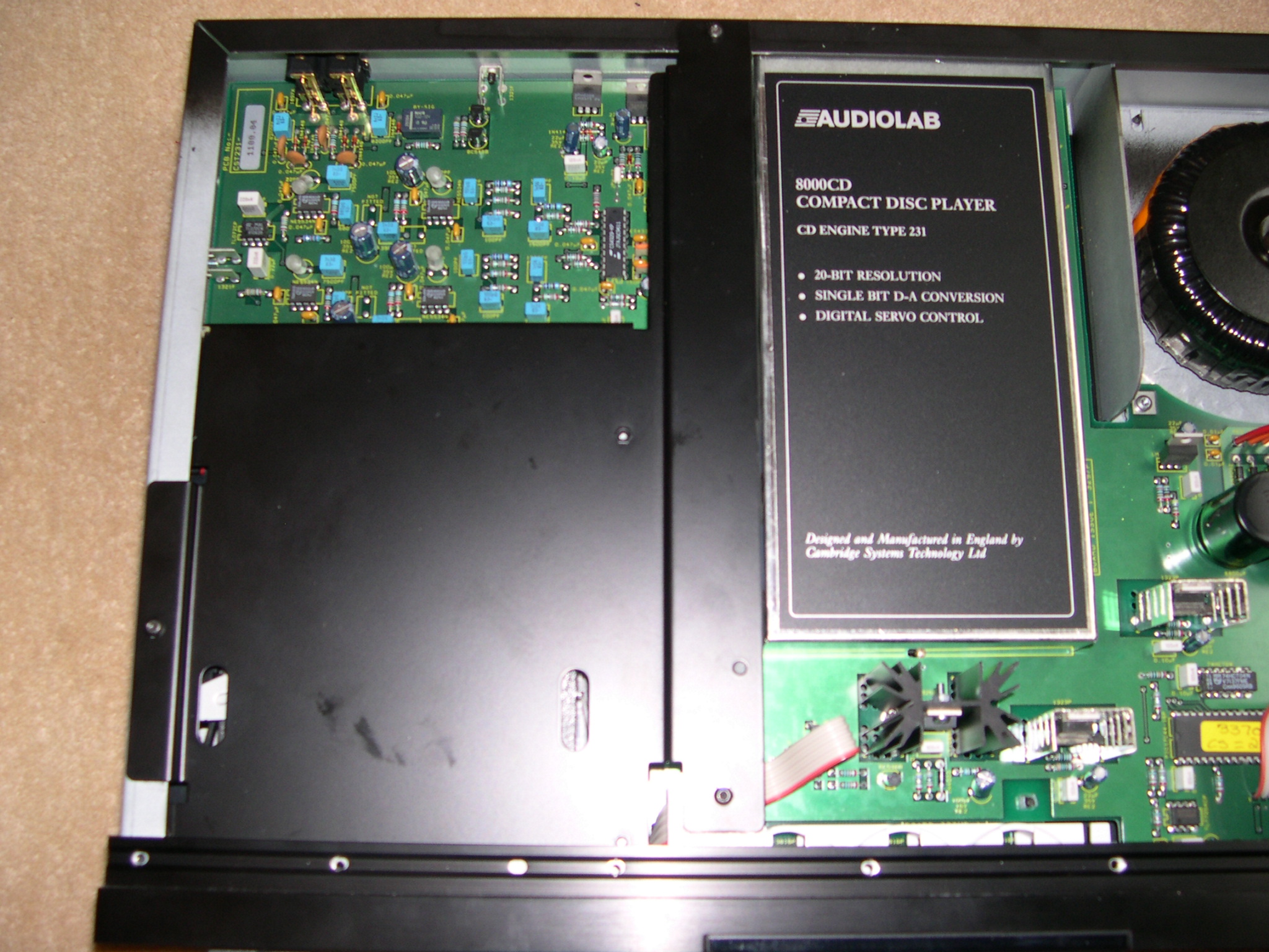

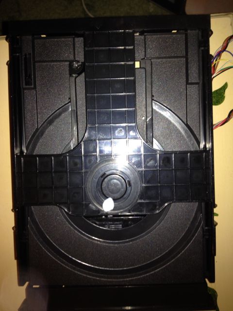

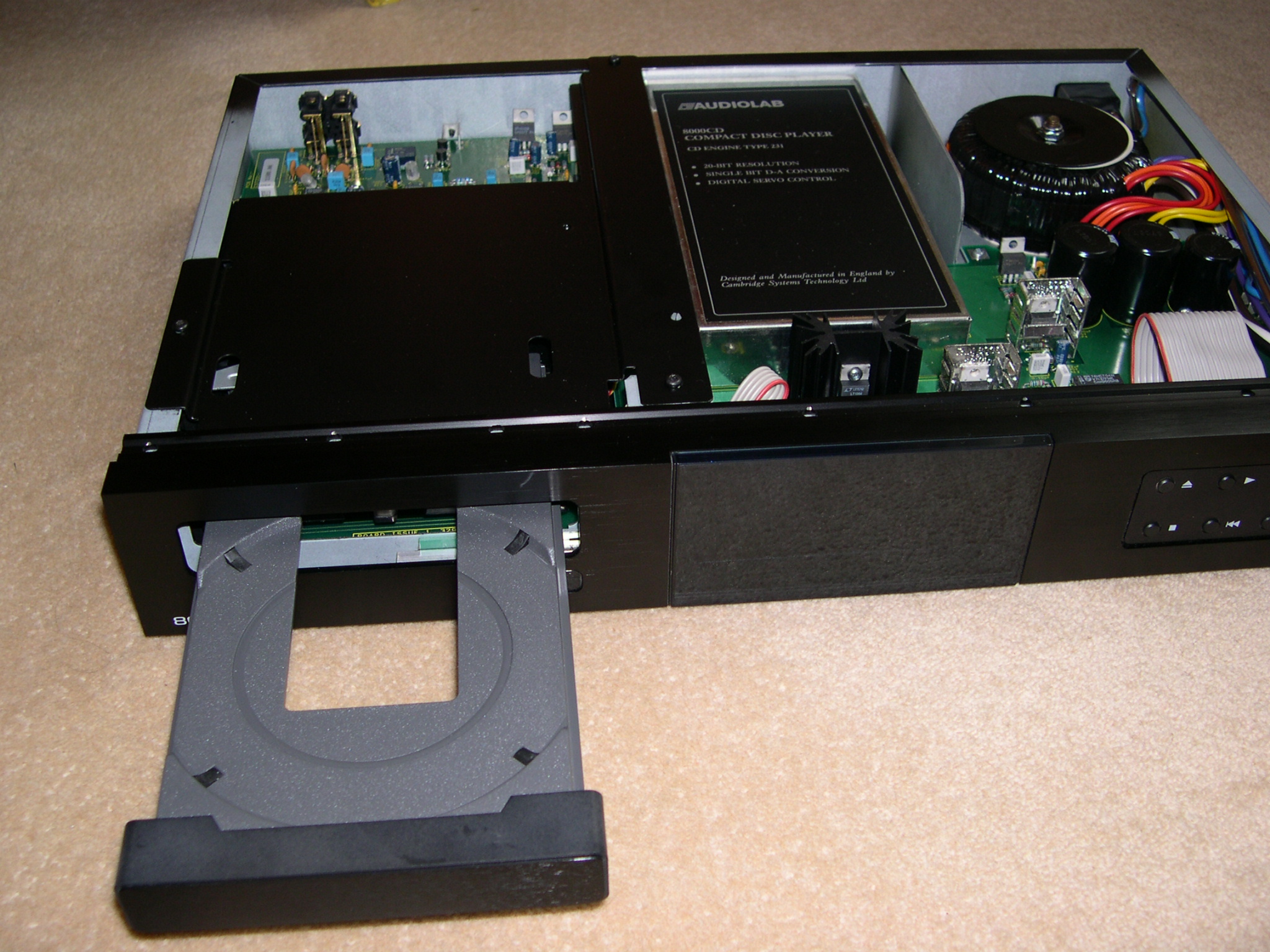

Hi Mooly,
I am attaching some pics to assist (if it works).
The first gives an overall view and the internal casing I refer to is on the left side. The three attachment screws are just visible, one on the left side and two on the black bar on the right which runs from front to back of the player. Even with these removed and the screws for the facia removed there does not seem to be a way to get either the assembly out to view what is underneath or inside.
The second pic shows the view from the front with the slider extended.
I hope this helps.

Thanks for the pics. The drawer isn't the "normal" Philips loader that the CDM12 series pickups are normally used with. It looks like a DVD drive tbh with the metal can.
I think you are going to have to dismantle it a bit more and see just what is under there.

A service manual or circuit diagram would be a huge help. The fact that error shows instantly wouldn't normally point to a faulty pickup... but if it is a DVD drive then that's a whole different ball game.
It should come apart fairly easily, just make a note of everything you do. The metal cover might also be clipped in place as well as screwed but it's normally a case of unscrewing everything in sight. The assembly may well be held from underneath too.

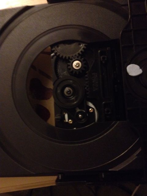

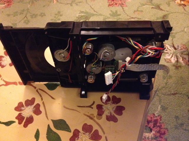

Can anyone help me identify the mechanism from AudioLab 8000 CDE?
I bought a 2nd hand AudioLab 8000CDE on ebay ages ago.
The transport has never worked correctly, sticking on both opening and closing. When a disk is in and it is closed, it reads and plays excellently. Just opening and closing doesn't work.
I have disassembled it and have been fiddling with the mechanism to see if I can understand what is wrong. I have not made any progress. I am pretty sure the issue is mechanical. On opening, the tray moves one or two mm and then sticks. You can then apply a gentle force with fingers and pull it out. When you close the tray the same thing happens. It sticks at the same point going in. There is no obvious evidence of mechanical damage.
What I would like to do is replace the complete transport mechanism. However I have not been able to identify it or find a replacement. Early posts on this thread suggest that it might be a Phillips series 12 DVD transport. I have googled that but found nothing that looks anything like my transport.
The letters PH02A appear on it in various places. There is a 15 or 16 way ribbon cable from the laser unit. There are two additional connectors one 4 way the other 6 way for the drive electronics.
If anyone can suggest make and model number and where I might get a replacement, I would be very grateful. It came from an AudioLab 8000CDE. The serial number of its parent 8000CDE is 632A000002. Photos below.

It appears to be a Philips CDM12.6. The dac ref list says it's meant to be a CDM12.4, but it clearly is not. I believe the 12.6 is the only mech of the series with a normal, vertical mount tracking motor, rather than the skinny horizontal motor w/worm shaft that 12.4/etc. all have. But the loading mech is completely separate from the CDM, so finding a new 12.6 won't help with this problem. You have tried cleaning and/or replacing the little tray drive belt, right?
