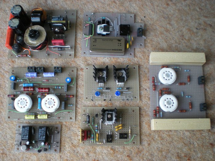

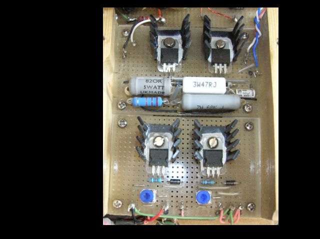

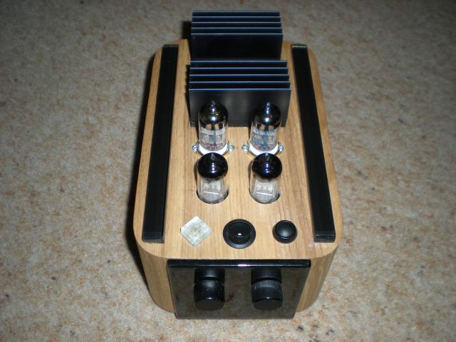

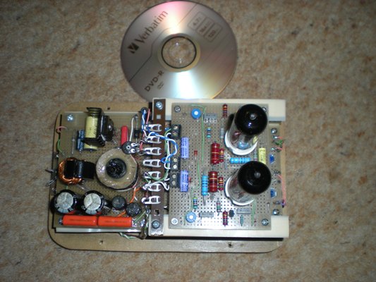

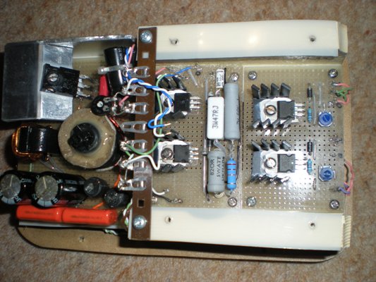

A couple of weeks and a lot of fun..
Don't try this at home..😀 Veroboard project..(preamp)
Just for fun build..its been shown before a some time ago..however It was fun and perhaps you might get a few ideas..
The cropped pic shows the modified Maida reg..the third is is an initial test its a bit scruffy because a PCB has been removed..
