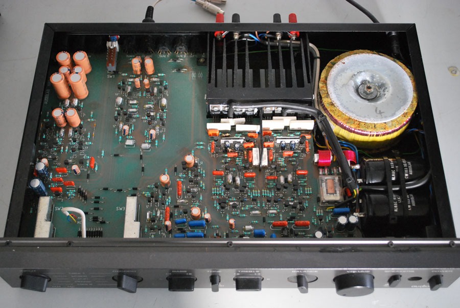

My AUDIOLAB 8000C preamp burns its input fuse ( T1A 5x20mm ).
Because its transformer ( a Nuvotem Teo ) has its primary shorted.
Alas, I could not find the diagram for the 8000C.
So, impossible for me to know the characteristics of its transformer.
And especially the voltage at its secondary output.
In order to chise a new trasfo
Hence my question...

From what I know there are no complete service manuals for this preamp (and other gear from Audiolab) but there may be a way around it if you know some basic electronics.
From what I seen in other pictures the relay (mute?) near the power supply rectifier/regulator is 24V (DC?) so I would guess a transformer secondary of 18Vac and since Talema "code"P2S2 translates to 2 primaries (2 x 115V) and 2 secondaries (18/0/18/0) and I think around 50VA (check marking on the back of unit).

Yes, and check the transformer VA rating by comparing the core with other brands.
Don't undersize it.
In the 8000A, the supply voltages are +30V/0V for line and MM, and +10V/0V for MC.
(No negative supply voltages.)

Please don't just get a new transformer. The chance of a Talema burning trough the primary, just for fun is very, very low.
In most cases a rectifier and/ or a capacitor are the primary cause.
First disconect the transformer from the unit and check it all allone, for Ohms on primary and secondary side. Best remove it from the chassis.
Then post again.
The 18-0-18-0 Volt, 50 VA guess seems right to me. a usual value for pre-amps. You don't need to buy exactly the same, so a 240V version may be simpler to get than 120-120V.
Then post again.

If the fuse still blows with the transformer secondary unconnected,
this fault could also damage the Variac itself.
Photograph and document all the connections, and then remove the toroid from the chassis.
Measure all the windings for continuity, and post the results here.
Then we can decide whether it is safe to power the transformer separately.

OK, here we go: As this pre amp is so simple, it doesn's matter we have no schematics.
First I would cut the transformer wires to the amp, leaving about 4cm at the transformer. This is for measuring and possible re-use of the transformer, while having the connections 100% clear (wire colors!).
Later it will be 100% OK to use screw connectors to the new transformer. No need to solder the AC wires.
Then measure the resistance of the transformer windings. Make a sketch with wire colors. Post.
Next do a handfull of good pictures of the amp, it's board and wires/ components connected to the now missing transformer.
Use a lot of light, so the pictures can be enlarged. This way we can reconstruct the power supply and find out what AC input it needs.
@dray177 this is a very simple amp with no secrets. If you do not skip any step wise people advise you to take, it will be an easy repair.
Please do not decide by your self what to do next. Let people analyse until the end what the problem is and only reconnect it to 230V when there is an OK.
As said in the beginning, transformer need a cause to burn through. They don't just fail after years of service.
So there might be some other simple parts to replace, my guess is the large capacitor and the rectifier that seems to be hidden behind the wires.
Calculate about 70€ of parts for the worst, including postage and your amp should do for the next 20 years to come.

No it wouldn't. You don't know what's wrong yet. You only have a symptom so far.
