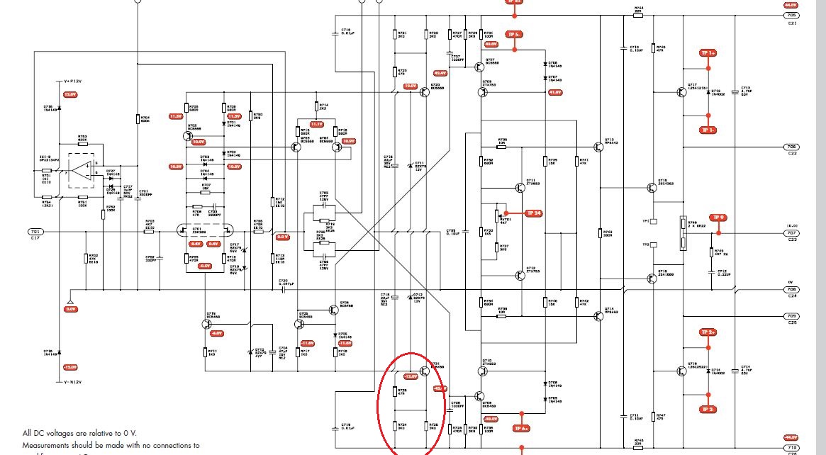

I have an Audiolab 1997 8000S and 1986 8000A, both of which are working fine.

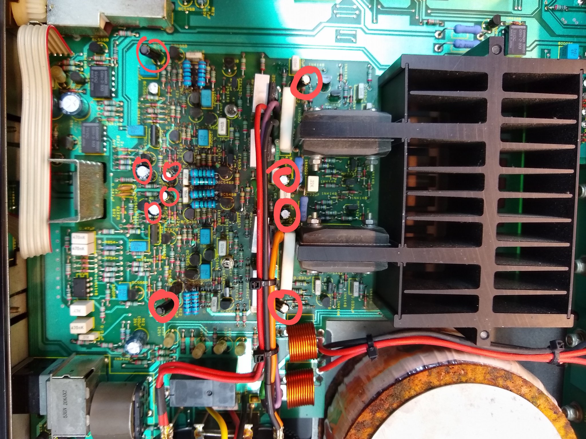

However, the 8000S resistors 721, 722, (724, 725, 821, 822, 824 and 825) are visibly burnt. They seem to be 4 sets of parallel configured resistors to give higher power ratings. They have been obviously getting hot for a while as the circuit board is discoloured. My schematics are dated 2005 so are for the Chinese version amp. The diagram says these resistors should be 3K0. which in parallel, will be 1K5. Actually, with my amp built in 1997, they are 2K0, so have a total R of 1K0.

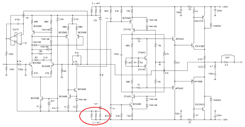

The 8000A circuit is similar but not identical. It has 3 x 4K7 resistors in parallel
(R447, 449 and 451 according to my circuit) to give 1k56, which is similar to the Chinese version of 8000S.
Using a DVM, there is upto 32V dropped across the resistors in the 8000S, giving a power requirement of about 1Watt which might explain why they are burning.
Although I have made measurements etc, Im no Designer.
So what do these resistors actually do?
Will changing them to 3K0 on the 8000S be a good idea, so as to reduce the current and therfore lower the wattage needed?
What effect will this have on the sound of the amp, if any?

With Audiolabs recommendation, I changed the resistors to 3K, 0.6 or 0.75W, 1% metal film. According to Audiolab, the resistors in question have been modded to 3K resistors in newer amps because of this prob. Its a design fault. They are also 3K in my old 8000A. The 2 resistors are in parallel so old total = 1K. Chnaging them to 3K means total = 1.5K. This will reduce the I through them, resulting in them not getting so hot. The previous owner admitted to leaving the amp on all the time and had done for over 10 years!! Its still not within x5 of the power rating but its better than it was. Audiolab also said reset the bias, after changing them. I found that when I did this change, it def ran cooler and after rebiasing, it sounded less harsh.
I found it difficult to adjust the pots when resetting the bias. They just wouldnt stay fixed. I was told its best to be slightly high with the bias V, if it couldnt be exactly set, to stop a harsh sound. It should be 22.5mV.

To reduce interaction by the input stage even by full power, the dropped voltages by the resistors are very high.
Best solution is an extra independend input stage power supply for +/-12V
More easy is the use of TO-220 resistors for Chassis mounting to avoid burned PCB aeras.

I cannot read the resistor labels in the 8000S schematic.
The 8000A sch is quite different.
Those three resistors are feeding the Zener regulated 12V line and the same in the upper rail.
P= V^/R = [42-12]^2/4700 = 0.191W. If they used 500mW, or 600mW, resistors then they should run warm, not hot.
The two circled parallel to the rail are 3K0, and the third, in series above the 3K0 on the left, is 47R.Tim

I still can't read the sch, but I can guide your calculations
Power in one dropper resistor = {Vrail - [Zener voltage + Vbe] } ^2 / 3k
If Vrail = 51V and Zener = 12V then Pdiss = 492mW
If mains voltage is high, often 245Vac at my various UK homes, then the Pdiss will be even higher.

Old thread I know ... but someone may find this useful in the future:With Audiolabs recommendation, I changed the resistors to 3K, 0.6 or 0.75W, 1% metal film. According to Audiolab, the resistors in question have been modded to 3K resistors in newer amps because of this prob. Its a design fault. They are also 3K in my old 8000A. The 2 resistors are in parallel so old total = 1K. Chnaging them to 3K means total = 1.5K. This will reduce the I through them, resulting in them not getting so hot. The previous owner admitted to leaving the amp on all the time and had done for over 10 years!! Its still not within x5 of the power rating but its better than it was. Audiolab also said reset the bias, after changing them. I found that when I did this change, it def ran cooler and after rebiasing, it sounded less harsh.
I have heard people say their Audiolabs sound a bit harsh sometimes....perhaps a slightly higher bias may help??
I had the same problem with setting the bias on a recent repair and the problem turned out to be instability (high frequency oscillation) which was evident on the 'scope. The reason was that all the bypass electrolytics in the power amp section had gone low capacity/high ESR (dried up, probably due to the heat). Replacing all of them (C704, C713, C714, C715, C716 and C804, C813, C814, C815, C816) settled the oscillations and allowed for the bias to be set stably. I think the overheating resistors (I used 2W MF ones) and the caps should be replaced as routine. Also check for dry joints as there were very many of them. The other problem, and what it initially came to the workshop for, was the plastic disintegrating on the input sockets which were all replaced as well.
