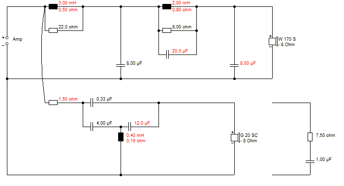

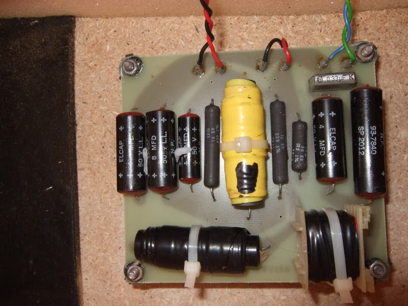

Now my question : as i am working on MLS1a clones, I am looking for the crossover configuration, do you have any information about it (layout and values) ?

I just had a dig in the basement archives. I think it's going to be quite a serious crossover, like the BBC LS3/5A.
I don't even know what half the values were on the bigger MLS4, but a notched 4th order bass and the KEF Acoustic Butterworth 3rd order tweeter quite likely.
In practise you'd just renew the NP capacitors and hope for the best.
I wouldn't clone it. Just do something similar like this:

Thank you Steve,
The reason why i want to clone the MLS1a is that i have the speakers waiting to be used. 🙂
I know there is more modern designs available, with probably better results, but i think Audiomasters are very relaxing speakers to listen to, for example when doing other things than just listening.
Of course, these wil not be the only speakers i own, just a second (or third, but don't tell my wife !) system .
And after all, is diy main mean to be reasonnable ? I enjoy to test, tweak, change components value, just to hear "what is changing", a kind of learning about speaker building.
