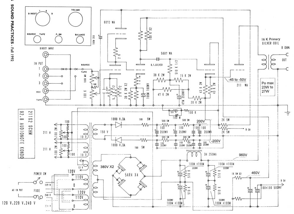

hi,
spec was same as the schmatic in internet.
several of my friends try already & now I will try the 10K OPT first with 6N 4 layers polyurthane with secondary was 5N monocrystalline polyurthane coat wire.
internet circuit was use 16K, but I was afraid 16K cannot use below 1000V had 27W output. I will prepare two OPT to test.

tube-lover said:hi,
I've seen several schematics of the ongaku but they aren't very clear.
any chance you can share your copy?
thank you.
thank you.
this one?
I looked at the schematic and I'm confused with the tubes.
I assumed:
1. the tubes on top of each are 6072
2. the middle tube is a 5687
3. lastly, what are those to tubes besides each other that's at the output? one of them I would assume would be a 211. what's the other?
I assumed:
jarthel said:I looked at the schematic and I'm confused with the tubes.
I assumed:
1. two triode systems on input (SRPP) are within one 6072 envelope
2.first half of 5687
3. second half of 5687 is cathode follower for mighty 211,which is output (end tube)
