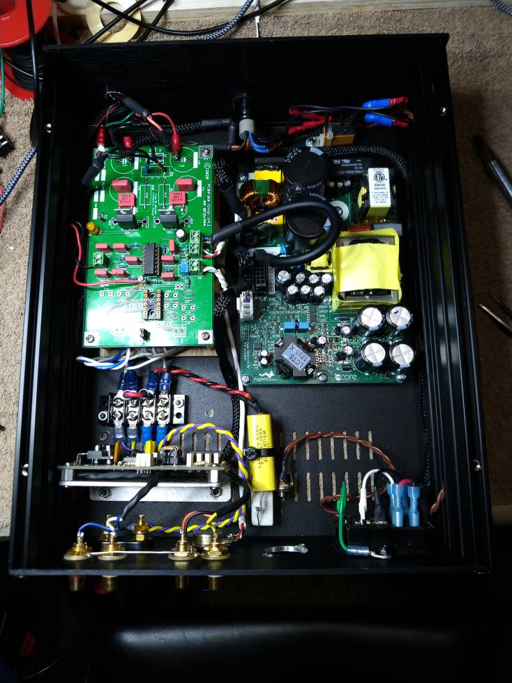

In my setup, I have a passive subwoofer cabinet, fed by a full range amplifier, which is fed by a DAC. The low-pass filtering is done on a mono mix of the stereo input, through a Linkwitz-Riley crossover (low output only - my full range speakers are still full range, not high-pass), and the final signal is dithered before the 24-bit DAC to hopefully remove truncation noise. The catch here is that any harmonic distortion in the power amplifier will be passed to the subwoofer driver without any low-pass filtering.

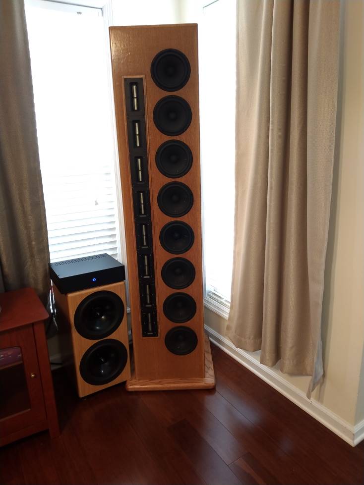

Its also not always a driver problem. Instead of 1 big driver with lots of problems i use 2 smaller ones with their own amps and this way you can also fight distortion.

If there is one place where amps just need to give clean but enough power it's on subs, and that is where class D (when done right) shines. The main thing is enough power, and a psu that can follow so you don't get sagging or distortion because the psu runs out of steam. Class A or AB have no advantage here in any way (but will work also when powerfull enough).
Tube amps can give some extra, but it's very subjective if that is good or not. But a Hypex Ncore or their (Ncore) Fusion plate amps are objectivly probally one of the best choices now, except if you like the tube sound or when you need more power.
