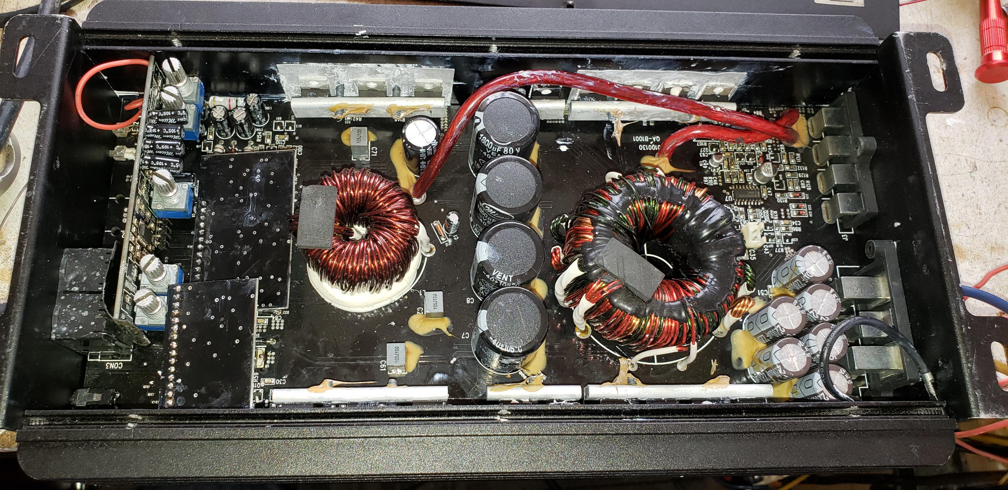

This amp was in protect. Changed outputs and the amp comes on but seeing -1.5v on output terminals without signal. When signal given it is still having same -1.6v but when I increase the gain until it clip the voltage disappears (with no load).

Amp running cool and no drawing of high current. Checked small transistors on mainboard and all look normal.

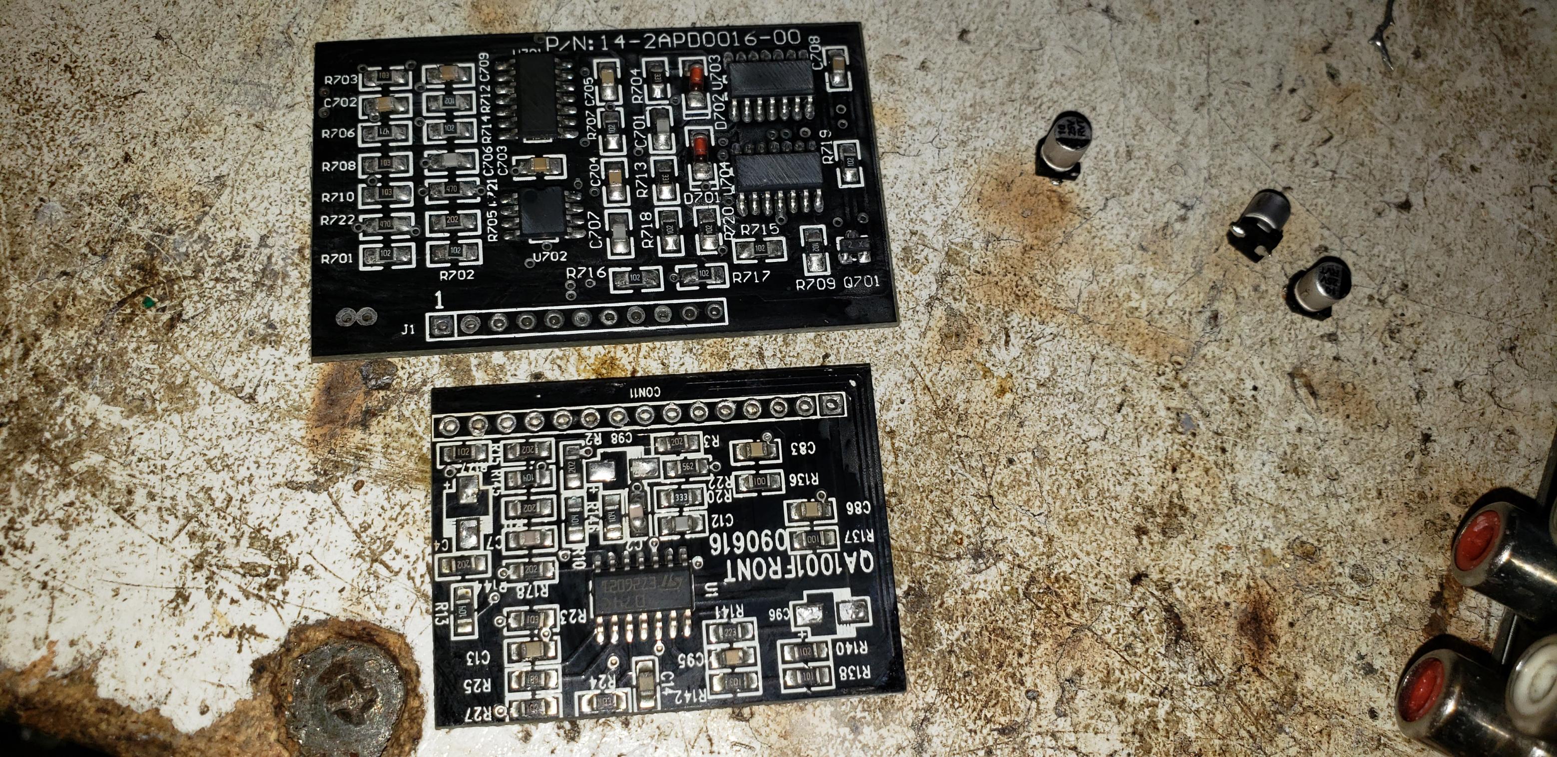

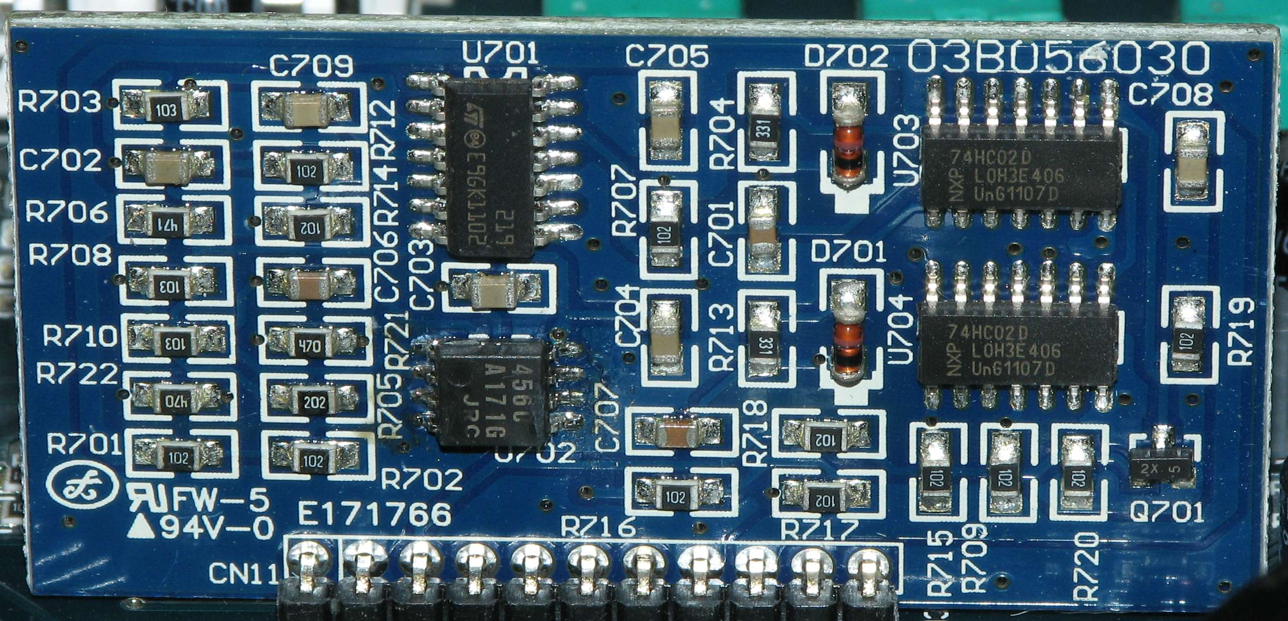

It is not going to zero, I getting voltage like 0.5v. But suddenly it blew the outputs. There is some problem. Oscillations are all good without input. But once signal is given it goes into protect. Some times as I increase gain it goes to protect. I dont know what ic the driver board is using for me to change and try. 4 ic are in driver board I guess is opamp.
