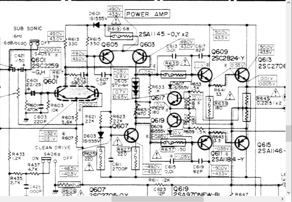

Hi all; I have my Dad's old Aurex SB-66 integrated amp built by Toshiba. Do any of you have the exact model? I am blowing the main fuse on the AC input; 5 Amp, 250 Volt. I suspect I may have fried one or more output transistors. Have any of you had this problem with this amplifier? I think I'll order all new output AND driver transistors just to be sure; I think replacements are all still available at just a few bucks a piece? There is one very long finned aluminum heatsink; I haven't looked closely yet; I wonder if I can get the transistors out by themselves or do I need to remove the entire heatsink assembly? Anybody already been down this road on this model? I'm hoping for a few tips and short-cuts here! The first thing I will attempt is to unsolder all driver and output transistors (removing them from the circuit) then see if the fuse still blows. (If it does; that means I'll have to do some honest troubleshooting instead of the quick and dirty just replacing the most suspect parts; something I'd like to avoid if possible!)

Yeah, we can't open a file on your hard drive. Is this it? Toshiba SB-66 - Manual - Stereo Integrated Amplifier - HiFi Engine.
I see a 2.0 Amp main fuse, not 5A. Start out by using your trusty ohmmeter and check for shorted output transistors.

OK, I found the outputs on one channel only shorted but am ordering all 4 output transistors anyway. I would order all 4 drivers also but they are much harder to come by. I took all 8 transistors out of the circuit to test them. (The correct service manual/schematic has the correct link someone did for me already so no reason for me to repeat it...thanks for that!).

I haven't looked at the circuit but if its like most amps then there will be some low value resistors connected to those output transistors, typically 0.5 ohm or lower. Check they haven't gone open or gone high in value.
Also set the bias trimmer to the position that gives minimum bias current before powerering on.

I think you may have a higher powered version of the SB-66. The schematic on HFE shows a 2 amp fuse and 50 volt rails. You indicate your unit has a 5 amp fuse and 70 volt rails.
You might want to double check the part number on those output transistors to be sure you are getting appropriate replacement parts. Wouldn't accept what is shown on the schematic.

Finally looked at the circuit...
I see there is no vbe multiplier, just one of those multi diode packages (STV-4H) which I believe can be troublesome generally. If one of the diodes developed a fault and caused the voltage across the package to rise then the bias current would shoot up and cause overheating. Any such issue may be very intermitent.
Also worth checking the bias preset as old examples can develop problems such as poor wiper contact and intermitent/poor connection of the resistive track to the end terminal pins.
When you power up make sure to begin with the preset on minimum resistance. This will minimise initial bias current.

I confirmed the part numbers on the transistors match the schematic. I have the Japan ONLY model; the schematic is for international. It's possible they made changes; my unit is "AUREX" which is supposedly a higher end Toshiba. Kind of like Acura is a higher end Honda I suppose!

Thanks again; I have been doing some reading on setting bias in class A/B circuits since my last class in amplifiers was probably 1976 or so! The 1st page of the service manual gives us the answer here. I cleaned the trim pots then set them at their mid-points per the manual. If you look at the Emitter resistors; you will see they are 0.22 Ohm. The manual says to make sure bias current is below 30 mA after the unit has been on for 60 seconds. There are test points for this. Check me out on this: if I measure 6.6 mVolts across the test points this means I have 6.6 mV divided by 0.22 Ohms equals 30 mAmps. Without an O'scope; I won't be able to look at the "crossover" region. I remember setting the bias on my Yamaha receiver after changing output transistors YEARS ago. I didn't even have a DMM so I set the trim pots at mid-point. I then listened carefully to some very familiar recordings (amp. set on mono, 1 channel at a time) and carefully adjusted the bias pot. I just kept doing this over and over again until I obtained the "best" sound quality (indicating I had the bias about right and that the crossover distortion was "minimized"). What I DON"T know here is what range of bias adjustment these trim pots are designed to cover or allow. There is a voltage divider network in conjunction with the trim pots so I'm thinking and hoping the adjustment range is purposely limited by the divider. Regardless; I will slowly and carefully adjust these trimmers. I plan on leaving the amp on for several hours playing music and possibly tweaking the bias allowing for the new transistors to have some "break-in" time. No point in putting the covers back on for a few days just to make sure all is well!
Modern semiconductors can have slightly different 'turn on' voltages (Vbe) compared to the original parts due to differences in production and doping processes.
I would definitely begin with the preset on minimum resistance which means that R629 is effectively shorted out. That gives the lowest voltage possible between the base of the two driver transistors and consequently the lowest achievable bias current. Only if all is well should you then attempt to set a bias current.
(You have four base/emitter junctions to bias on before any current flows. These are the two output transistors and the two drivers and each will need around 500mv to 650mv approximately to do this. The diode chain provides three such multiples (so around 1.5 to 1.95 volts) and the series resistance (and preset) increase that further. Remember a difference of only a few millivolts is enough to go from non conducting to fully on for a transistor and this is why the circuit is a little critical on semiconductor types)
Using ohms law is the standard way to derive the figure and as you say 6.6 mv would equal 30 milliamp. Be sure to have no speakers attached when setting this as any slight DC offset totally skews the result due to DC current flowing in the speaker coil.
The trimmer should allow for control down to zero and upward to perhaps a few hundred milliamps. It is normal for the reading to vary wildly with temperature as the unit stabilises. Don't be tempted to go higher thinking it will sound better... it won't. Anything over a milliamp or so is enough to remove all audible distortion and so play safe when setting the current.
