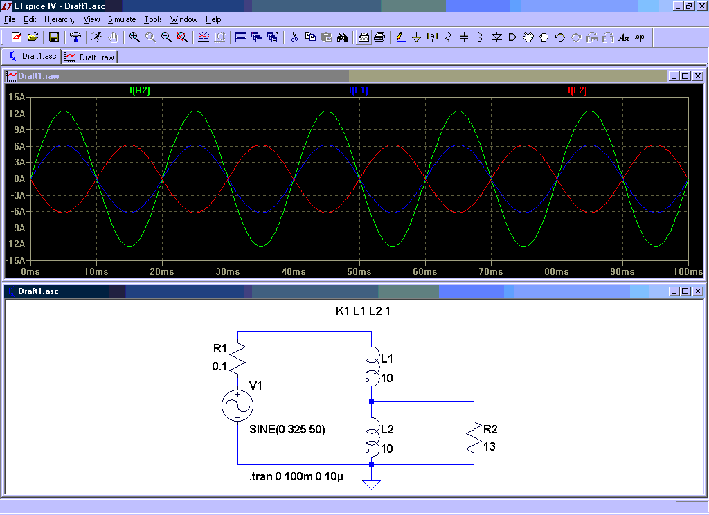

There is nothing to explain:
This would be the situation for independent inductors; when they are coupled, the current have the right phase to add at the tap terminal.
See the simulation of a typical 230-->115v autoformer:
How can a winding that all goes in the "same" direction pass currents in opposite phase to the output?

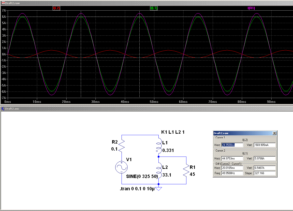

I'm beginning to understand the 2:1 auto T.
Could you simulate a 11:10 auto T for me/others? i.e. tappings at 0Vac, 200Vac, 220Vac.
Here is the simulation for an 11-->10 Xformer:I'm beginning to understand the 2:1 auto T.
that makes sense, but the big thing I did not appreciate was that the 220V tapping supplies reverse current that adds to the 20V tapping to give the total output current.
You can see in this example that the low voltage tapping carries ~10times the current of the high voltage tapping and that L1 will need ~10times the copper area.
The 220V tapping and it's current approximately determine the VA rating of the main winding and of the core.
