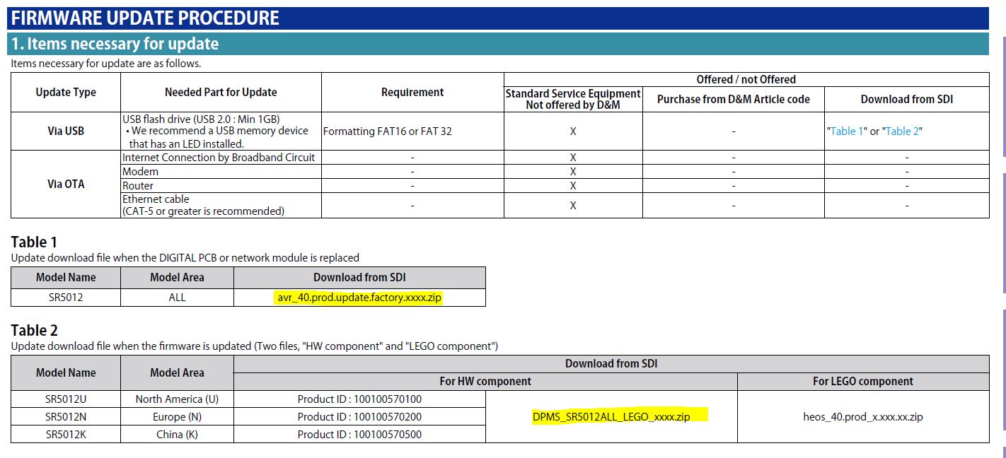

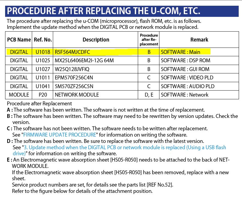

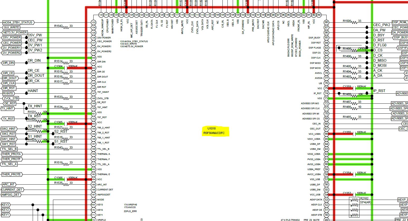

I have a DENON AVR-X3400H failure microprocessor
According to the service manual, after changing the chip, the main software needs to be loaded, but there is no information on how to do it.
