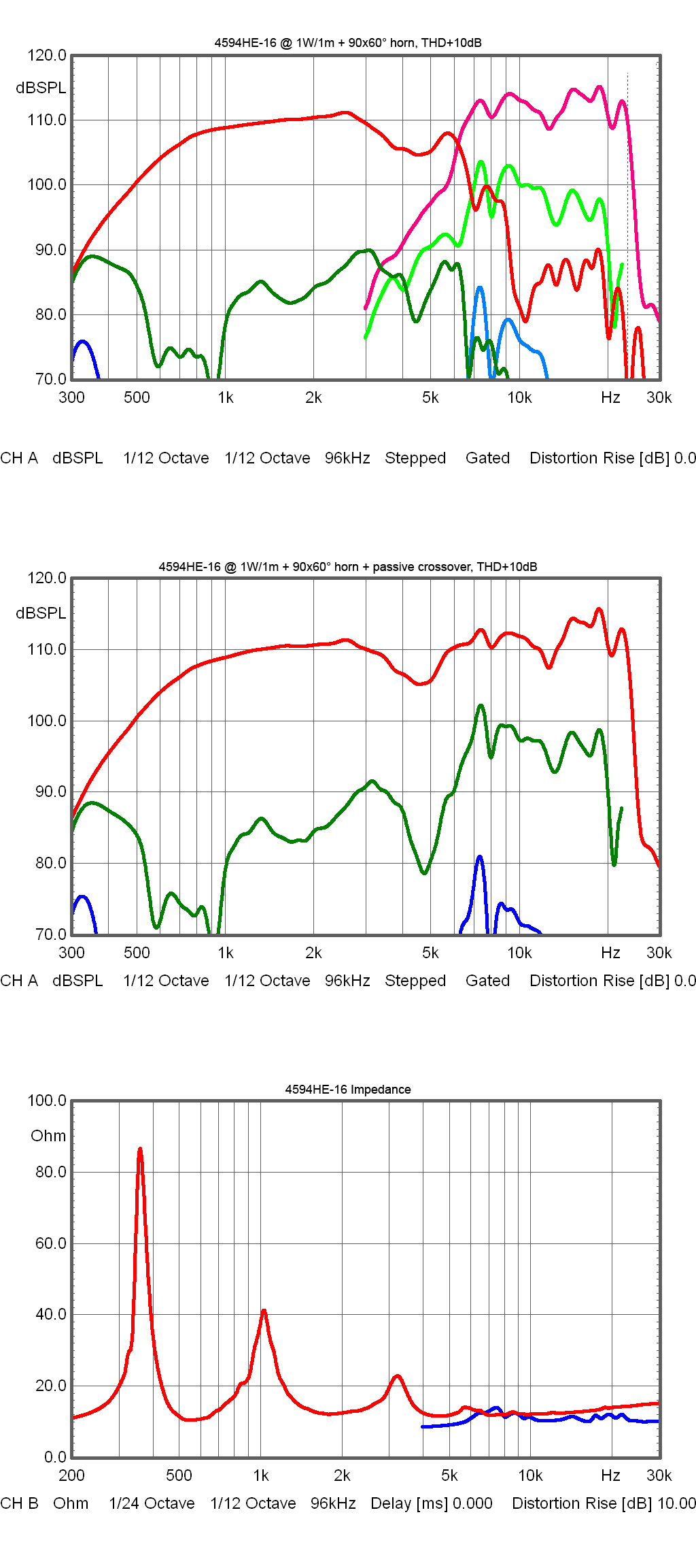

Looking at the impedance graphs for both the BMS 4594HE and the B&C DCX464, it seems that the B&C has a lower Fs than the BMS - actually around 250 Hz, which means that that on the 'right' horn and for hifi-use, the B&C may load down close to 200 Hz which would make it a lot easier to integrate to woofers

The overlap between the mid and high diaphragm is a key feature of the B&C and the impedance peak is about 100Hz lower.
BMS 4594HE:
B&C DCX464:
Impedance:
BMS 4594HE:
![bms_4594he_curves.jpg](/community/proxy.php?image=http%3A%2F%2Fwww.bmsspeakers.com%2Ffileadmin%2Fbms-data%2Fcurves_compression%2Fhe_drivers%2Fbms_4594he_curves.jpg&hash=27a7b1fd5ba2d1544db281ecdb3f4b7a)
