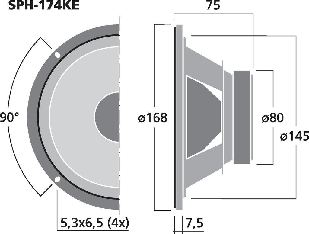

If I read you correctly, you are seeking to replace the Monacor SPW-165/4 with a 165 mm mid/bass driver suited to the B&W's sealed enclosure.
You need a driver with a Qts between 0.4 and 0.7 and the universal Monacor SPH-174KE fits that bill at 0.51 if your enclosure can accept its dimensions.
https://www.monacor.com/products/components/speaker-technology/hi-fi-midrange-speakers-/sph-174ke/
That's the ball rolling. The experts may be able to suggest a driver having the maximum compatibility.

As I read it, you currently have Monacor SPW-165/4 which I suggest replacing with Monacor SPH-174KE - if they fit.
Am I wrong?
what values should I look into besides ohm and size?
Qts as I mentioned. Sensitivity should be a good match (as in the case of my suggestion). The loudspeaker design experts may be able to comment on the driver's Vas in relation to the enclosure volume.
What is your budget as that may determine your choice of replacements?
...not sure if they were the correct ones.
The Monacor SPW-165/4 may have been more suitable for a ported enclosure. You need drivers suitable for a sealed enclosure.
Sorry, I notice that my recommended replacements are 8 ohm and not 4 ohm.
That difference could be adjusted for in the crossover, but we should look out for a suitable 4 ohm alternative with the appropriate sensitivity and Qts.
