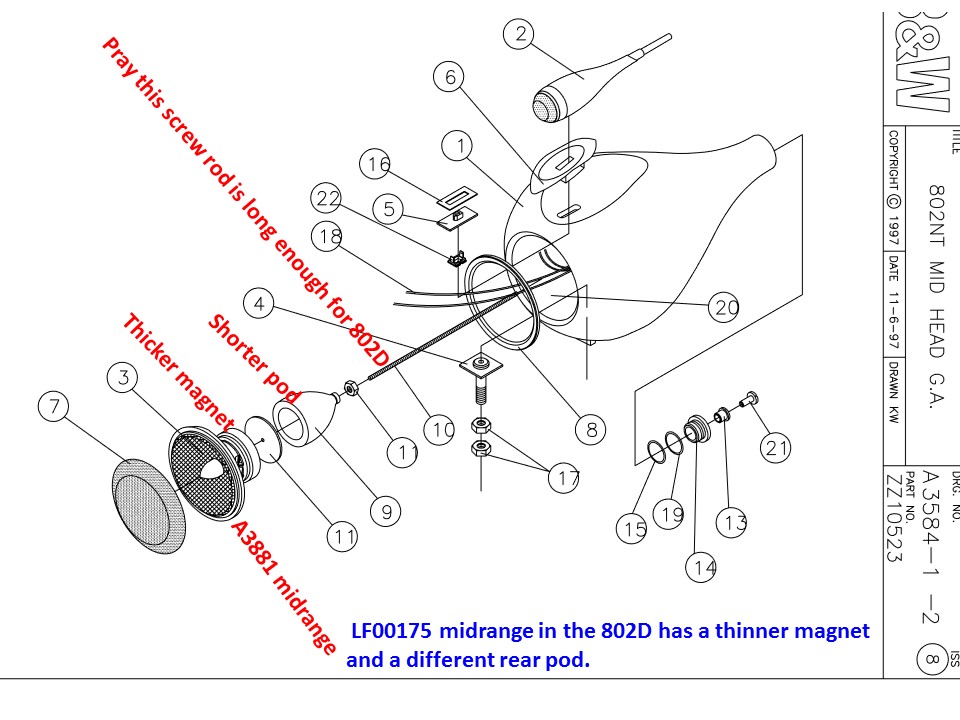

Hi i need some help,, i need to cange the middrange speakers on my 802N
I found a sett middrange speakers For 802D on a web site for sale..
Does they fit directly in my 802N or do i have to make som changes ?

B&W stopped manufacturing the FST in the 802N series in 2005, after a 7 year run.
B&W redesigned the FST midrange for the 802D and changed the cone construction, voice coil venting, and the T/S parameters to support the 3kHz crossover to the diamond tweeter. New part number.

The midrange driver plus a rear frame rubber gasket plus an aerodynamic rear-magnet pod are "pulled" onto the oval cabinet by a long "draw bar" screw rod which goes all the way to the rear vent hole. There are no other front frame mounting screws.
The A3881 midrange from your 802N is not an exact physical match to the LF00175 midrange in the 802D.
Your 802N A3881 has a thicker magnet and shorter pod casting than the 802D LF00175.
With some luck, the screw rod has enough extra threads to reach the shorter LF00175 midrange used on the 802D.
The LF00175 midrange used on the 802D also uses a different crossover circuit.

i thought they share same HH11444 drawbar and isolator gasket, new diamond has different part no for drawbar

thats m6 thread, threaded rod from local hardware store if problems

In the 1997 document: The 802N uses a HH10054 drawbar screw rod.
In the 2004 document: The 802D uses a HH11444 drawbar screw-rod.
They are probably close enough in length such that B&W now only stocks the newer/longer HH11444 part. It is good news that they are interchangable.
The different crossover circuits used in the newer 802D is the main switich-over issue.

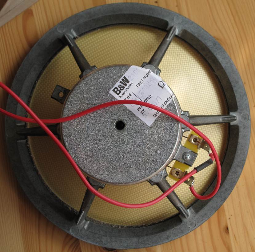

Still havent heard what happened, is it burned coil (infinite ohm) or distorting speaker.
If its distorting speaker, turn phase plug off, turn slice of paper between voice coil and center piece. If theres debris between it should fall out cause ventilation is open on back.
I've done this couple of times
