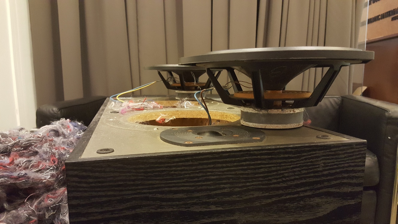

I have an older pair of these speakers and I'm having problems with the crossover...

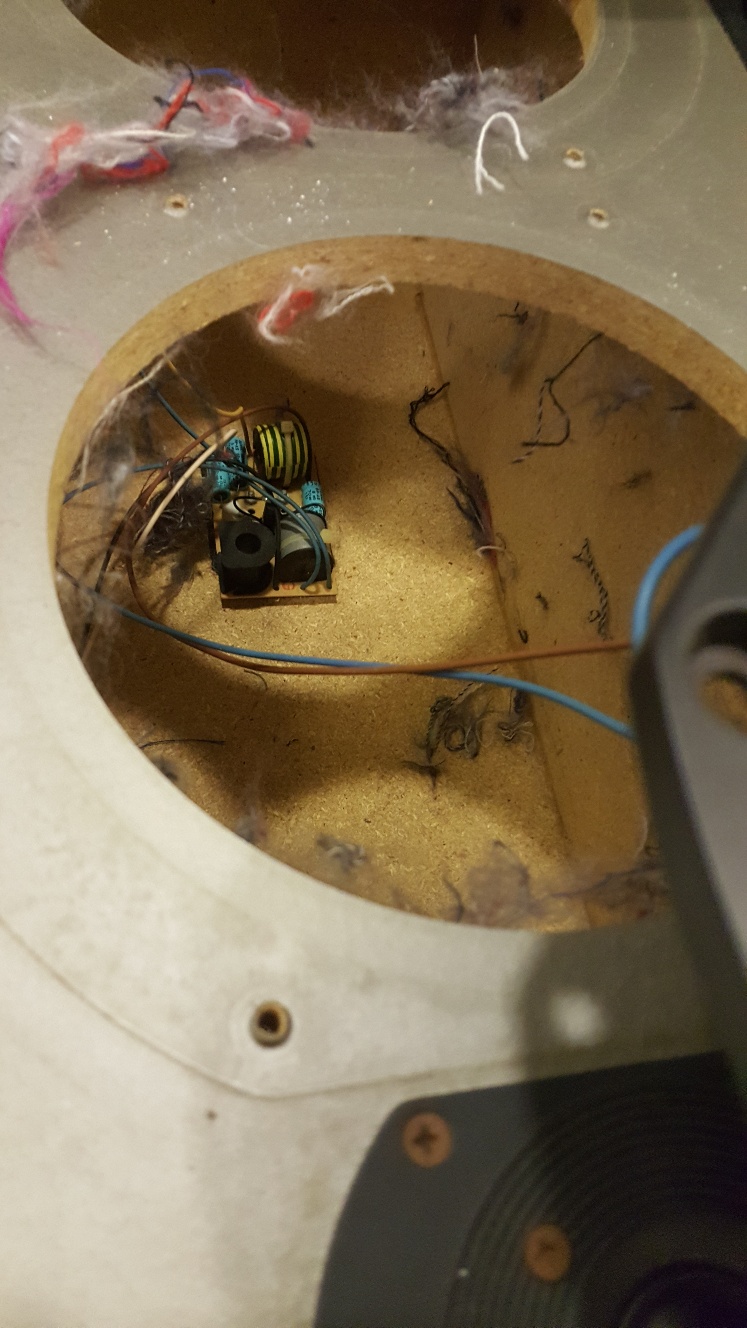

It seems the resistor caught fire on both speakers and burnt one of the coils to a crisp.
Everything else measures ok, including the drivers thankfully, but the one coil and the resistor are toast. I believe it is the coil in the hi pass section of the crossover.
I can see the resistor is a 2.2 ohm but the coil is not measureable.
Would anyone have a schematic for this speaker that I can get the coil value so I can roll my own or order a new one?

Cliff, thank you so much for that!
It is EXACTLY what I was looking for...
I didn't think there would be much info on these speakers on this sight so admitedly, I didn't do a search. I'll know better next time.
The value of that one coil is what I was looking for and I can see from the diagram you have done that it is a .2mH inductor. I couldn't measure mine as it is a crumbling burnt mess! 😉
