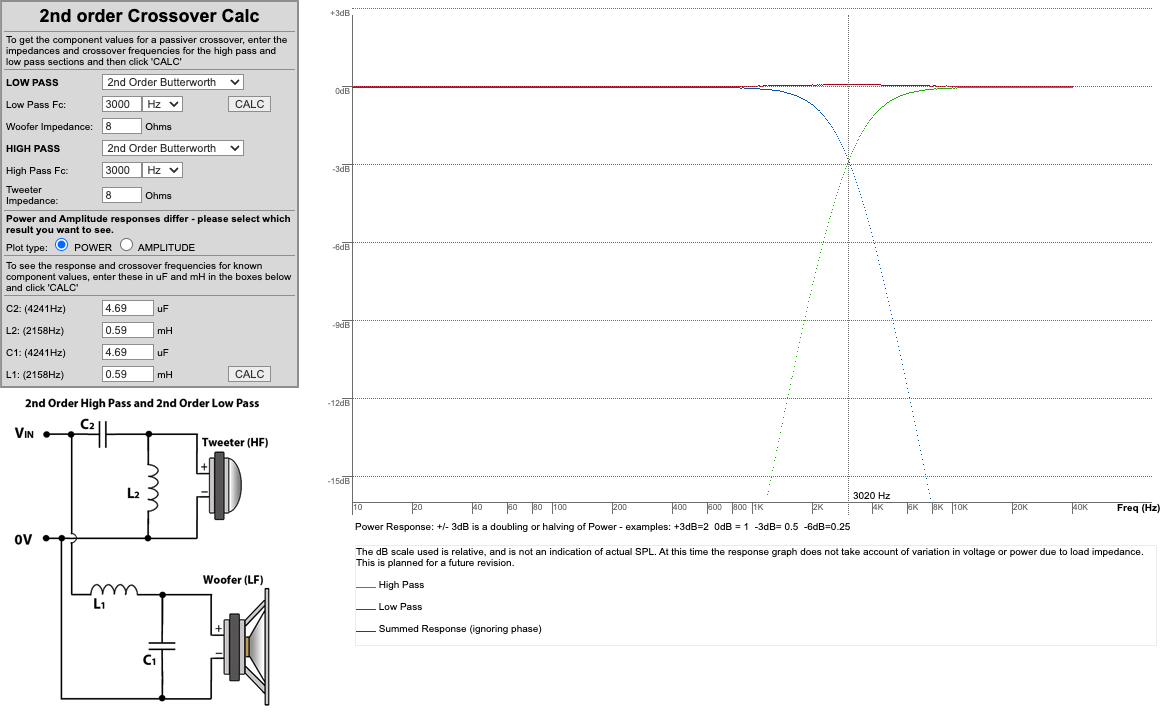

actually, if I use this calculator: https://speakerwizard.co.uk/calcs/Crossover_Calc_v2.php
then here are suggested values

As AllenB said, a crossover redesign could be useful. However this imply (a lot of) experience. So I'd not recommend it.
The whole idea that swapping components with "better" ones will result in an upgrade is debatable, to say the least. In my opinion, is rubbish.
What you can do is to get out the crossover and simply replace all the electrolytic caps (if there are any) with equivalent ones, as the old caps are probably dried. Other components (film caps, resistors, coils), should be kept unaltered. The reason to replace electrolytic with electrolytic is that different kind of caps have different ESR (sometimes very different), and a competent designer like the ones at B&W will design a crossover taking care of the capacitor ESR. So replacing an electrolytic with a film cap is a downgrade, as you'll alter the frequency response of the speaker.
A last word about the crossover calculators/textbook crossovers. They simply don't work because they assume a constant resistance and flat frequency response over a large region around the crossover point. A real driver however has impedance that varies with frequency, and usually also the frequency response is all but flat near the crossover point.

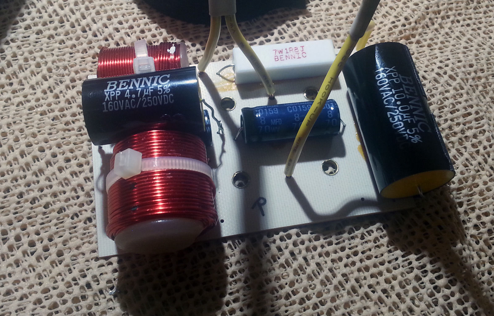

Galu this is image from Internet I have found, showing crossover after upgrade 🙂
I took that image from the diyAudio swap meet thread you linked to in post #1.
Sorry, that indeed showed an "upgraded" crossover.
However, the only information given was, "Modifications include 5% polypropylene audio capacitors with high quality ultra pure solid copper wiring."
Just to emphasise what giralfino said, when B&W designed the crossover for the DM305 they did not use a simple crossover calculator like the one you illustrated in post #7.
They used a much more sophisticated methodology to arrive at the component values that insured the optimum integration of woofer and tweeter.
Unless you are privy to their methods, you are best to limit yourself to replacing old bipolar electrolytic capacitors with fresh new ones, while leaving inductors and resistors well alone.

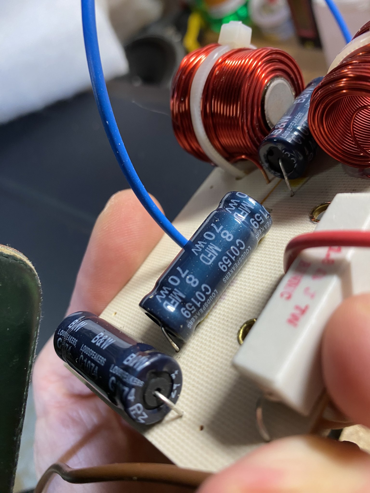

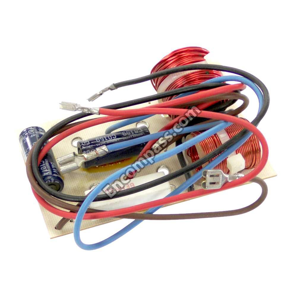

Yes, actually I have found this original oem part image
https://bowerswilkins.encompass.com/item/12592525/Bowers__Wilkins/ZZ10340/
Coil seems to be “air” core, so I will try to upgrade its capacitors only 🙂
For some reason, I am being blocked when I try to open that link. Can you paste an image instead?

Sure, here it is 🙂
There are only two capacitors visible in that image rather than three in the upgrade image - and their values are not readable.
Let's wait and see what you find when you actually take your crossover out of the enclosure.
