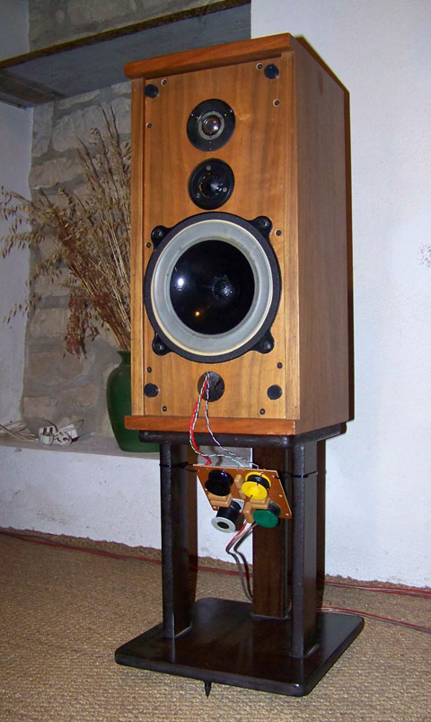

I bought some second hand B&W DM4s (early 1970s) which have very good mid/low frequency reproduction but have lost their high frequency performance (muffled/reduced cymbals, guitar string scratch, speech sibilance, amplifier hiss etc) compaired to the fantastic top end I remember hearing on others (the reason for buying them!). The high frequency drive units (Coles 4001 & Celestion HF1300) are producing sound in their appropriate frequency ranges, ie they are functioning & not blown. Have applied frequency sweep to speaker inputs & viewed signals with scope through xovers to drive unit contacts and appropriate signals appear at the drive units. Can the drivers themselves lose their upper frequency performance over time (diaphram gets brittle etc)? I replaced the HF1300s with a second hand set bought off ebay with no marked difference so either they have the same problem or its the 4001s or xovers. Could the capacitors in the xovers have aged? they appear to be good quality polypropylene film not electolytic. The diaphrams on the 4001s look OK, no cracks etc. I see you can get replacement diaphrams but the coil wires are very fine & I'm not sure I'd like to take a soldering iron to them. I see you can pick up DM4s on ebay for ~£100 so not sure if buying new 4001s at £45 each is worth the punt!
I have tried connecting both types of driver in place of the Trio tweeters in some old Trio (Kenwood) LS-202s and they are not nearly as good at the top end as the orginal Trios (this may not be particularly valid as the Trios are 4ohm on a much more basic x-over).
I might try experimenting with shorting out coils & capacitors in the xover but dont want to damage the drivers by putting too low frequencies up them, so advice on this appreciated.
Any thoughts?

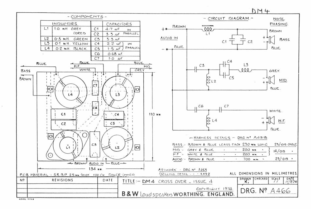

Be worth measuring the DC resistance of the HF1300 and 4001 units. 8 or 16ohms? Maybe they have been clumsily replaced. The DM4 crossover looks like a 16 ohm one to me.
The HF1300 used by B&W was a 15-16 ohm driver, and the Coles 4001 was "21 ohms".

That schematic is useful. B&W and myself must be the only people in the World who aren't secretive about schematics. 😀

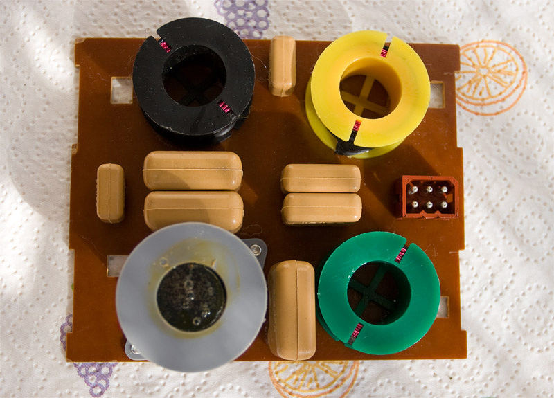

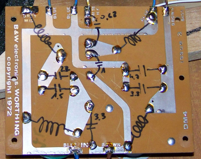

There is no point in replacing any of the crossover components, polycarb cap's don't age like electrolytics.

I wouldn't bet my life on polycarbs or polyesters being immune to age. 🙂
It's cheap enough to replace parallel C4 and C5 with a new polypropylene 3.9uF for instance. After all these are just plastic films with a few atoms thick of corrosible aluminium. Aluminium turns to oxide faster than almost anything else, being a lively alkaline earth.

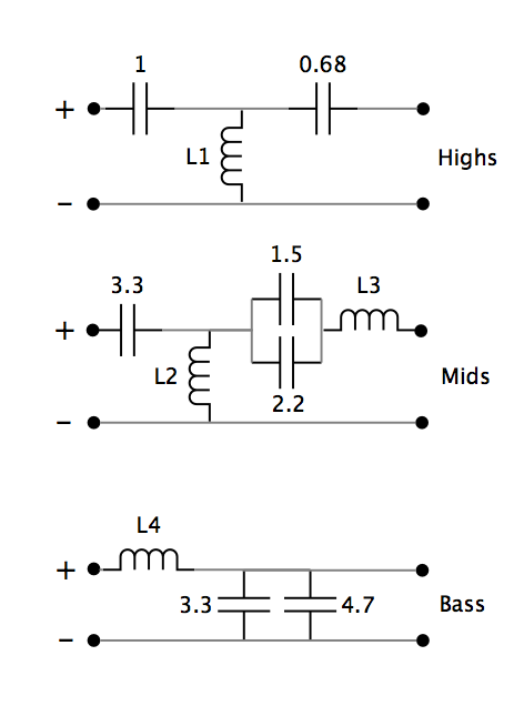

Interesting experiments tonight;
Firstly used more powerful amp, Cyrus One, no real difference, still poor high frequencies. Amplifier miss matching theory out the window.

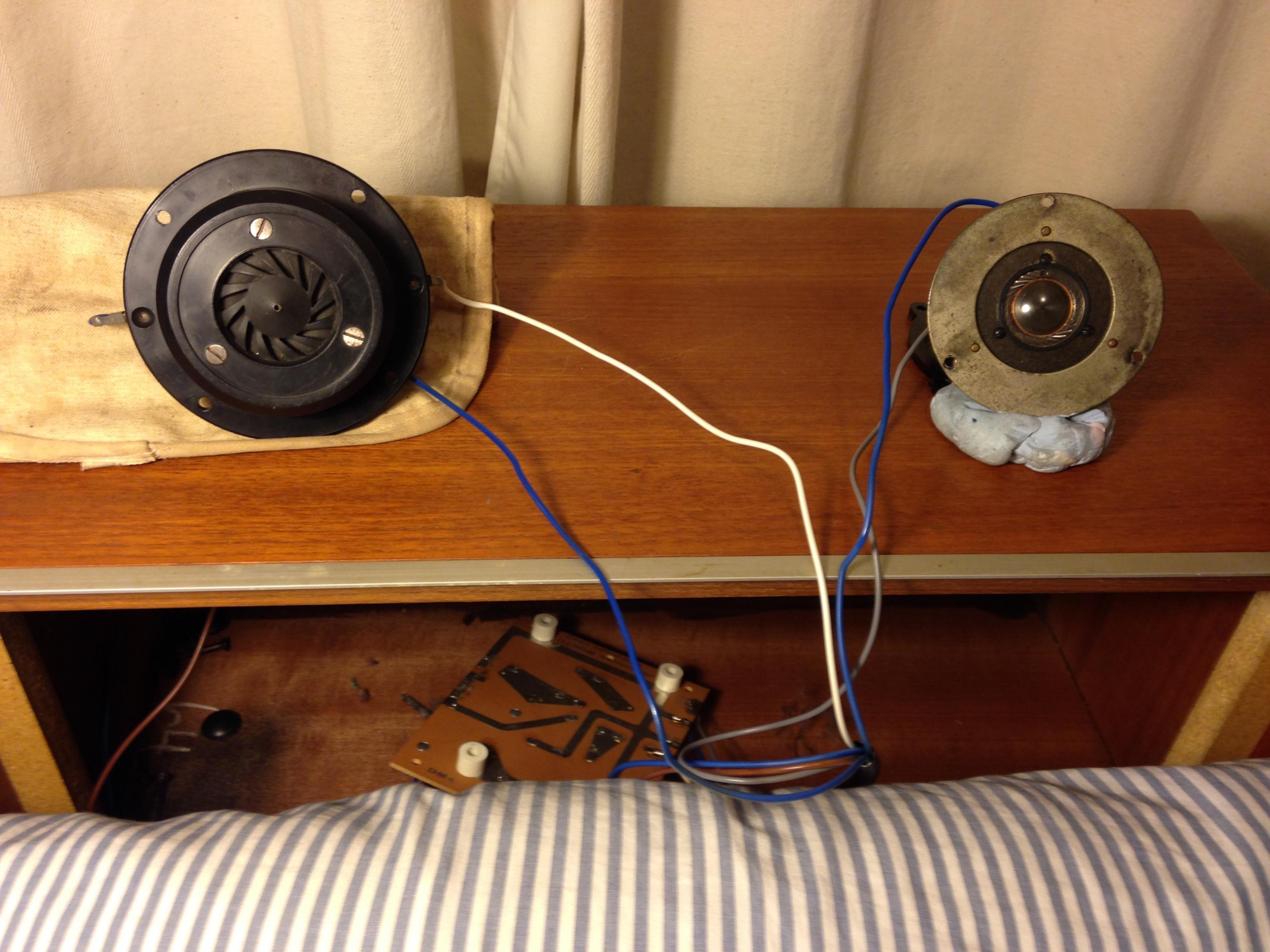

Second, swapped white & grey driver leads round on the 2 tweeters to change the xover/driver relationships (see attached photo), big difference, now the 4001 output is louder than the HF1300 (whereas normally the HF1300 is much much louder than the 4001, which is barely audible) So looks like the 4001s are working OK, when driven from the mid filter output. The HF1300 is quieter but definitely louder than the 4001s were when connected to the hi filter. Looks like the HF1300 is more efficient at utilising the signal from the hi filter
The HF1300 is now reproducing the higher frequencies due to being connected to the hi filter, but I guess not as well as the 4001 would if working properly as the HF1300 rolls off at 13-15kHz I think.
Now I think the overall hi frequency sound is better too, comparable to the Trio (will need to get the 14 year old ears to check tomorrow!)
Not quite sure what to make of this, it suggests to me that the hi filter is not matched correctly with either of the tweeters somehow. Cant be the coils, may be the capacitors attenuating somehow?
Investigate further tomorrow....
Beg, buy, borrow a capacitance meter (they aren't expensive these days) and measure the caps. You will have to remove them from the pcb to do this properly. I wouldn't recommend leaving the HF1300 and the 4001 swapped for long. You may do the 4001 in. I wouldn't expect much audible o/p from the 4001 in normal operation. Most of us can't hear much above 14khz anyhow. If the caps are out of tolerance buy some inexpensive polyprops to start with. If this cures the problem you can go with more upmarket ones if you wish. Were the HF1300s you bought new? They may be down on o/p also if they are the same age as yours.
