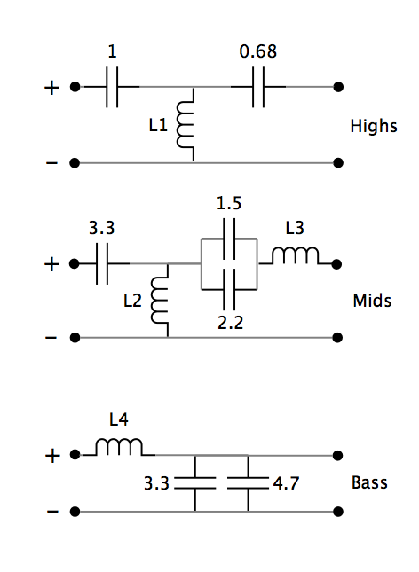

I have a pair of old 1972 B&W DM4 speakers. They are in fairly good condition, but I would like to rebuild the xover. The inscriptions on the caps and coils in the original filter are gone over time...
Does anyone have a schematic of this three way filter? Or a clue where I could find it?

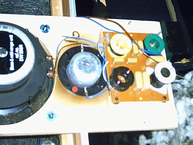

Hi Zeno

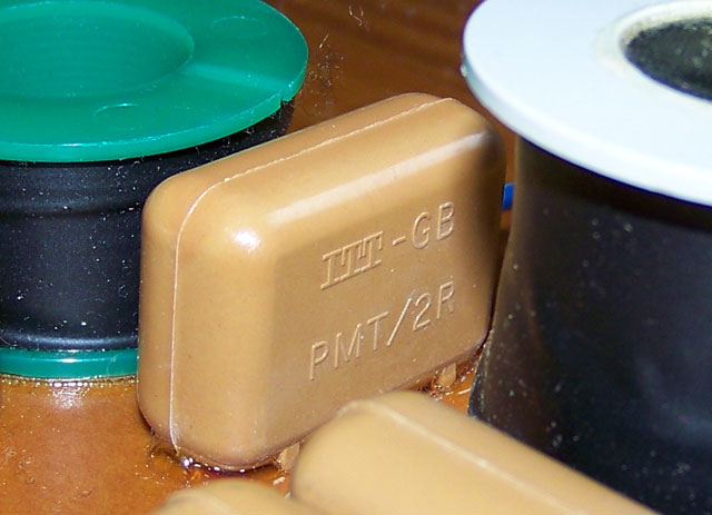

This is a photo of my dm4 xover.
Pls pardon photo quality
Caps vaues left to right are as follows
Between yellow and green coil- 2.2uF on left 1.5uF on right
Row of 3 caps 1uF on left 0.68uF in middle and 3.3uf to right
Between black and white coils- 4.7uf on left 3.3uF on right
Caps have values molded onto them and appear to be 100volt
All coils appear to have no values marked –sorry
As to sound- very musical indeed- not bad for their vintage-probably still better than most consumer cr*p around these days- purchased at 2nd hand store- had to replace surrounds to woofers.
Hope this helps – pls let me know if I can add any further info.

Hi Georg a,
I checked the filter in my DM4's. They are screwed on the back of the speaker, identical to the xover on your picture. Is the xover in your DM4's sitting on the back of the baffle?
I noticed that the plastic domes of the so called 'super tweeter' are both damaged. They have a crack running almost entirely through the dome. I guess they have become brittle over the years and did not survive uninteded touching ...

Hi Zeno
Yes PCB on back of front baffle, super tweeter under pcb in photo.
SAd to hear your tweetes damaged.
I know how good this unit can sound, dont know if you can still get replacement units - pehaps try wilmslow audio in UK ..?

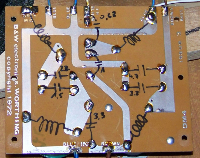

I believe the supertweeters are Coles (STC) 4001, still available
from Falcon Acoustics at reasonable prices, unlike Wilmslow.
http://www.falcon-acoustics.co.uk/pl28p10.htm
Personally in terms of rebuilding the crosover I'd just bypass
the Polyester film capacitors and solder all connections, but
you could repace the capacitors.
Replacing the coils is pointless.

Finally I've messed with my speakers, wondering if some ways may be found to push a bit the spl on the bass unit.
I've taken the XO out and tried to bypass the film caps with 1nF Téflon, highs sparkle like never, so clean! But as they are more readable the bass is lacking even more...
Here are some pics, XO included. The bass unit sounds more mid-high bass than bass. (seems to cut around 3kHz, by ear).
Can a better coil (less resistive?) on the bass help a bit? Bypass of caps wouldn't harm, no spl issue here, isn't it?
All ideas are weclome, like split XO, solder parts in air and avoid any PCB? Stiffen the enclosure with second plywood layer on back/bottom, built an internal brace or such? Damping the steel frame of the bass? If it's free it's welcome 😉
