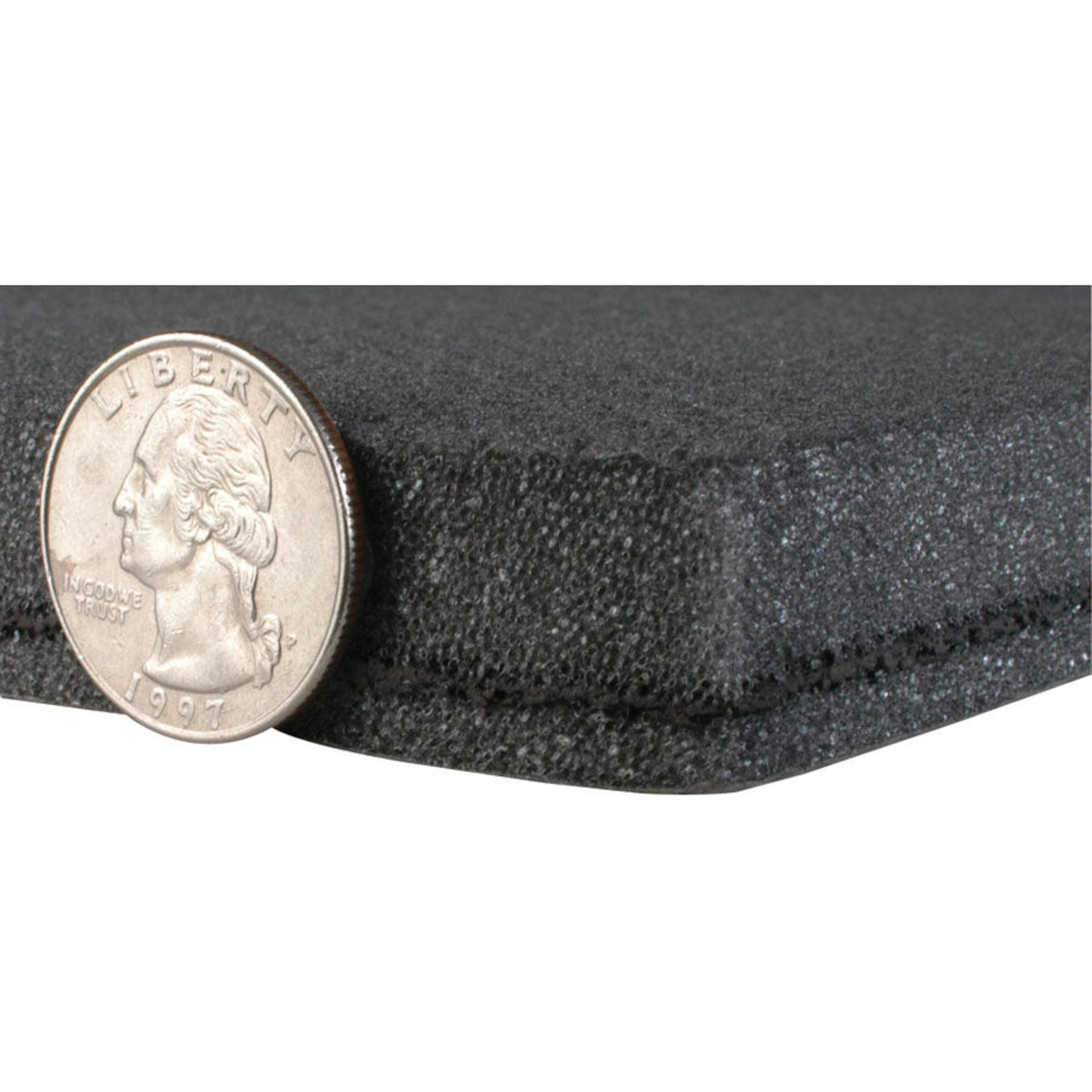

I wonder if replacing the internal cushioning foam with the Sonic Barrier sold at Parts Express would be an improvement.
Sonic Barrier 3/4" 3-Layer Acoustic Sound Damping Material with PSA 18" x 24"

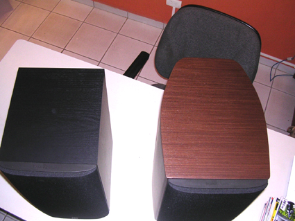

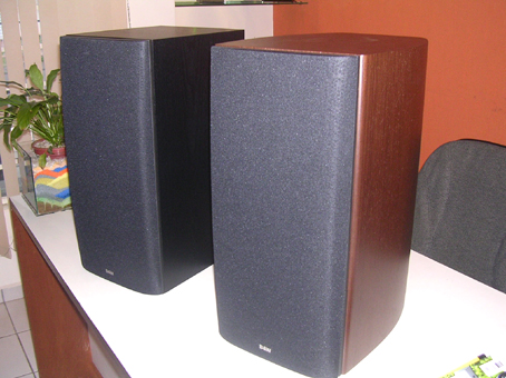

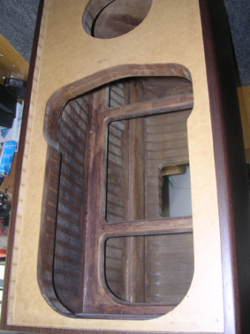

I show a modification of the BW DM602 S2 box made by someone in Brazil.
This is what I want to do in the future for my BW DM600 S1.

If you want to improve internal damping. Remove all the old stuff and first line with Noico mass loaded butyl (foil covered) sheets to dampen high frequency resonances. Then cover that melamine foam pads (100 count 10cm x 6 x 2cm pads for $7 from China). That stuff has nano pores that absorb better than any other foam or felt. It’s same as BASF Basotect - as patent expired so now is cheap and plentiful. Use hot melt glue to install the foam.

The particle board isn't your problem and going with mdf will be disappointing unless you brace it extremely well.

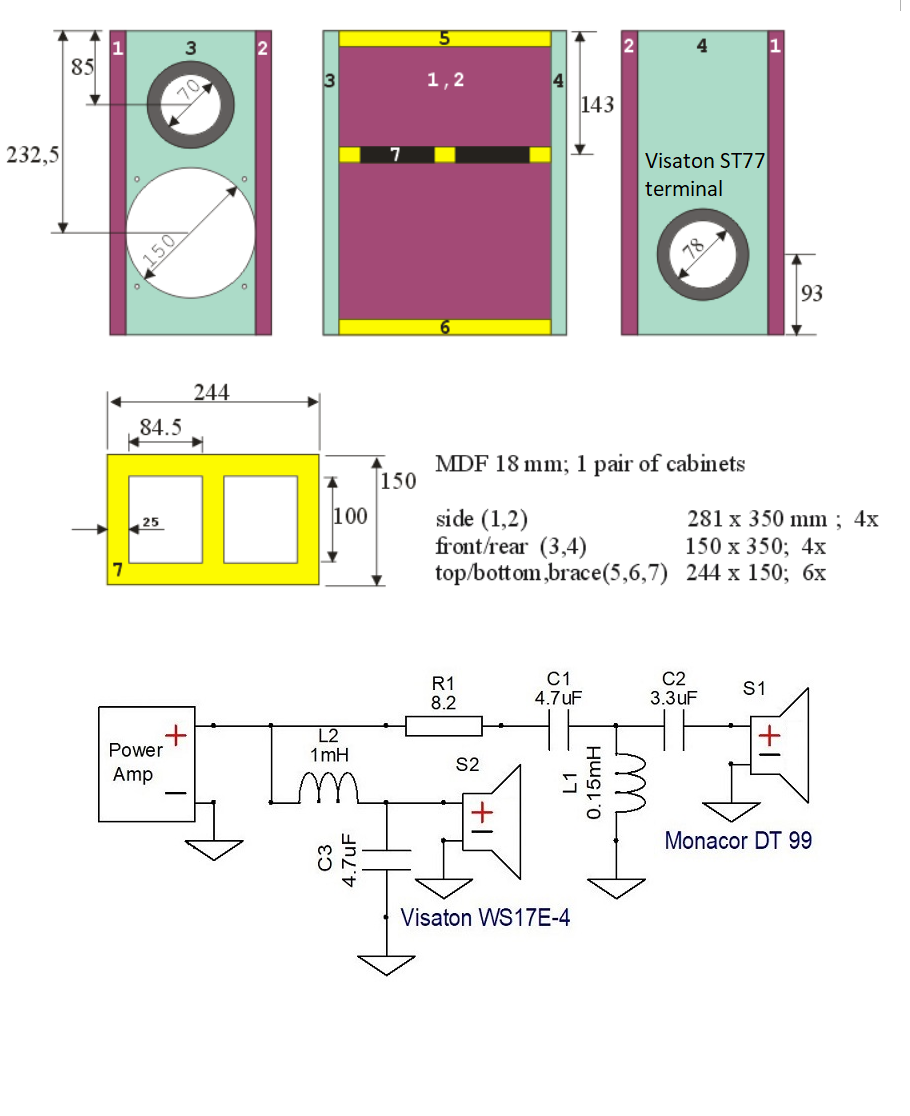

Without going into it too much, those old B&W speakers were overly bright at the top, decent enough in the bass, and prone to breakup from the 6" Kevlar bass. Generally got on your nerves after an hour. 🙄
Quick fix is probably to take the treble down a bit (by adding resistance) and go second order on the bass (by adding a 4.7uF capacitor);
Visaton-Monacor 2 way sealed simple loudspeaker build plans
Software | Visaton

My experience says it's positive polarity. I'd start with 2.2R on the tweeter and 4.7uF on the midbass. Rutcho may be taliking rubbish on phase/polarity. Who knows? I can hear it myself. But am a Classically trained musician. I can always hear Phasiness immediately. Sounds echoey. Imaging is all wrong.
But model it if in doubt. I gave you the tools. Worst that can happen is you swap two wires. On the bass if it is easier.

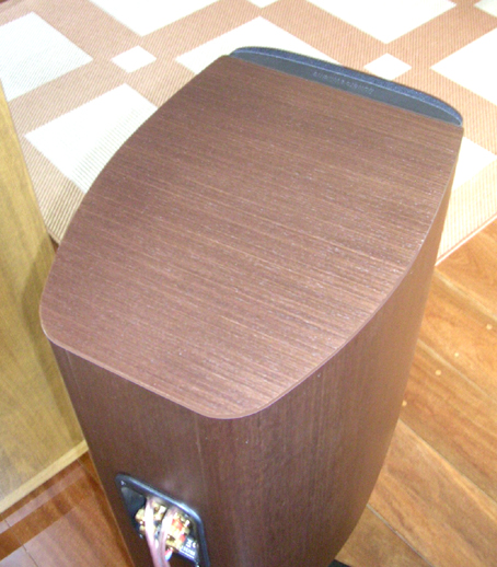

Yes, I can confirm, it belongs to my uncle's it is his project. Now it is a DM602 S3 with modified XO, it plays very good. I own an orginal DM602 S3 with modified XO, it plays very good, powerful bass but this modified case made the difference.I show a modification of the BW DM602 S2 box made by someone in Brazil.
Nicolaskwk, I'm glad to find someone who knows Zippang.
I always admired the B&W DM602 boxes made by him.
Would it be wrong if I ask you for a diagram with measurements of that box made by your uncle?
