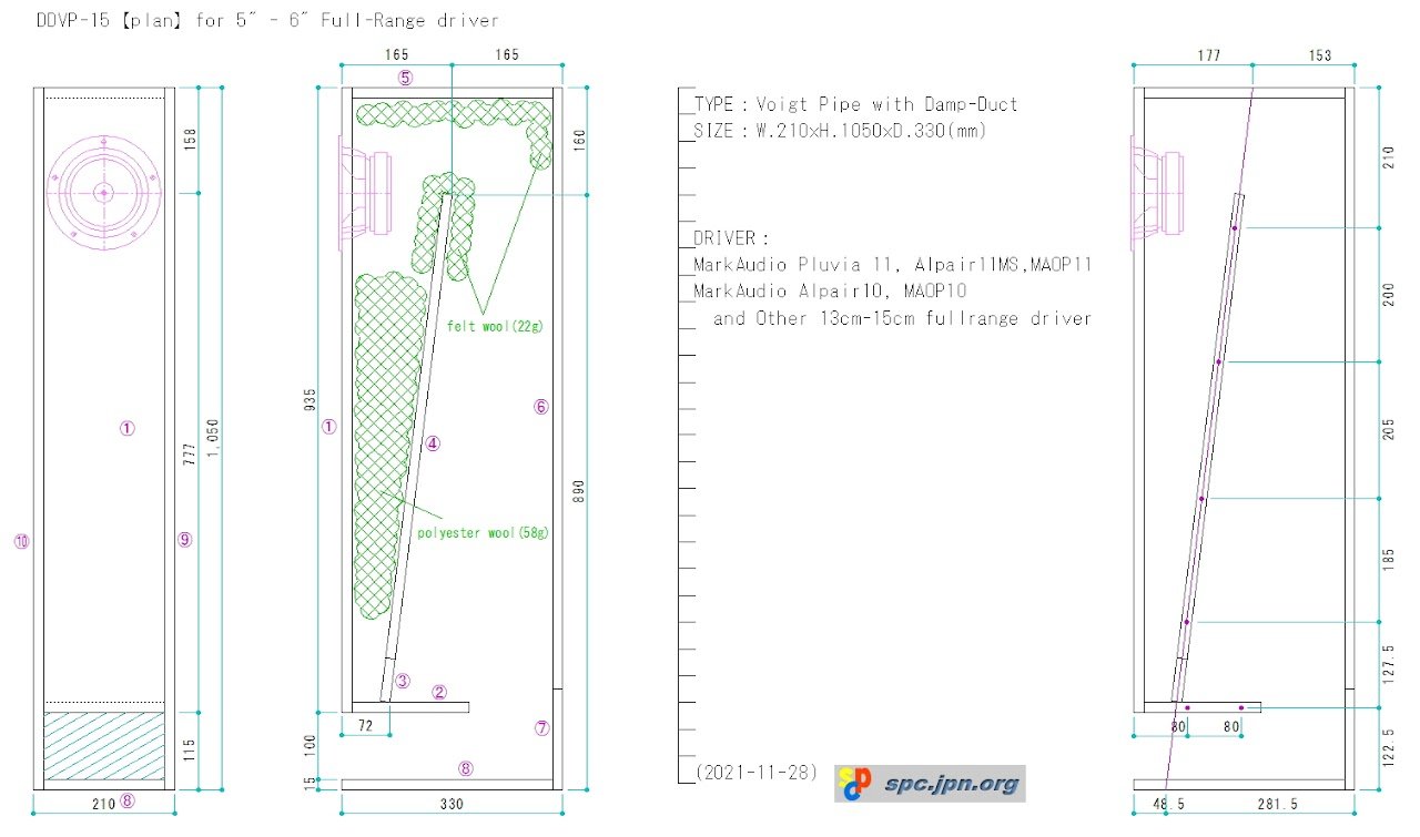

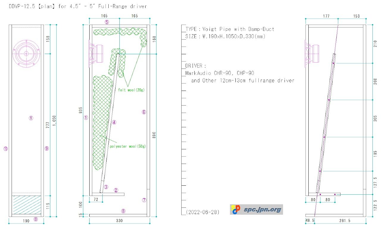

I'm gathering information and schematics for full-range speakers, mainly those from Mark Audio.
I'm looking at the Markaudio CHP 90 or the CHn 110 since they apparently don't have treble boost.
The schematics I'd like to try are from DDVP.

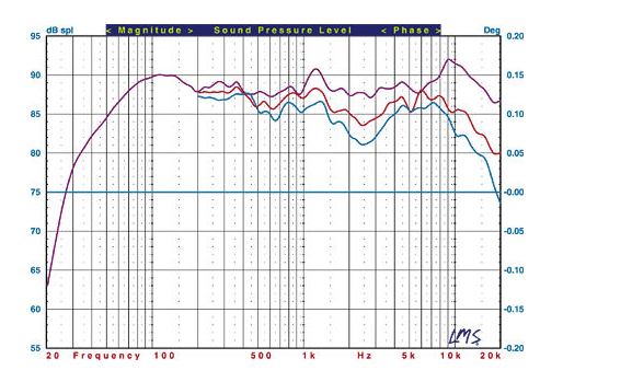

So I found some measurements here but maybe not your series
https://www.soundandvision.com/content/bw-dm-602-series-3-surround-speaker-system-measurements
If your speaker is similar, and other B&W speakers are, then the issue s balancing the on vs. off axis listening. There's a big peak at about 9 kHz that needs to be tamed on axis. So normally you'd offset this by toeing the speaker out , but then off-axis there's a big dip developing around 2-3kHz.
Really this needs a full analysis to do right, but if you were to just guess at a solution from this you need a notch filter at 9 kHz. This would flatten the tweeter and leave you with the best response in the 2-4kHz region.
On the other hand, IMHO, the response later in the review starts to show a more balanced output below the tweeter... so worth listening there. If that works for you then all you need to do is tilt them back a little.
A full on/off axis measurement of the bare drivers (in box) along with impedance measures of each may give you a better solution. For instance, I notice the woofer LP filter is very very simple. I also have seen a number of B&W tweeters that go much lower, but have horrible frequency responses. A full analysis would help tell you what it would take to do this right, which in the end may be a lot more than you want to do. Perfect setup for an active crossover with DSP though.
Other than a learning exercise though the ROI on this seem poor. A new 2-way kit you build yourself would be a great way to spend lots of money instead of most of my suggestions, above. 🤣

9 kHz is way too high to be the tweeter. Not saying a woofer can't have a breakup there, but given this is a 2-way and the off-axis performance I'd say the crossover point is around 3kHz. Everything above that is up to the tweeter. Good news however is you can apply a notch filter without even opening up the box. You DO need to know the impedance above 3 kHz though. Room EQ Wizard or DATS V3 are your friends there.
