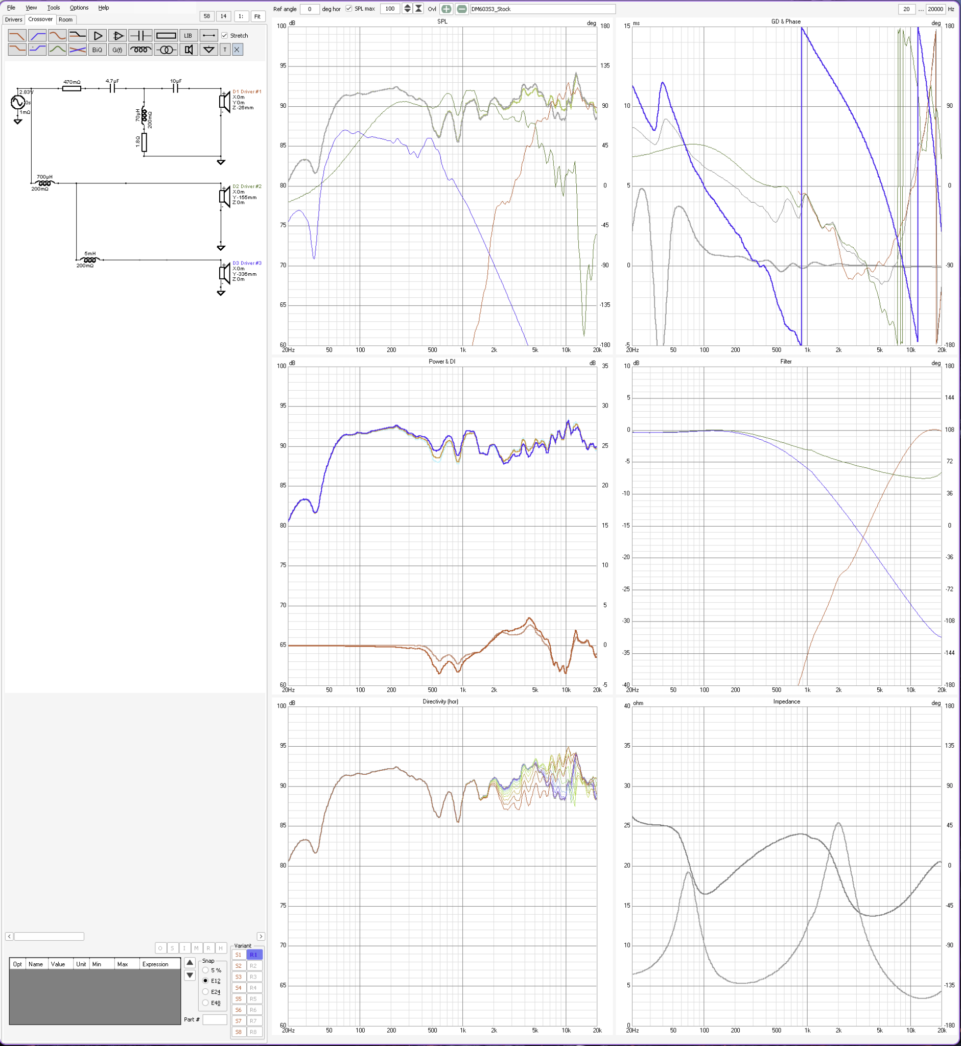

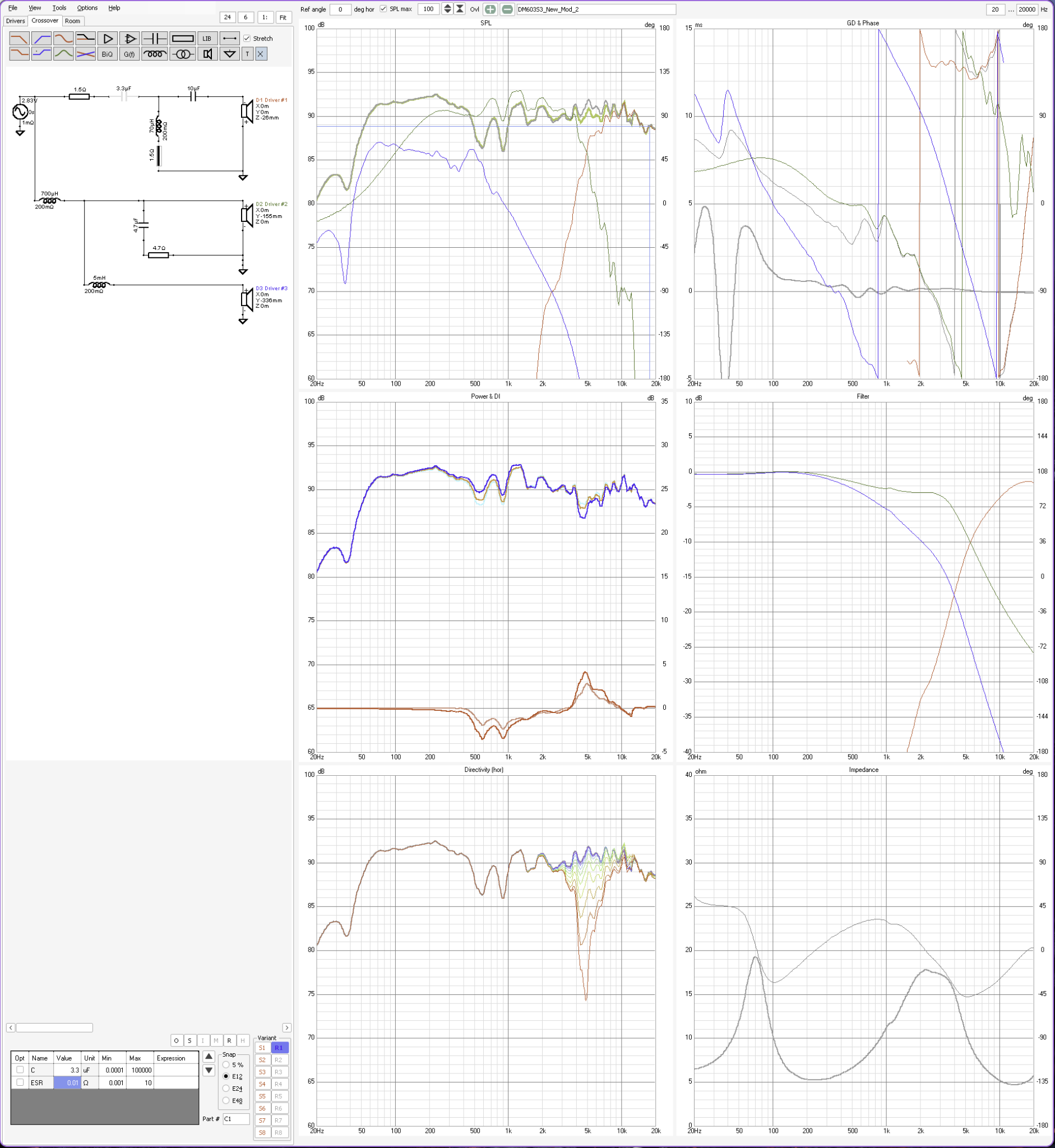

Inspired by the Rutcho Dm601 S3 mod, I decided to tackle the crossover on my pair of DM603 S3's using his design. It is my first time diving into this and I will admit I have no idea what I am doing. I imported the response graphs of the Kevlar woofer and tweeter into VituixCAD, and simulated the stock and Rutcho crossovers. I came up with a 1.5ohm R1, a 3.3uF C1, short of the resistor on the tweeter inductor. For the mid-woofer, I created a zobel network just like Rutcho, at 4.7uf cap, but a different resistor value of 4.7ohm.

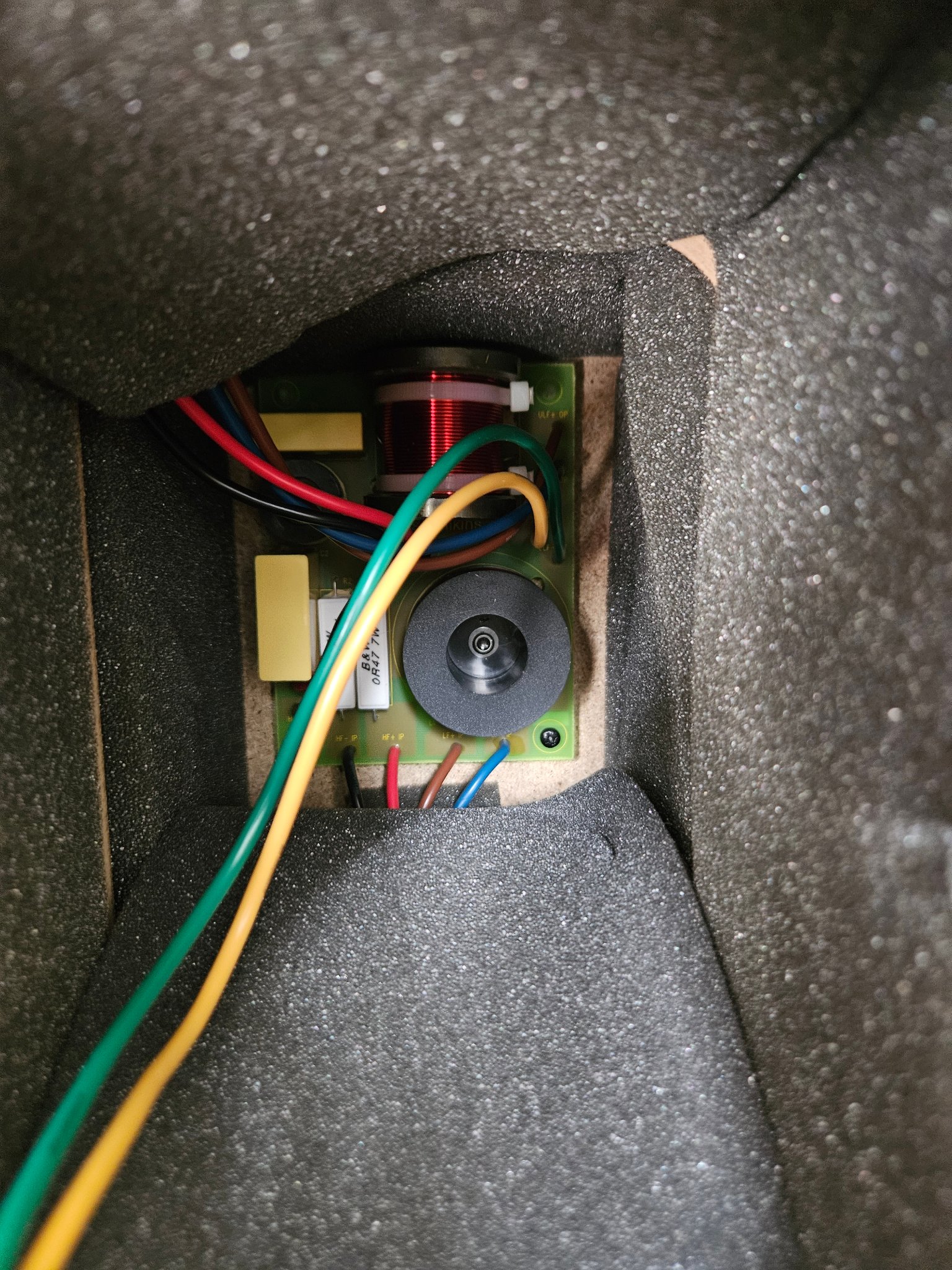

Using a 2.5 Allen key, I removed the silver woofer. There are three screws - one at the middle and one at each bottom corner. The top corners are held by expansion pins. I used a pair of pliers to squeeze them and put my hand behind the board to apply pressure inward. For the zobel, I cut open and balded the blue and brown driver wires and mounted the capacitor and the resistor from the leads vertically. The mounted components are held by glue, and I had to use a knife to pry them off. I did this to both speakers but my beginner soldering skills had my zobel bridge compromised and open. This gave me a unique opportunity to A/B the before and after while running simultaneous modified tweeters.

VituixCAD shows on the stock crossover a terrible phase shift after 7.5Khz and both the directivity graphs and phase patterns looked ugly. My post-mod speakers sound huge, delicate, spacious. it is definitely an improvement all around. However, I lost a lot of mid range and I suspect it is due to the 4.7ohm resistor on the zobel. I could play with 1.8ohms but the second problem is that the phase is nearly completely opposed from 2-4.7 kHz. The vocals sound delicate but they are also distant and lacking bark. I suspect I am not getting the full sound stage yet out of these drivers.

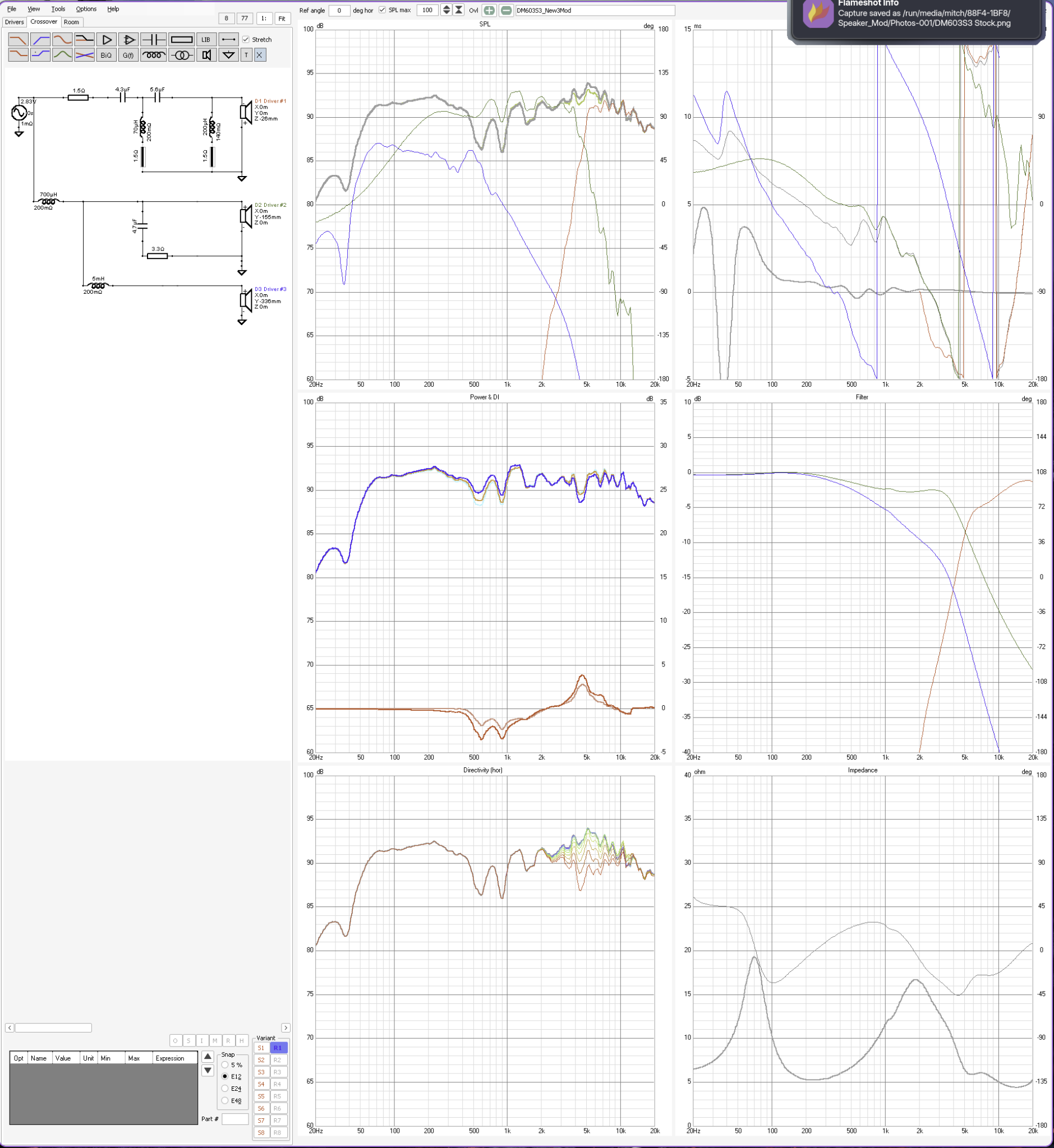

After some research, it occurred to me that the zobel increases the order of the filter. For parity, do I have to do the same to the tweeter? I ran this through VItuixCAD and came up with a 4.3uf C1 (I add a 1uf cap in parallel to the existing one), a 4th order filter created by a 5.6uf cap and a 200uh 15AWG inductor, and reducing the Zobel resistor to 3.3ohms.

Have you used timed measurements? I see you applied the Z parameter with your tweeter which you'd only do if your measurements were not properly timed. Phase is being affected by the delay, at least by way of the tweeter Z setting and the mid Y, in connection with the vituixcad standard listening position.
Both the tweeter circuit and models on the DM601S3 and DM603S3 are identical. Rutcho measured a 0.16mh inductor but B&W documentation presents the same 0.07mh as my speaker. Rutcho measured the responses of the tweeter and woofer drivers independently and these are the responses I utilized.
The only difference between the kevlar woofer circuits is the DM601 has a 1.1mh inductor value vs 0.7mh on mine. Im convinced the kevlars are the same drivers in different baskets. It would make the most sense from a mass production standpoint.
I saw in another thread that the tweeter is slightly recessed into a waveguide at the baffle measured at 26mm. A key point of the Rutcho mod is the tweeter polarity inversion for better phase alignment. When I zero out the Z and Y values on a simulation of the original Rutcho replicated circuit, I get a deep -25db notch at 5khz. Setting the tweeter to a standard positive polarity on VituixCAD shows a flat response.
I can test this in the upcoming days. My current mod simulation shows a theoretical flat response when zeroing out the axis values and resetting the tweeter to its original positive polarity. It demonstrates a 1 for 1 perfect phase alignment and also boosts the midrange area I am missing (if you ignore the 5khz notch). If it happens in real-world then it fully supports your theory of zeroing the axis values.
