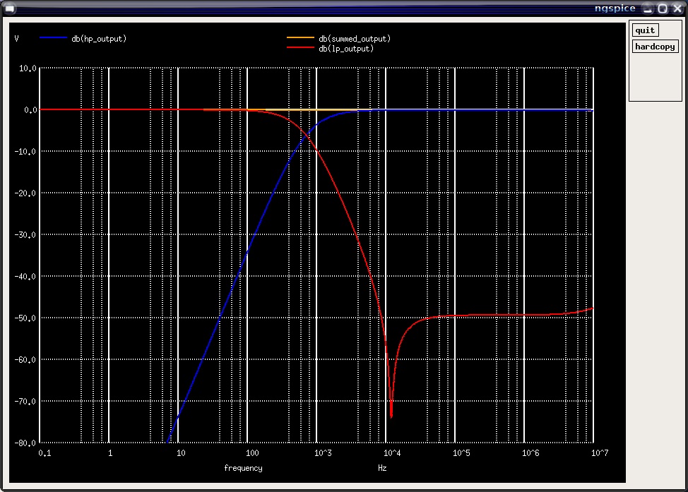

Here is my initial cut at a 2 pole LR filter using B1. This one crosses over at roughly 700 Hz (for my own personal project). Other frequencies are, of course, easily implemented. The filter seemed to lend itself to the symmetric supply topology, so that's what I have drawn here. I'm planning to use a beefed up Salas shunt regulator with this, as in the building-symmetrical-psu-b1-buffer thread.

It looks so simple. Unity gain and equal value R & C automatically gives Q=0.5 for the L-R function and makes it so simple to match components.
Be careful to check for DC at the outputs. Both at switch on and as the devices warm up. The low pass is particularly susceptible since it is completely DC coupled all the way through.

Thanks for the good suggestions. At the moment, I am more concerned with dealing with the issue of the Sallen-Key topology where, for the low pass filter, the finite output impedance of the buffer in combination with the feedback capacitor provides a for a forward signal shunt path which manifests itself as poor stop band response. In this case and with these component values, the difficulties are well within the audio band. This can be addressed in a number of ways, so I am back to the drawing board to do some thinking....

This has generated enough interest that I think it makes sense to start a separate thread, so here it is. If the moderators could move the relevant posts from the B1 Buffer Preamp thread to here it would be much appreciated.
A solution to the bandstop response issue in the low pass section is to provide a separate buffer for the feedback cap, blocking the forward signal path to the output. This increases the stopband attenuation to greater than 100 dB.
I've eliminated the trimpot from the LP section, as I don't need it in my particular application.

Your schematic have a serious error!
/RK
Could you be more specific?
Sorry, was not reading your text![ashamed :ashamed: :ashamed:](https://files.diyaudio.com/forums/images/smilies/ashamed.gif)
Seems you intentionally do not have a connection from the p section to the output buffer.
You say: "A solution to the bandstop response issue in the low pass section is to provide a separate buffer for the feedback cap, blocking the forward signal path to the output. This increases the stopband attenuation to greater than 100 dB"
