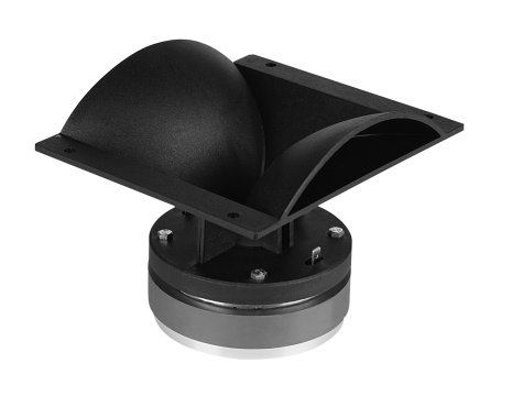

I have some questions about this tweeter / horn type.
1. Can someone point me out where to buy this horn without the APT tweeter attached to it in Europe. I cannot find this horn without the tweeter attached to it. I only care for the flare.
2. What would be the frequency cut off for this hornflare type. I intend to use it 2.5 kHz and above. It would be usefull if i have someway to determine the fc for this tweeter type. As an alternative for the EM 200S flare, i could get this smaller one. 88 x 88 mm (and replace the driver). But i have some doubt about size and Fc of the Dibeise F24 flare. Please notice both Baby But Cheek tweeter's do not have the difraction slot as seen in the original JBL 2404H.

I am particulary interested in this one because of the 90 x 90 degree radiation. A good fit for the midhorn i plan to use. The denovo DNA 150 could be a good match. (slighty OT link to other babycheek with roughly the same dimensions + neodymium DNA 150 style tweeter + measurement).
Parts express states 1.300 as lowest recommended crossover point. I guestimate the mouth to be about 150 cm2. 1.3 kHz is fairly optimistic...
I have heard the APT 50 in several designs. It will never offend someone, and it will never make someone pay particular attention to it, it can play loud, but it does not make my clock tick.

1) Can't help you.1. Can someone point me out where to buy this horn without the APT tweeter attached to it in Europe.
3)Please notice both Baby But Cheek tweeter's do not have the difraction slot as seen in the original JBL 2404H.

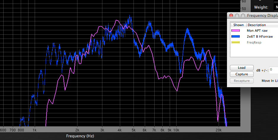

2) The smaller bi-radial horn (with a different driver) does not start dropping off until around 800 Hz. Using the APT driver I'd expect response to be falling steeply by at best 1600 Hz, the APT Fs is 2100 Hz.
I'd guess the APT LF response to be between the two shown below, the "APT Raw" is an APT80 with an additional 3/4" 90 degree horn flare, the "2x6T" is a 90 x 40 conical horn about 13.5" wide x 5" tall.
The APT HF response is a crap shoot, each of the ten I own have quite different response.

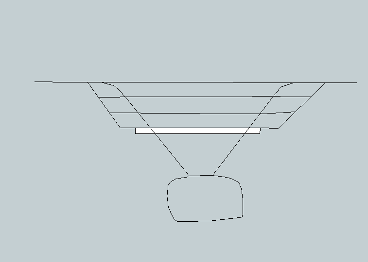

If you already have the APT 80, why not make an extension with a round over.Maybe time to ease up on the 90 degrees a little.
The extension can easily be made to whatever size you would like using a 45 degree router bit using a hole jig, just make each layer larger, and when as big as you want hand file the exit round and finish sand.
Just increasing the depth by 3/4" makes the horn quite a bit larger, decreasing the pattern control frequency, and reducing edge diffraction.

Something like this? I planned to make roundover's around the horn and play with some felt in the mouth. I had not yet combined the idea of a roundover with making a horn bigger / extending the range where wave's roll back. Thanks, another piece clicks in place. The buttcheeck flare shown above would also need a roundover at the top and the bottom ( in the picture, where the front plate is flat).

The 45 degree horn extension for the APT 80 benefits from a radius (roundover) at the mouth.Something like this?
Did anybody try 45 degree roundovers yet on hornflares? The results on baffle roundovers for tweeters would suggest that would work.
The (crappy)diagram below might make what I was suggesting more clear, the white portion is the original APT 80 horn mouth, three layers of extensions above.
Although I only added 3/4" depth and rounded the mouth, the difference was quite audibly smoother( and pattern control to a lower frequency) compared to the APT 80 raw horn.

Thanks for the drawing! 50% original / 50% add on diy mdf horn 🙂 I noticed the JMLC horns. And i have followed Mr. Bateman's adventures with roundovers. Interesting stuff.
I seldom use MDF, but the addition of the extension and roundover really do help.Thanks for the drawing! 50% original / 50% add on diy mdf horn 🙂

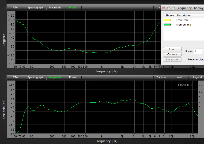

Here is the response of a 2x8" monitor with an APT with a 3/4" extension and roundover, the acoustic crossover is around 3500 Hz, but is nearly undetectable in the phase and frequency response in that region, though the upper APT dips and peaks are 🙄.
The entire passive crossover had a low parts count, only 2 coils, 2 capacitors, 2 resistors, and about 30 hours of substituting parts to get a good response.
