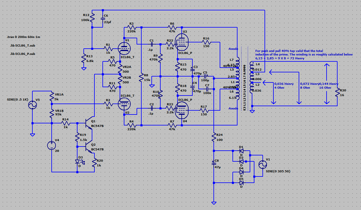

I am struggling a bit to get it going properly. Part of the problem is that I have repurposed a power transformer I already had, and this is 109-0-109 CT which I am using without the CT, so 218 VAC which should be the right B+. There is also a 8-0-8 VAC winding, 1.6A, which just about provides the 4 x 6.3v 0.725A heater requirements, with a dropping resistor as well. I also added a 6VAC PCB mounted transformer, with a quadrupler and zener with serial resistance for the -20VDC rail. That all seems to be OK, but adds a bit of risk to the implementation.
It was my intention to model the design in LTSpice so that I could compare the theoretical performance of the amp against my measurements. Unfortunately I cannot get the model to work very well, so was hoping someone here could point out what I have missed in the LTSpice model. The schematic I am using is here ...
The model and tube library files are attached.

I can't help you with LTSpice. But I noticed a couple of things in the original schematic you linked to:
The voltage drop over R4 is indicated as 100 V, so the current through R4 would be 0.45 mA. But this doesn't match with the indicated cathode current of 0.5 mA per triode section.
The voltage drop over R5 is indicated as 15 V, so the current through R5 would be 0.32 mA. But this doesn't match the calculated 0.45 mA through R4.
The anode voltage of the pentode sections is indicated as 245 V. But B+ is also indicated as 245 V. I would think one of them must be wrong since there will be some voltage drop over the dc-resistance of half of the primary of the OPT.
Vak is indicated in the notes as being 242 V, so 3 V lower than 245 V. But if B+ is indeed 245 V, and (because of the voltage drop in the primary of the OPT) the anode voltage of the pentode sections is indeed 242 V, than the current through R5 would only be 0.26 mA, so even more off of the calulated current of 0.45 mA through R4.
The Ayumi tube parameter model you are using defines only 4 electrodes - tetrode, not 5 - pentode.It was my intention to model the design in LTSpice so that I could compare the theoretical performance of the amp against my measurements. Unfortunately I cannot get the model to work very well, so was hoping someone here could point out what I have missed in the LTSpice model.
Most tube models do that.
Which means you have to replace the pentode in your .asc file with a tetrode assembly.
Done that, renamed the .txt model files to .sub, replaced the undefined LED with a RED LED from the LTspice library and it worked.
See corrected file attached.

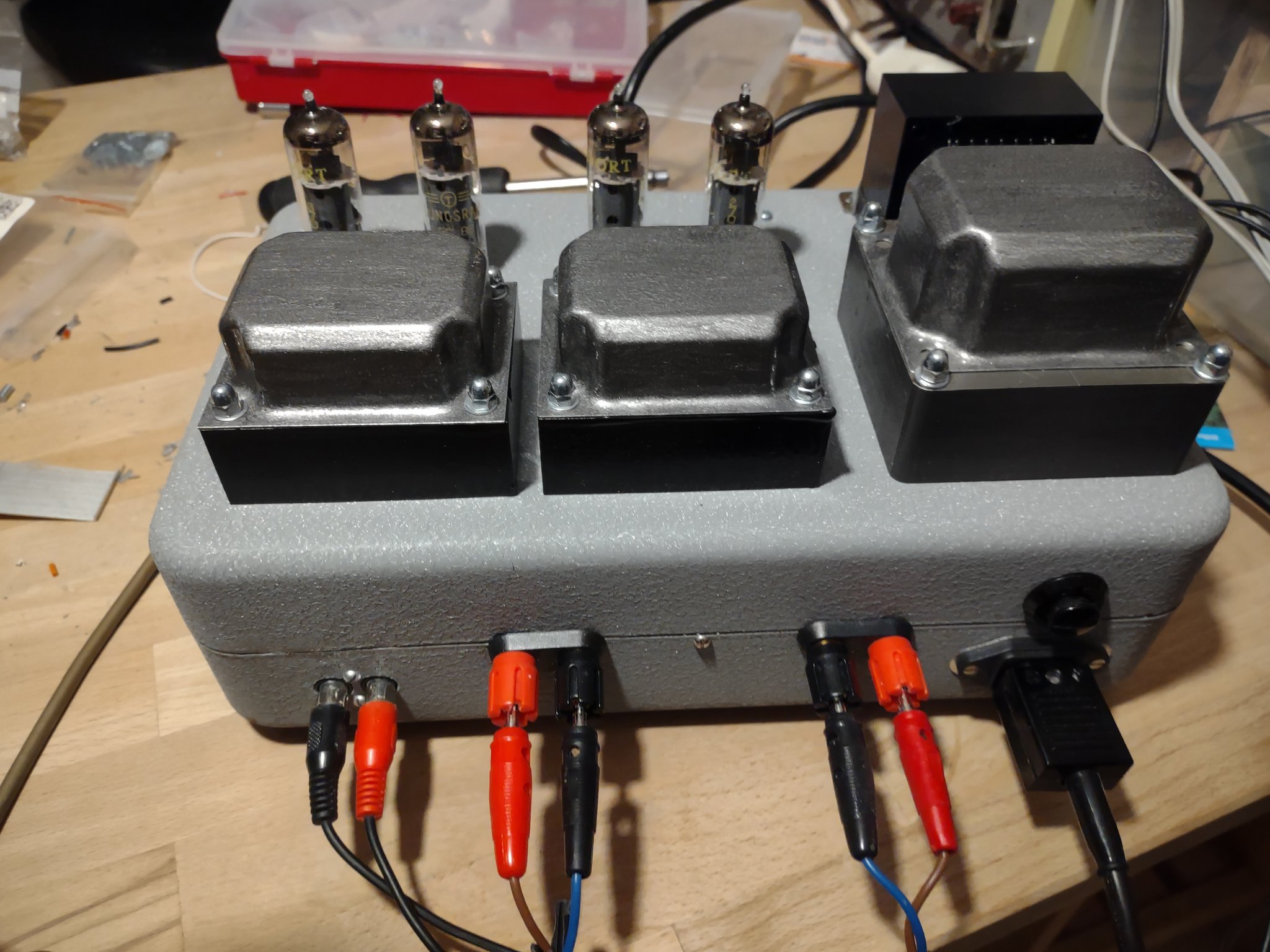

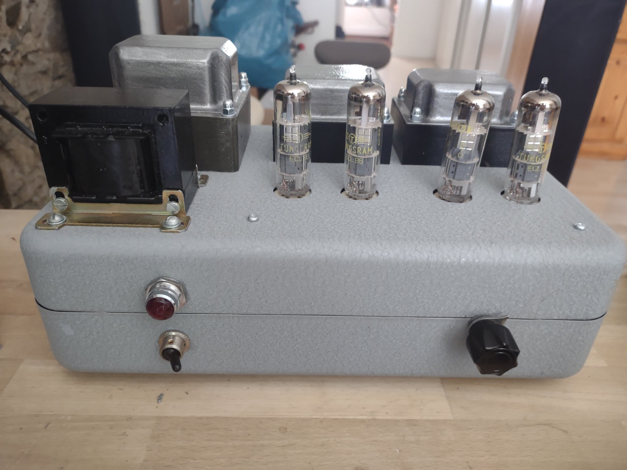

I have it built at long last, and it does sound very nice. I have two remaining niggles.
1) The gain is around 7, so 3.5V RMS out from a 0.5V RMS source. Does that seem a bit low? It works in my setup, but I am hoping to pass it onto my sone, so I am preempting any criticisms I might get later ;-)
The gain is in line with what the simulation tells me.
Has anyone built this who can comment? My B+ has ended up 270Vdc, so with 10V on the cathode that is 260V across the pentode, and Rk is 470R, so that is only 21mA for each tube, or 5.5W, well within the limit of 9W. Maybe a lower Rk value is an option, or should I just enjoy it ;-) I am mindful that this is not the most straightforward design, with a lot of interoperation of differen tparts, so I don't really want to tinker too much.

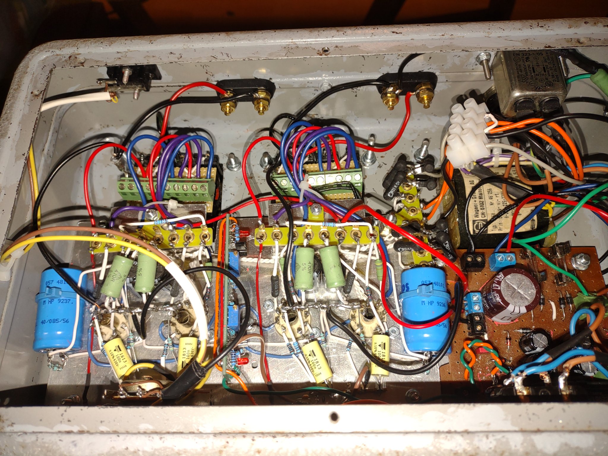

2) I wanted to use some parts I had knocking around, and I had this transformer which delivers the right B+, but has an odd LT winding of 8-0-8 1.6A. I will be able to use PCL86 or ECL86 with that, so that is a positive thing, but both require dropping resistors to get the voltage right. Currently I have some Tungsram ECL86 in there, with 4x0.33R 5W in series on each pair of ECL86s. So that is 2 x (1.7v @ 1.4A) that is being dissipatated by those resistors, which is close to 5W total. That is a bit of heat over time under the chassis.
I was thinking to add a bridge rectifier, to drop 2 x 0.6V in the rectifier, and I calculated with PSUD2 that a CRC of 4700uf + 1.1R + 4700uf should get me in the ballpark. I have not tried DC heaters so far - is this a worthwhile solution?
The power switch will be replaced - the one I had on there was intermittent so had to be binned.

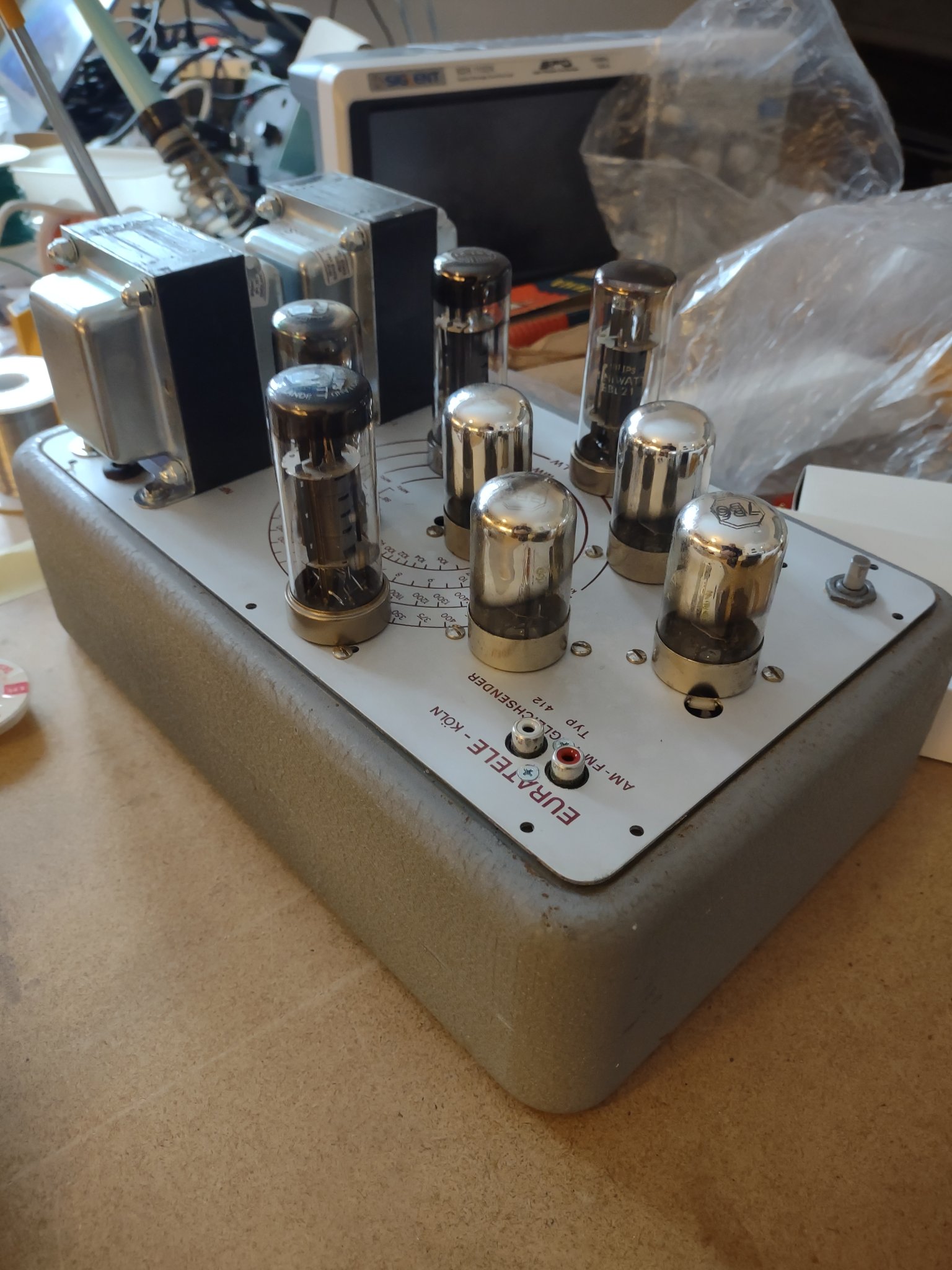

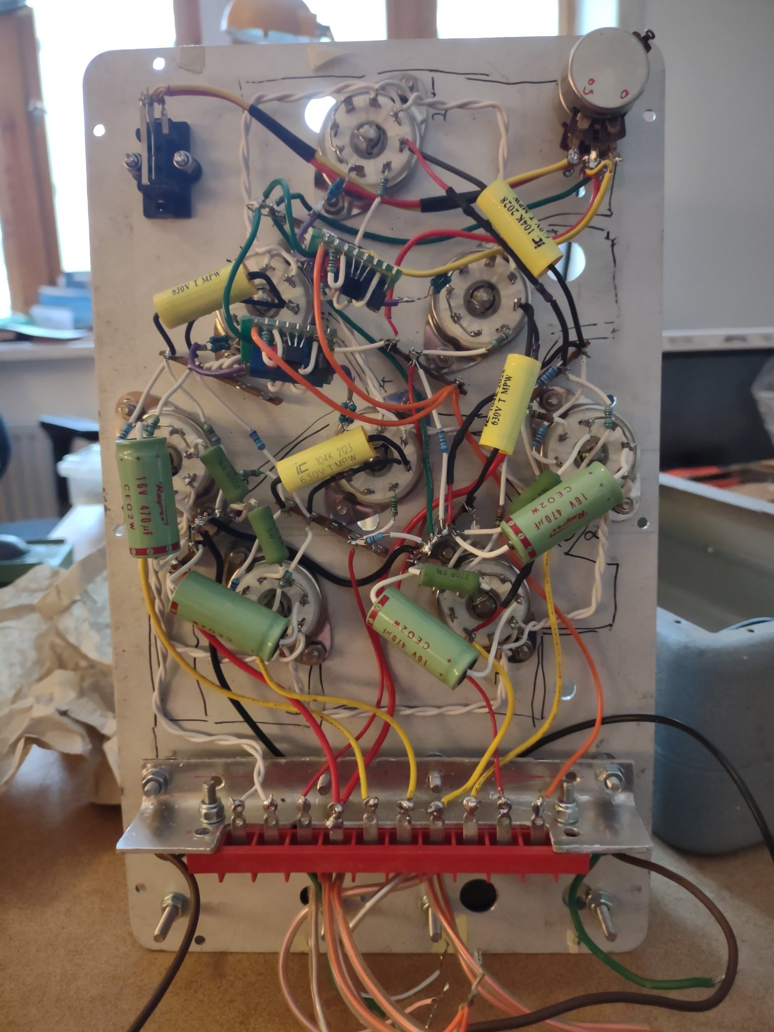

The metal box was an old Euratele signal generator, but it has been a 3D puzzle to get everthing in there, partly because the transformers had to be dropped through rather than bolted on top because that was not possible (they are from Ask Jan First). I built it on an aluminium sub-chassis, which is a trick I will do again since it meant I did not need exposed screws on the top plate aprat from two to hold the subchassis in place.

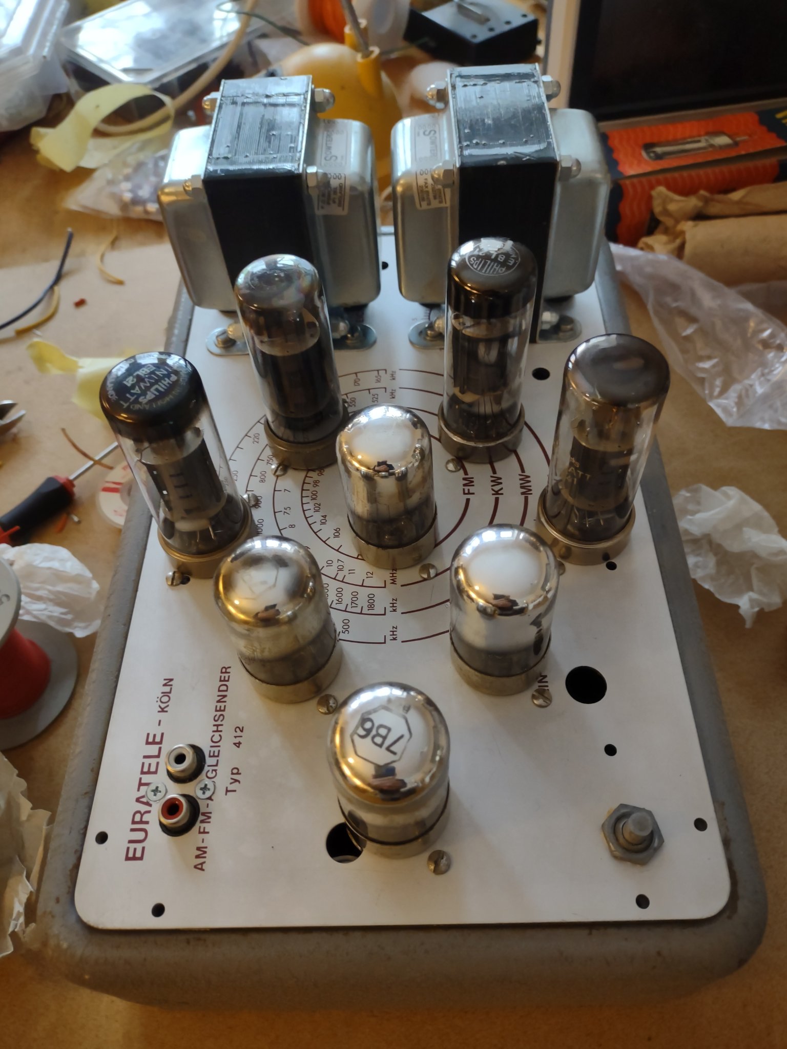

At some point I'd like to try a variant with loctal tubes, 7B6 as the triode and EBL21 as the output tube. Looks to have similar characteristics on paper.

Ian decided to apply two feedbacks as well, but different ones: a quite strong 40% a-g2 through UL and a strong a-g1 though Shade feedback.
So both local feedback.
A loadline around 8-10k permits to have a good DF without having a very low rp (because it's just the ratio of the two).
On top of that, that kind of load gives very low THD on triode curves, even if power will be lower.
What I tried and want to check with more time and an improved design, is going back to Yves roots (small amount of Shade feedback), but with error-only gnfb instead of conventional gnfb.
On LTSpice I can get around 80Wrms at 1% THD from a pair of KT88 and a 12AX7 as a phase splitter, with a DF of 22 and just 1.2 Vrms at its input.
Progress, but not sure if it will fly yet.At some point I'd like to try a variant with loctal tubes, 7B6 as the triode and EBL21 as the output tube. Looks to have similar characteristics on paper.
Why shouldn't it? The 7B6 triode is almost the same as a 12AX7 or a ECL86/6GW8 triode, and the EBL21 pentode doesn't differ that much from any European 9 watts pentode since AL4. It's a 11 watt pentode, though, but electrically equivalent to it's predecessor, the EBL1, which in turn was a 9 watt plate dissipation pentode.
Did you acquire the EBL21's for little money?
Best regards!
Best regards!
