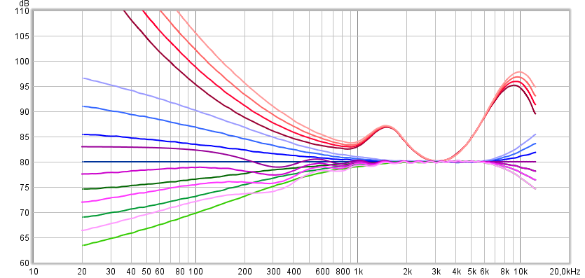

...If I might add something else. I have long been fascinated by Fletcher-Munson curves. They show that at 30 Hertz we need to hear 70dB SPL for it to become audible, the threshold. So as we descend in frequency, the audibility threshold changes. We hear higher frequencies with much lower threshold earlier than the fundamental in many cases. So if a percussion instrument centered at 30 Hertz producing many harmonics, we hear the harmonics first and then the ear/brain expects to hear the fundamental, in our case 70dB SPL. But it will take more time for that fundamental to reach the threshold. The harmonics are way ahead and creating an expectation. Any delay will affect the sound, slower? Less dynamic?...

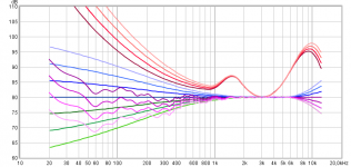

In first place thought well that's how we hear and don't know of other

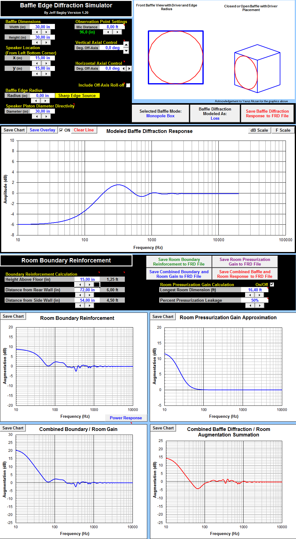

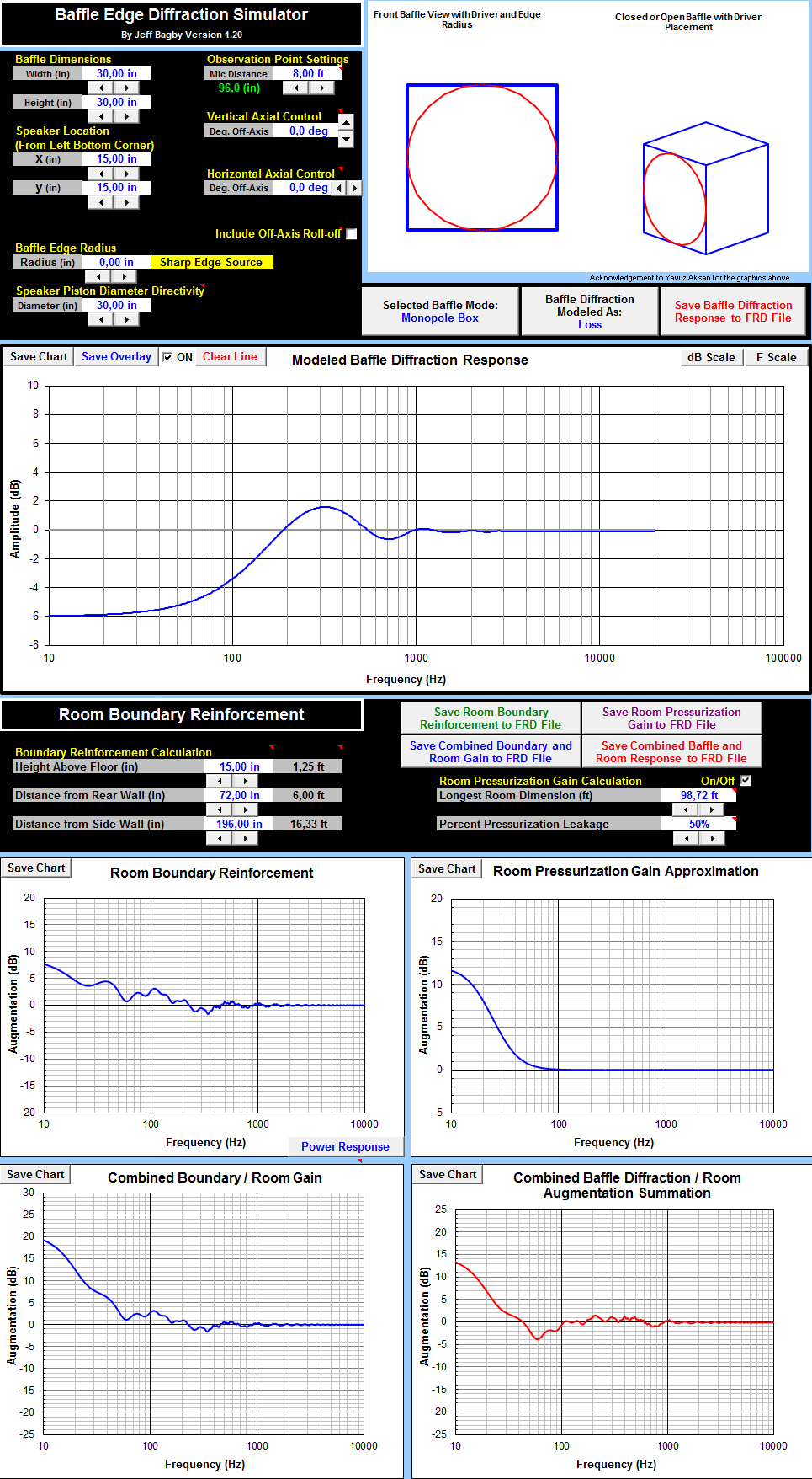

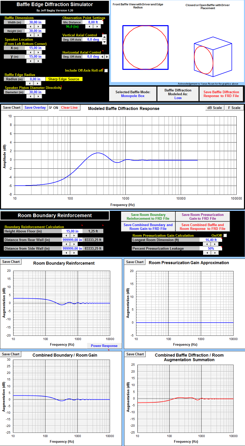

First spreadsheet simulate in a free field with only one boundary being the ground beneath it and being outdoor without any room pressurization gain it still adds 3dB gain at lows, second spreadsheet is indoor in a 25 sq meter room and three boundarys set plus 50% room pressurization gain, and third spreadsheet is in big indoor 300 sq meter room with three boundarys set plus 50% room pressurization gain.

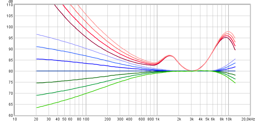

Now for reference use to below spreadsheets low end gain here is a homebrew of traced ISO226-2003 curves into REW, the dark red 80 phons curve is used being the dialed in SPL reference then the brighter the red curves go is 70/60/50 phons so we step 10dB per curve and they offset to overlay at 3kHz so to calculate correction or error curves seen below, perfect flat dark blue curve simulate the dialed in 80 phons SPL reference and the brighter the blue curves is the relative corection curves to coop for equal loudness, green curves is blue in reverse and their brighter sound signature:
Free field with only one boundary being the ground beneath it and being outdoor without any room pressurization gain:

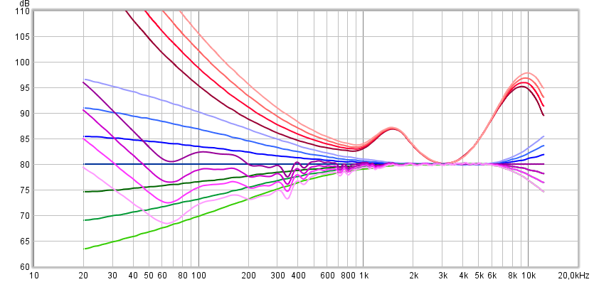

Indoor in a 25 sq meter room and three boundarys set plus 50% room pressurization gain:

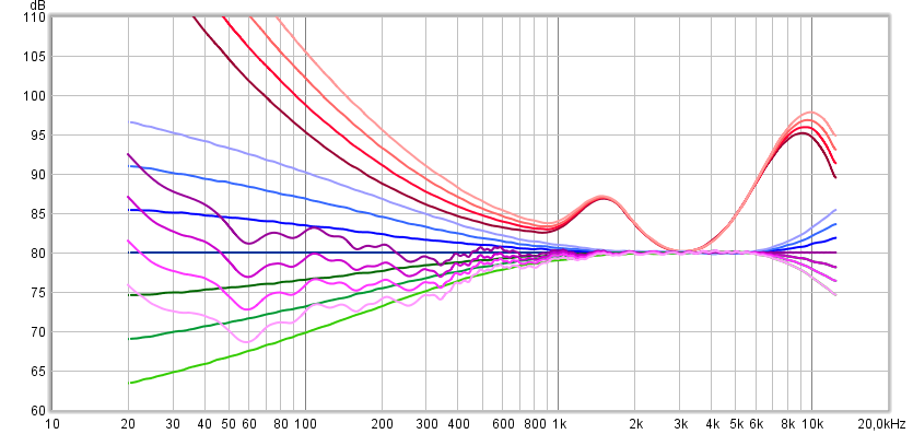

Big indoor 300 sq meter room with three boundarys set plus 50% room pressurization gain:
If this amplitude modeling is true enough to reality and timing is not ruined by non minimum phase reflections it looks we have some more or less good enough support at lowend from enviroment, especially those nasty spiking very lows (DC-like) that indoor room pressurization gain adds up.
