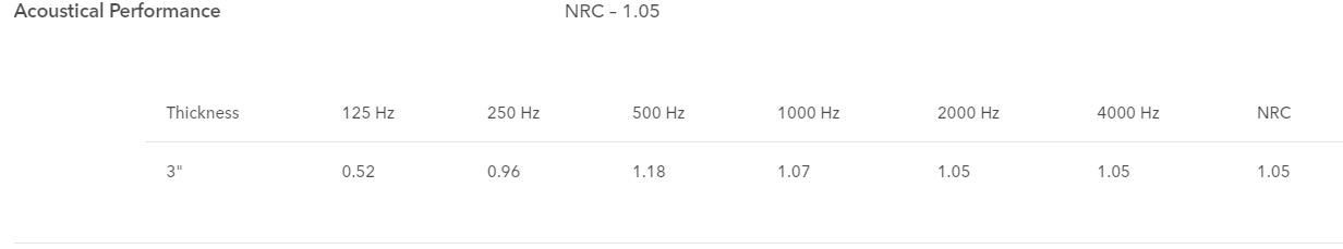

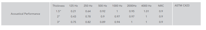

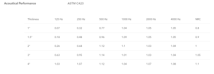

I'm wanting to put an acoustic wall on the back wall of my dedicated home theatre. I've decided to allow 5.5 inches of framing, ie. 2x6 construction. I've heard of mixing insulations, available easily is Rockwool Safe N Sound and Comfortboard 80. Would it make sense to do a 3" Safe N Sound @ 2.5lb density and then go over top of it with the semi rigid Comfortboard 80 8lb density? Looking for some ideas.

On the concrete wall I'm using 3x1.5"CB80 over 3.5" fluffy
The other 3 walls are 1.5"CB80 over 3" safe and sound
Ceiling 2x1.5"CB80 over compressed 12" fluffy
