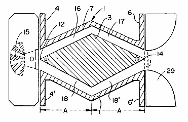

German high-end speaker manufacturer Backes & Mueller employs
a quit different waveguide in their top of the line BM35 and BM50 speakers. ( The BM50 costs over us$ 100.00,00 )

It's not that outrageous..
Consider that every compression driver *relies* on diffraction for operation.
They have just converted the point source into a line source via additional diffraction.
The waveguide is just that - p!ss little acoustic gain designed primarily to control the dispersion pattern. That large chamber operates as a "lower" freq. low pass filter - reducing the naturally exaggerated *higher* freq. response of most compression drivers. (..basically the opposite operation of most horns - which raise the *lower* freq. response with acoustic gain.)
One interesting thing to note:
..look at the "departure" angle of the interior wall of the front chamber as it connects to the waveguide (in relation to the waveguide). 😉

Hi ScottScottG said:Consider that every compression driver *relies* on diffraction for operation.
How is that? I don't follow.
angeloitacare said:i thought diffraction was detriment to quality , and not desirable ?
It is. Who said that they do that because it sounds better? Its more about image and looks than sound.

What Earl said.. 😀 But that's a generalized response.
How this application sounds to any particular listener? Don't know - could sound fantastic or cr@ppy, or likely somewhere in-between. (..not exactly a useful response either.)
I wouldn't "chuck" the idea simply because it utilizes diffraction. Again, if that was the case you wouldn't be using a compression driver - which "pushes" a relatively large, (wavelength size), grouping of wavelengths through a small opening. Sure - there is also the contribution of the phase plug, BUT its operation is also diffraction-based (.same song second verse, not quite the same as the first).
Note that this particular design will be considerably less efficient with greater non-linear distortion at lower freq.s. On the other hand it may still outperform a good tweeter in this respect (..depending on the performance of the compression driver).

ScottG said:
Me thinks you do.. 😉
Scott - I am still not sure what you mean.
Are you saying that a compression drivers phase plug diffracts? Because if thats the case then I would have to disagree. There may be a small amount of diffraction right at the diaphragm because of the finite slit width, but this is not really diffraction, per se, since it's not a free propagating wavefront at that point. The air is squeezed through the slits in the plug and no serious diffraction would occur because the slits are so small compared to the wavelengths.
This is not at all the case with the large slit on the horn being discussed.
The bigger issue at the slits is turbulence, but even this is found to not be significant.
angeloitacare said:If it is true, as many state, that diffraction at the mouth and throat of a horn/WG are one of the main sources for coloration, this setup should sound crap....
Maybe it does. We have only one posted opinion and a hazy one at that.
That's exactly what I was referring to. I also understood that the phase plug basically pushes the compression chamber's low-pass filter higher in freq. AND diffraction effects higher in freq. - to effectively become a non-issue.
The thing is though, the basic operation still *relies* on diffraction, the difference is that it's reasonably well designed so that its effects are of little consequence.
I'd also agree that the B&M design will *not* overcome this limitation because the large secondary chamber does not have a similar phase plug to keep diffraction into freq.s higher than the driver's operation.
