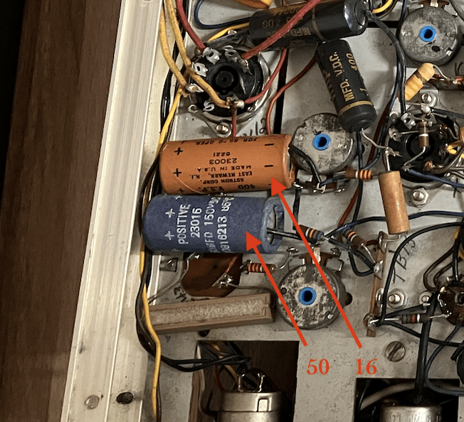

Alright thank you for that info! I was actually looking over my work and noticed that the original caps, for some reason were different on each bias pot. For some reason they had a 16uF and a 50uF, so let me first take care of that, not sure if that could make a difference but surely they should be the same especially since that is what the schematic calls for. Here is a photo of what it was, surely odd that they would be different...
