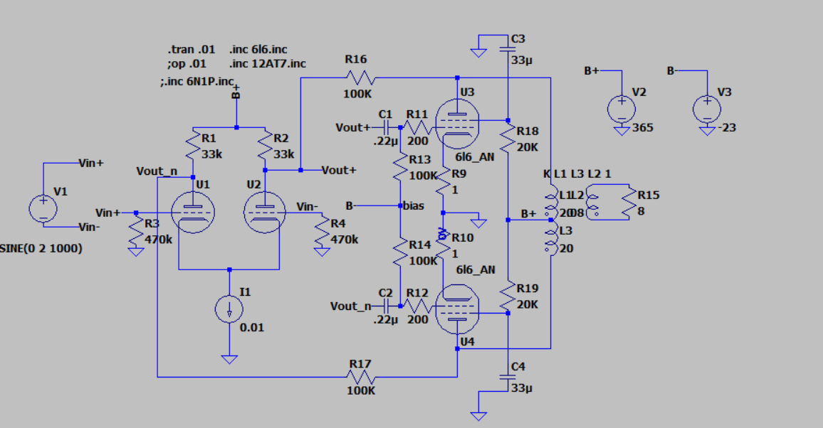

2. Balanced signal to a Balanced Push Pull amplifier does have benefit(s).
The phase splitter is in the signal source (like my CD player with XLR balanced outputs).
I love the sound of my latest amplifier design; it is Balanced.
A 12AU7 input/driver, and 5881 output tubes.
I hope to find the time to take pictures, draw a schematic, and Post a thread starter of my new amplifier design on Tubes / Valves.

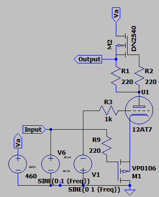

I'm just thinking out loud:
If you use a pmos source follower (like the VP0106) on the cathode of the 12AT7, you can drive the triode with a balanced signal: one on the grid and the opposite on the gate of the mosfet.

Hi Chris,
this is what I mean (sketched, to be improved):
V1 and V6 are the balanced input signal.

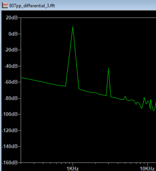

On a CCS loaded 12AT7 with 700 mVrms balanced input it gives 78Vrms on the output at 3% THD.
This means also that we can drive a SE triode (or pentode, or whatever) with a phase split stage.
This could also mean that we can focus on cancelling the 3rd harmonic of the output stage instead of the 2nd.

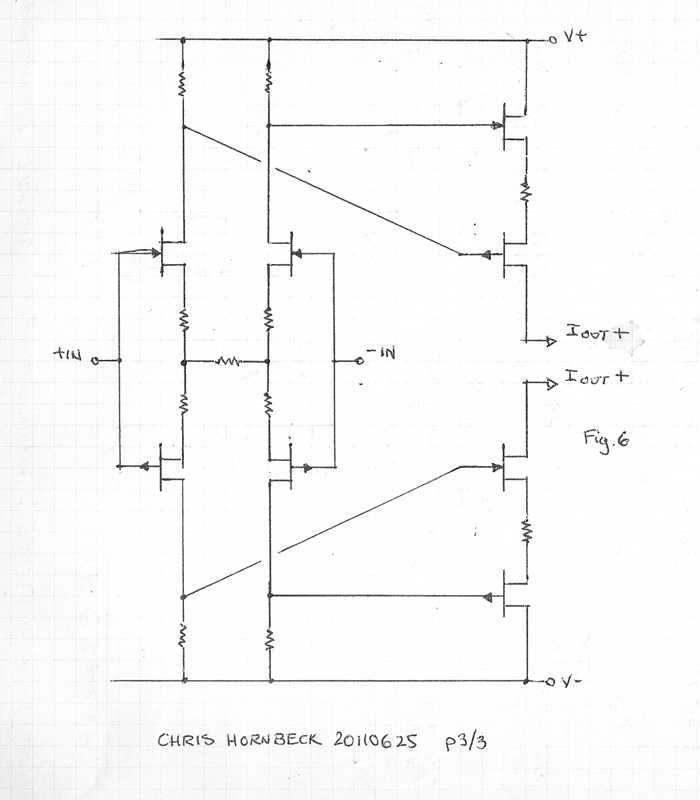

V1 and V6 form a differential input that's called a Rush cascode. Here's an example without DC offset:
The input stage is the classic John Curl and the second stage is a Rush cascode. Both are differential.

I'm sorry Chris but I don't get your point.
The OT asked about benefits of having a balanced signal in a SE amp, as he has a DAC with balanced outputs.
I proposed an idea to get benefits of a balanced signal into a SE driver by driving the grid and the gate of the driver with opposite signals and increase the sensitivity of the amp. What is the clue with the solid state circuit you posted?

To expand some: your circuit is truly differential, in that it doesn't require a source signal that is "balanced" to give noise immunity. It is inherently only responsive to the difference between V1 and V6 - anything appearing equally on both is very largely ignored at the output (in this case, the anode). It doesn't require that signal appear on both V1 and V6 to have this CMRR rejection of noise on connecting cables to accomplish this.
Caveat: the noise voltage impressed on a twin (usually twisted for best averaging) conductor pair is most equal when source and load impedances are equal for both polarities' conductors. This is the origin of the modern semi-pro "impedance balancing" - one of the twin signal conductors is driven from an op-amp with a build-out resistor R and the other is just an identical R to ground. Works the same for a truly differential input.
So, to the OP's point, driven balanced outputs aren't really very useful unless you pair them with an appropriate input. The noise rejection all happens at the receiving end of the wires. But even a single-ended input with three pins can get most of the way there, per post #4.

Now I understand! You were focusing on CMRR, while my proposal is more focused on having the possibility to use the balanced signal as a 2x in amplitude by driving the grid and the cathode with two signals opposed in phase.It doesn't require that signal appear on both V1 and V6 to have this CMRR rejection of noise on connecting cables to accomplish this.
This makes the single stage driver capable of having high gain to directly drive low gm output tubes.
