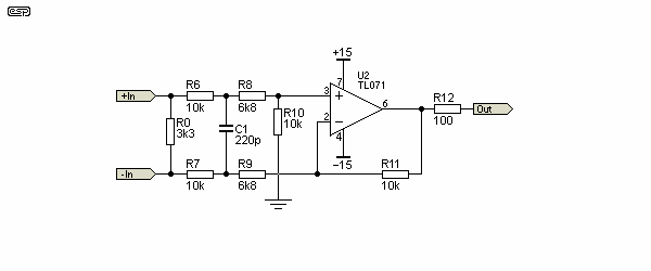

Far too complex. All you need is this basic design, as most manufacturers of high quality mixing desks use. By all means use 'better quality' op amps but it is difficult to beat a TL071.
Extra buffering is not normally required.
You can attenuate as you with.
That will 'work' but the 3 op amp design will be quieter - due to both lower value resistors where it matters and less voltage noise from that opamp.

For the OPs circuit - probably want small caps across R2 / R3 (I think - can't see schematic atm) to limit the bandwidth. And need to consider where the output is going - if driving any length of cable you need to include a series output resistor for stability with capacative loads eg a screened cable - say 51R to 100R

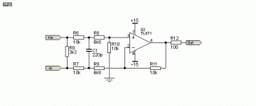

Why cant we just use a single 5534 in differential mode?
Already hit-upon......
All you need is this basic design, as most manufacturers of high quality mixing desks use. ...
Yes, the one opamp plan works in most situations.
In *adverse* situations (not most hi-fi), the single amp plan has several impedances for each input, differential and common-mode, spoiling ideal performance.
Opamps are cheaper than the connectors. _IF_ more amps matter, why quibble?

Why cant we just use a single 5534 in differential mode? Legitimate question here
This is a short article I wrote comparing a single op amp in a difference amplifier circuit, to a 3-op amp solution. In this case the 3-op amp solution was an integrated chip, the INA1650.
http://www.ti.com/lit/an/slyt737/slyt737.pdf

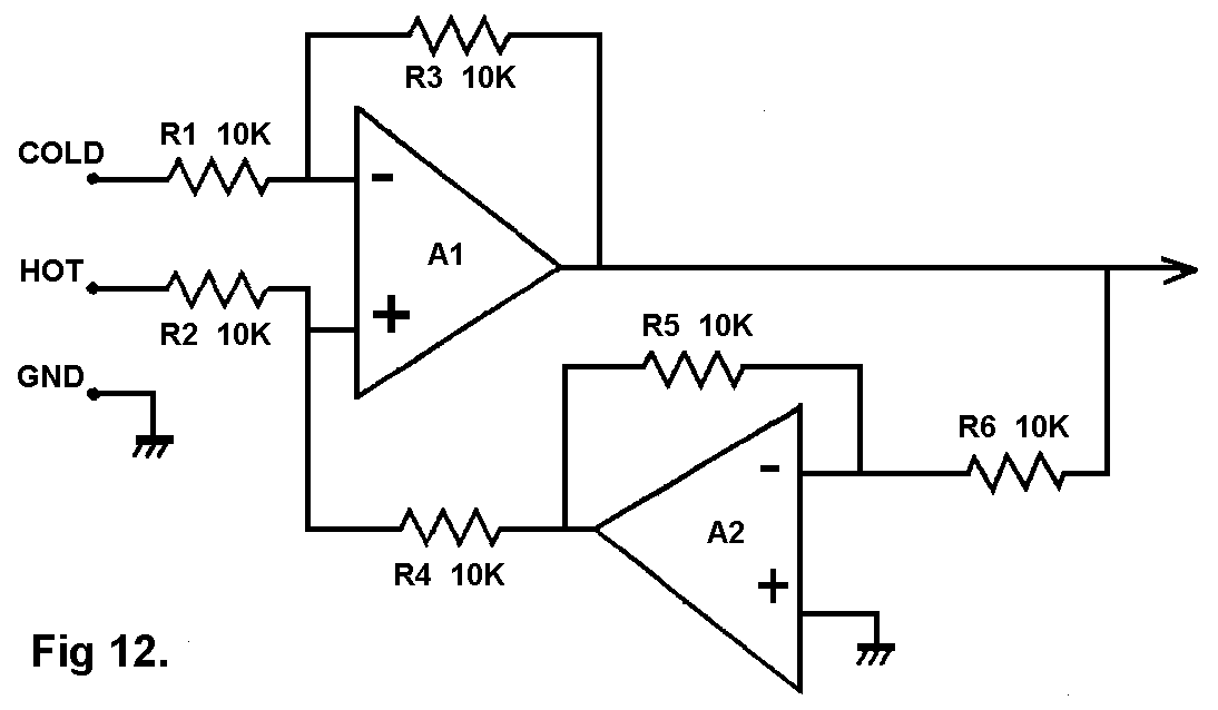

try to use superbal circuit. I was very satisfied with that topology.
Fig 12 from Balanced Line Technology - VPN Security
cheers
cheers
