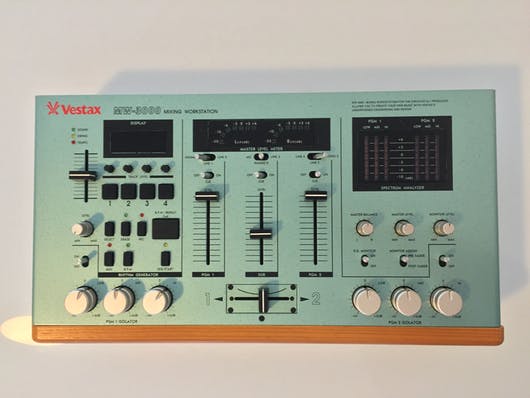

Ol' but rare Vestax dj mixer that I am restoring. It's rca out only. I will need to make it balanced out. The question is transformer or electronic and either way will cost money.
Plus/minus $200 is not as important as best performance out of this mixer. Hence the original post.

Ol' but rare Vestax dj mixer...
Can you tell us which one??
Vestax was in business near 4 decades, many-many products over sevral generations of electronics.
I found a source of service manuals. However I am not going to read all 45 of these looking for your "rare" machine.
Vestax - KevinChant.com
Vestax MW-3000. It's a rare beast and I'd like to have it up to modern PA standards, with balanced outputs. Like all decent PA gear.

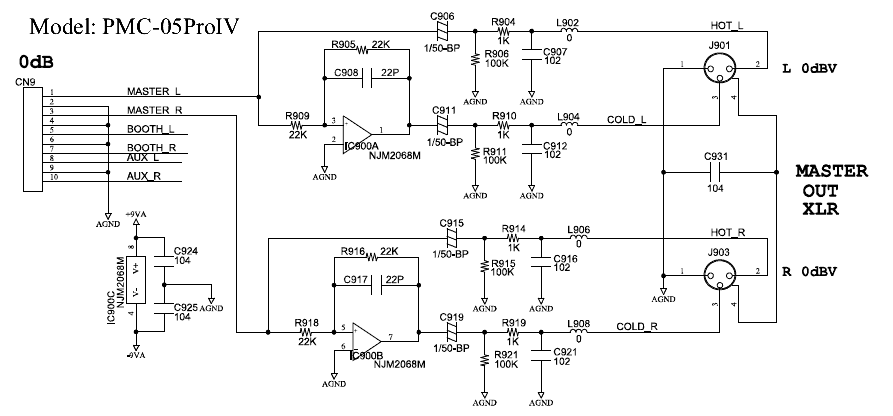

Vestax *already* designed a fix. The PCM-05 Pro IV has the unbalanced output main board, and another board to balance the output (and double the max output on the same supply), AND protects it against 48V Phantom (a real risk when sending XLR cable to strange soundmen). There's other ways to do all this, sure. But I like a known-good factory-thought-out plan.

Read the blurry schematic. It appears to be a NJM4580 (hi-current) opamp, 10uFd, 220r resistor. "10k" is gross under-rating... 10k was the number on the minimum product spec, so they did not bother to put the true ability on record. The 10uFd suggests we'd like >1k loading, the 220r would like >2.2k for -1dB drop, but it would not suck in 600r, except only +7dBm. (It really is intended to go just to a power amp or a line-level input on a mixer.)
I've just noticed the PCM-05 uses different supply rails. It might be best/simplest to build the boost/balance as a separate box with a cut-down PCM-05 supply, RCA in, XLR out.
There's the curious and charming Vestax.
...if you're wondering what the fuss is about. It has a nice nostalgic feel but only lacks the balanced outputs. They don't make em like that anymore!
JMFahey and PRR: so it sounds like the Jensen 600ohm transformer is not the best idea for this mixer, after looking at the schematic, as the minimal loading is around 2kOhms, correct?

NB:Vestax *already* designed a fix. The PCM-05 Pro IV has the unbalanced output main board, and another board to balance the output (and double the max output on the same supply), AND protects it against 48V Phantom (a real risk when sending XLR cable to strange soundmen). There's other ways to do all this, sure. But I like a known-good factory-thought-out plan.
1. The usual "XLR pin 1 is wired wrong" (AES48-2005)
2. If driven at non-zero source impedance, that needs to be subtracted from R914 etc. to get actually balanced output impedance. Also, 2k balanced might be a tad high.
NB:
Is that +/- 15V or just +15V? Single supply operation requires some tweaks.There's plenty of space inside and it's got 15v dc on the input of the mixer.
