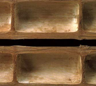

The internal structure of bamboo is interesting, as it naturally forms hollow "internodes" that are separated by a solid plate at each node joint (see "bamboo cross section.jpg"). My idea is to see if it is possible to utilise the natural form of one of these bamboo internode sections to create a full-range speaker enclosure.

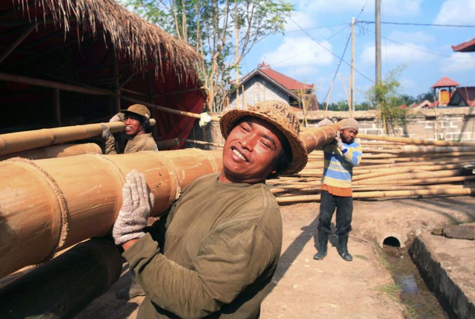

So to start my project, I found a scrap piece of giant bamboo from a local construction site to grab some measurements. Apparently it is possible to get bamboo poles as big as 20cm diameter, but the piece I found measured 15cm diameter on the exterior, and 12cm diameter to the interior. The internode length is about 49cm (46cm internal gap), which gives an internal volume of about 20.8L.

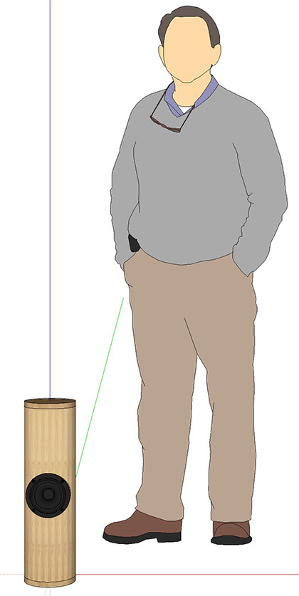

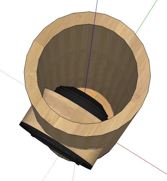

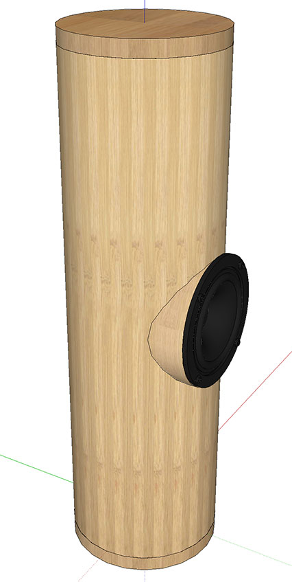

I've attached some Sketchup pics of the kind of design I'm thinking of. DISCLAIMER: I've not done any real modelling of this design yet, other than include measured dimensions in the drawing, so these pics are more to communicate the idea than a final design spec!
As you can see in the third diagram, the actual construction of this should be reasonably straightforward, basically consisting of two bamboo tubes intersected. Although not quite shown in the diagram, the top and bottom seals will actually be the natural bamboo plate within the bamboo itself. Once settled on a design, I will try to engage the local craftsmen to build it for me, as they have the right tools and are capable of creating a lovely finish to the wood.
Unlike typical enclosures, this cannot be designed with millimetre precision CAD/CAM in mind. Given that no two pieces of bamboo will ever have exactly the same dimensions (although we can get close), I need to try and come up with a design that is as forgiving as possible, while still endeavouring to sound good 🙂 My ultimate goal is to create some really decent-sounding handmade speakers using as many natural materials as possible, and make them look good too!
So, question time 🙂
1. Are there any resources I can refer to on designing a cylindrical enclosure? This is something I really haven't been able to find any info on. It seems that the curved shape of the internal cavity might be good at eliminating reflections, compared to traditional boxed shape? Maybe there are some limitations I need to know about?
2. Given the shape of the bamboo, it would be trivial to cut a bass-port in the bottom to vent the enclosure. Would this result in better sound? Alternatively, would that help make it more "forgiving" of differences in bamboo dimensions?
3. In order to get good spatial positioning, I read it helps if the enclosure volumes of two paired speaker match exactly. I was thinking that when making a pair, it would be possible to "fill" one of the enclosures with solid material a little to make the internal volumes match. Is this a good idea/necessary?
4. What about the positioning of the driver? Is the centre ok, or would it be better moved towards the top? I worry about standing waves forming inside the tube, and also about not making the centre-of-gravity of the unit too high.
5. Is 20.8L internal volume too great for the W4-1879? (The Vas on the spec sheet is 9.12L - although I know these are not directly related?). Does the internal volume matter as much provided it is greater than the ideal minimum? (this might be one way to get some flexibility in tolerances?).
6. Are there any design rules of thumb I could draw on that might help deal with the organic nature of this design and still result in a consistent sound?
Anyway, thank you for reading so far. I wonder if I am being crazy with this idea? Is there something obvious I'm missing that means I should not even attempt it?
I would love to hear your thoughts on this project and any tips or suggestions you might have! Pointers on how to start modelling this would also be great too. I am tempted to try the "suck it and see" approach and jump straight to construction, but the inner engineer in me suggests that some modelling first might be wise to make sure I'm not building a lemon 🙂

The circular structire of the bamboo should make a very good enclosure. The "end caps" may need reinforcement.
If the 20-some litres is too large you can always use random solid chunks as filler to reduce the volume if needed.
dave
dave
Cool idea.
I wouldn't worry about bamboo as a material. To my knowledge bamboo is much stronger than wood. Additionally, with reguards to pressure, cylindrical objects actually deal with pressure (much much much) better than cubes or rectangles. There's a reason pressurized hoses/pipes are cylinders 😉
The only reference i know to a cylindrical enclosures effects on frequency response is here. Not really a guide, just was a very generalized experiment to find the optimal enclosure shape. Which is a sphere if your wondering 😛
Anyway, filling a portion up from the bottom would be very easily done with concrete or sand. I'd imagine sand might actually have some damping characteristic that would give it an advantage over concrete. Not to mention it would be cheaper, faster, and easier to do lol.
As far as standing waves and whatnot inside an enclosure, stuffing with polyfill takes care of a good majority of it. Generally 1 to 1.25 pounds per cubic foot of enclosure is recommended and raises apparent enclosure size by approximately 25%. I'm sure coco coir (hair like) would work just as well if you can get it free around you.
As far as enclosure size goes, you can model the effects with WinISD. I do have to admit, it's quite confusing for a novice to use WinISD and understand what's going on though, so here's some general guidelines.
For any driver, a lower Qts will give a worse low frequency response than a higher Qts for a given Fs. Qtc of a sealed enclosure can never equal or be lower than the Qts of the driver. We can use this to our advantage.
Without a ton of technical jargon, I'll just tell you that a speaker driver with a Qts of 0.5 is the most accurate/fastest to the input signal (music). Lower Qts' are slower, and higher Qts ring (both are very generally bad except for certain circumstances).
Remember how I said enclosure Qtc can never go below driver Qts? Well in a situation like yours, when your enclosure is going to be too large for your driver, we can just use a driver with a Qts around .5. That way we optimize low frequency response, and hopefully get somewhere close to between .5 and .707 (maximally flat response).
Basicially, in an oversized enclosure you'd probably be better off using the Tang Band W3-1364SA 3" (don't worry, it's bamboo 😀)
If you wish to calculate sealed enclosure size, here is an easy to use online calculator. Use 0.707 as "Actual System Q (Qtc)".
It's generally not recommended to mount a driver symmetrically along the vertical axis. Any driver putting out high frequencies is best aligned with the ear anyway, so it would be best to put the driver somewhere at the top, where it would be pointing at your ears if it was sitting at your desk (or whatever your putting it on).

I would use the 'solid plate at each node joint ' for making a resonating chamber , by making a hole in it. Also the stuffing is important; I suggest tar foils+ waste felt available at automotive stores, it can flex to make 10 cm diameter circle.
The first intersection that holds the driver needs to be cutted when entering the vertical bamboo body, otherwise it forms a first chamber...maybe it could be useful, or not ..!?
And finding decreasing measure ( in diameter) bamboo, you can make a TL...looking like a snail. Ok, the last secret is expansion rate ( tapering) and damping. I'll leave it to you 🙂

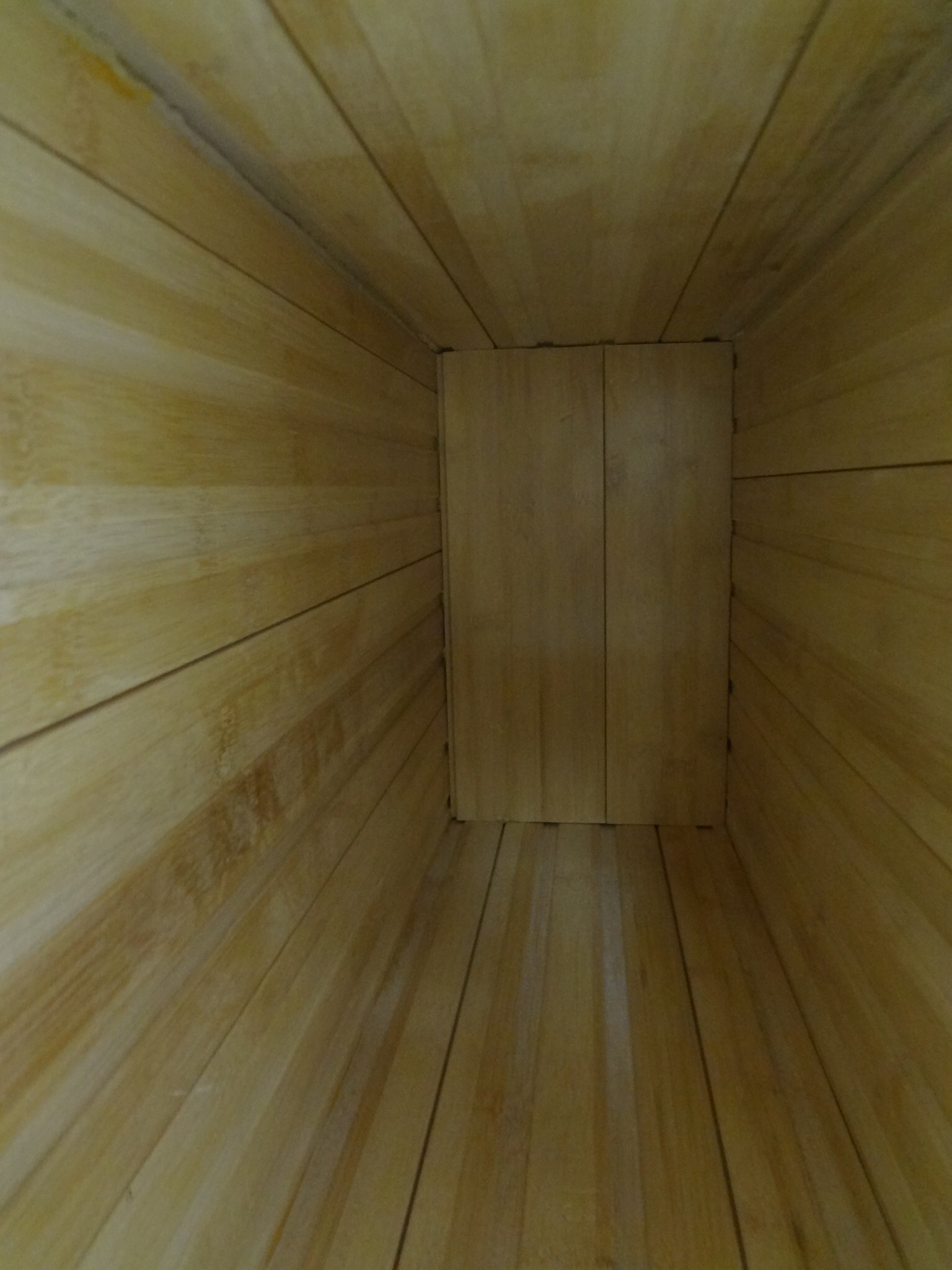

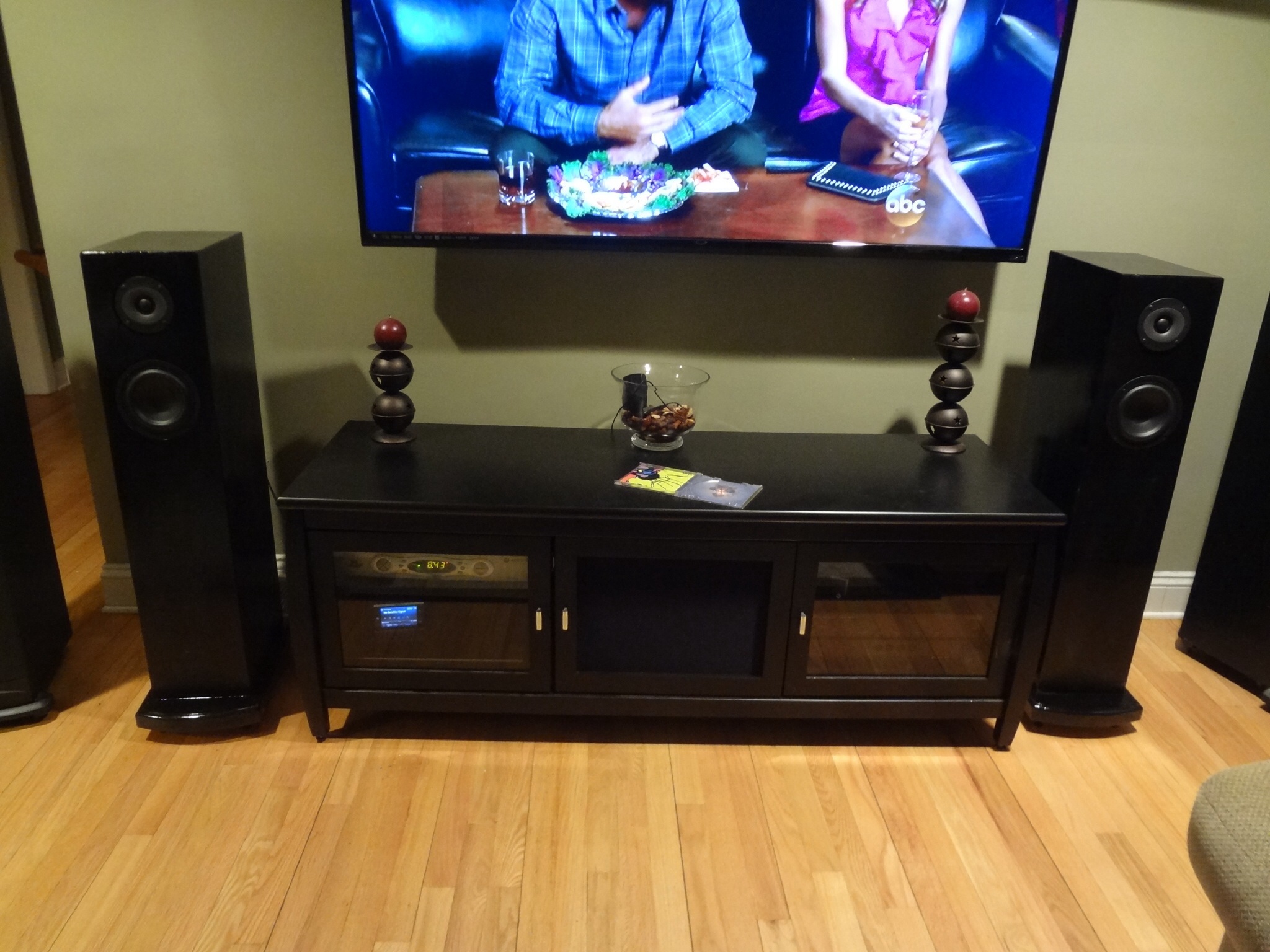

This is my first post on here (or any fur on for that matter) I'm new to speaker building, a friend of mine upgraded his Ascend Seirra-1s and had the old crossovers and speakers that he gave to me for free!
I could not find bamboo sheets so I found flooring at Lowes on Clearance for$25 bucks. I glued them together to make panels and built these towers with them. I am amazed by the sound quality, I have about $49 into these speakers and they sound better than my old Infinity Reference 2006s.
I've included a few pics. I could have done better On the finish but think they will look better in another 20 days when the Lacquer cures and I can rub them out and was them.
I really enjoyed this project and am looking forward to building more. Sub woofer is next.

Hey/ Hi Tom
the argument was most about bamboo/cylindrical structure rather than finishing
so it's ok BTW Those speakers& crossovers were a good score but why are you thinking of a sub when you've already used much volume in those boxes ? Maybe they're overdamped or something...and it means bad (bass) alignement .

Thanks for the response.
Sorry about that, just learning how the forum works, didn't realize I hi-jacked another thread.
I built basically bookshelf speakers with the stands "built in". I separated the top 14" from the bottom with 1.25" bamboo divider (see pic) so there isn't as much volume as it appears. Don't get me wrong, they sound great and have decent bass (I was actually surprised how much bass).
I'm thinking of building a sub just because I enjoyed this project so much, and I don't think it would hurt adding a dedicated sub. They are in a large room (17x28).
