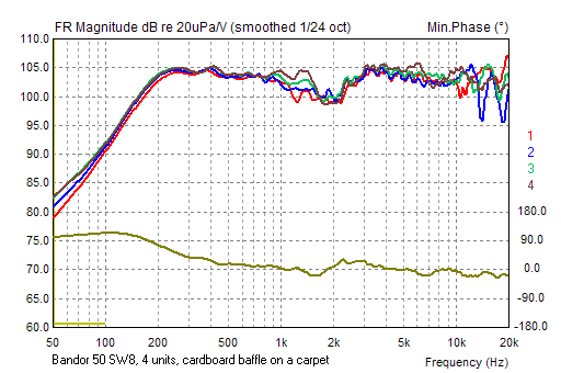

For those interested in a smoother Jordan JXR6HD modules. Here is a measurement of four Bandor 50 modules, single copper wound, eight ohms, low inductance. MLS stimulus, less than 1W, 6mm electret mic, relative dB values, cardboard as a baffle, 45 deg to the carpet.

Depression has two causes:
1) Very delicate suspension that result in "rim resonance".
2) Energy reflected through the cone from the carpet.
This means that one have to be careful with stored energy in the cabinet. Doreen called me one hour ago and she can straighten FR response but she feels it isn't necessary. You can get a better midrange from aluminium coil.
There are of course very high Q resonances above 10K but they are -25dB down. For evaluation I need better measurement.

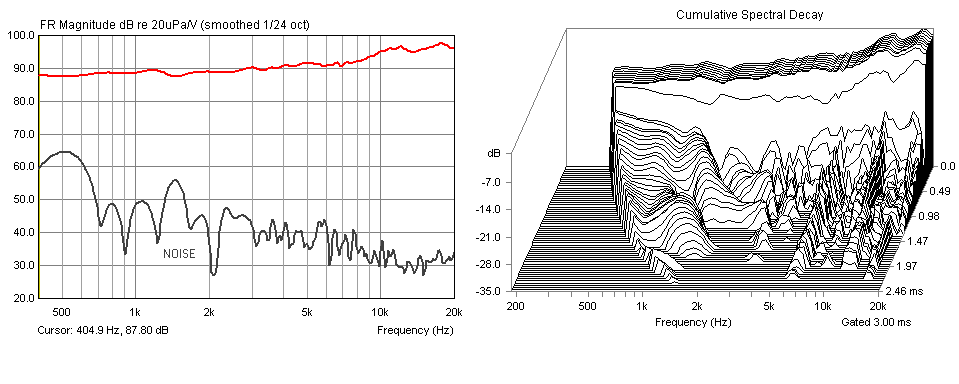

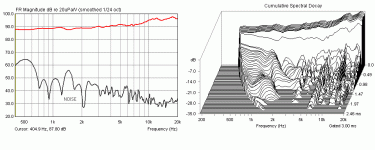

I wish in this thread we compare 1000 times lighter membrane. My recent ribbon (appended picture) speaker is quite good however we have larger Q diffraction and worst transformer. In this week I'll get amorphous C core from AMS Irleand. A lot of parameters needs to be adjusted then. Ribbon also need a screen damping like in microphones.
I also made Jordan JXR6HD measurement in the same setup but response was bad so at the moment won't show anything
(I think better baffle is needed).
