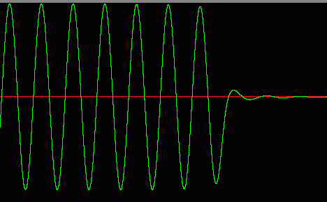

This is a picture of a 50Hz tone burst with 24dB per octave LPF starting at 50Hz. The transient response is indeed degraded.Ron E said:4th order BP boxes *snip* Their transient response is no worse than a sealed box with similar rolloff characteristics and a lowpass filter at the high frequency rolloff point.
So, would it be right to conclude that a closed box speaker has a better transient response mainly because the cone is still exposed therefore it has a more extended frequency response than a system that has all the sound coming from the port(s)?
Perhaps an example would be more illustrative.
Say you have a 4th order bandpass with a -3dB bandwidth of 40-100Hz. You also have a sealed box with F3=40Hz and Qtc-0.707.
Say that you have designed the BP box so that its LF rolloff behavior is essentially the same as the sealed box.
Now take that 40Hz sealed box and filter it with a 2nd order lowpass filter at 100Hz. When you compare tone bursts, step response, or what have you, the two systems will be essentially equivalent.
When comparing transient response, you must be aware of the bandwidth of the device. It is not a fair comparison to compare a sealed box with no LP filter to a 4th order bandpass box. The sealed box will always look better, even though it is not. This is not to say that 4th Order bandpass boxes cannot be misaligned or that they always have similar transient response to sealed boxes, because you can trade off box size for ripple in the BP box and the more ripple, the worse the transient response gets....
